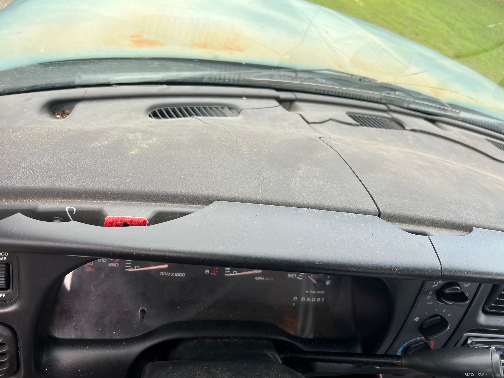

Thru my own experience (and evidenced by another guy, pic attached) dash components can be removed individually so hopefully you can access and fix the vac leak with one or more removed and not having to deal with the dash as a whole. Good luck.
