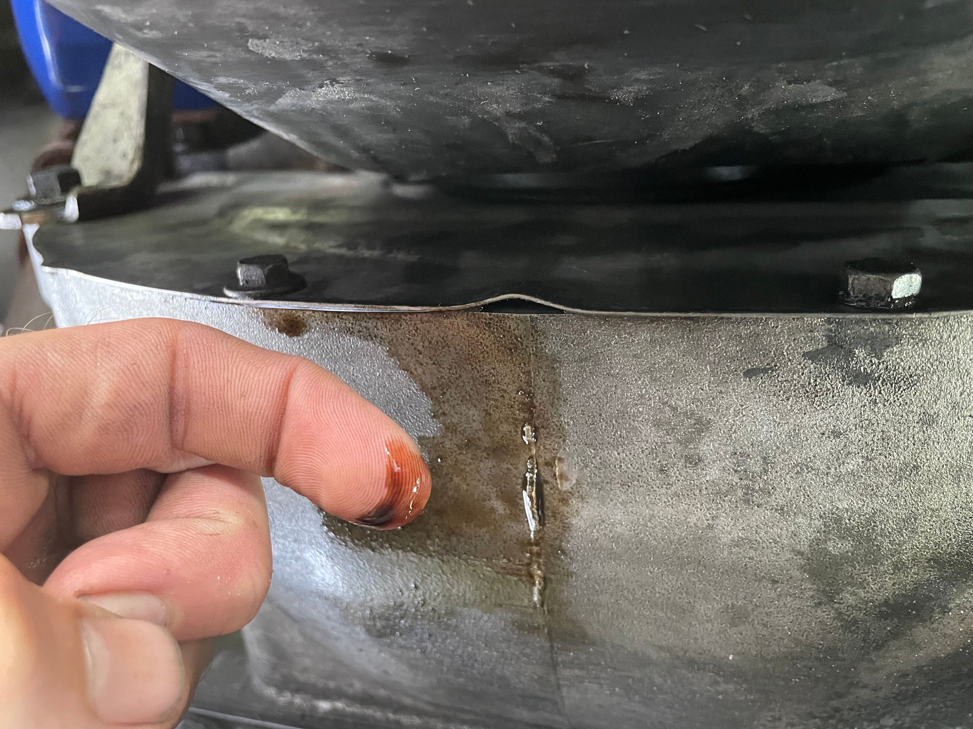

Ok, so backstory. I have a 98 Ram 1500 with the 5.9. My oil pressure was all over the place and I suspected the screen was clogged. I replaced the rear main seal, oil pump and pickup tube, and pan gasket. Truck fires up and drives as usual. Not leaking any ***new oil***
1. However, I am still getting odd pressure readings ie below 40psi at 60 mph and ~1.5-2k rpm. The needle just randomly drops, hangs out for a little bit, then recovers. Pressure switch was replaced 1 month ago. Normal for me is 40psi at idle and ~55-60 psi in operation. I assume it still falls within the acceptable range but is this normal?
2. After test driving for a while, I crawled under and noticed old oil near the bottom center of the inspection plate on the bell housing. I cannot pinpoint the origin. Note that this is old oil. I hypothesize this could be oil that entered the bell housing when I pulled the pan and now it’s leaking out through the notch in the inspection plate. Or, the rear main seal didn’t seat correctly, though I was very meticulous with this- seal is oriented correctly and offset on the block and cap so the seams aren’t aligned. Please see photos below. Just curious everyone’s thoughts.

The oil leak you see could be coming from the back of the valley and tracking down the back of the block.
Reach over the back of the block behind the intake manifold and feel if it’s wet.
Back of the block is dry. I did the Hughes plenum fix back in June. What stumps me is the inspection plate is dry and the oil pan is dry. So leak appears to be coming from inside the bell housing through the raised notch bottom center on the inspection plate
Did you loosen the caps(to lower the crank) or do it in place? You may want to remove the plate and get a better look at where it may be coming from.
