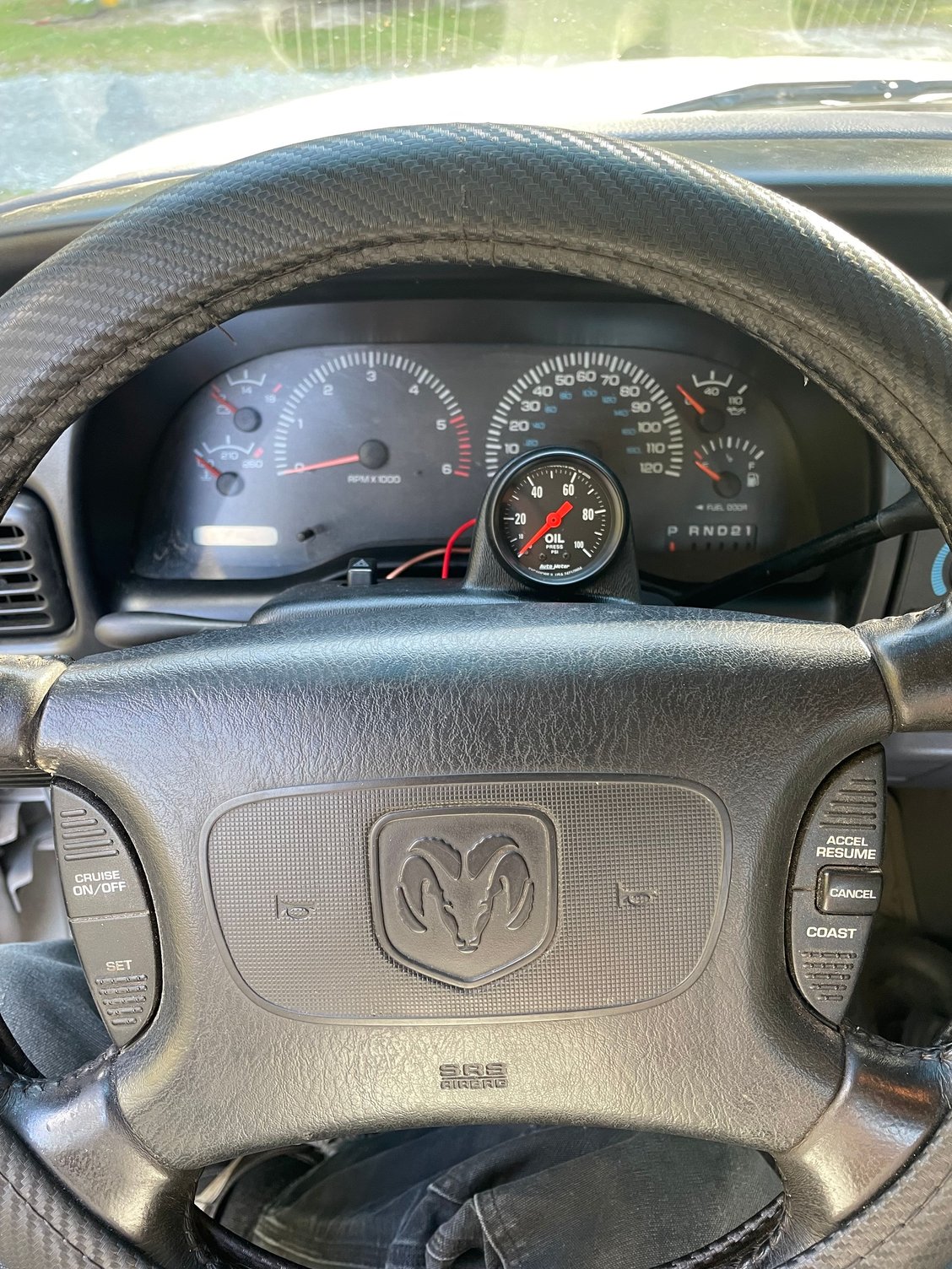

Not as clean as I would’ve liked- the exposed tubing and wires bother me but it’ll ride. Thanks for all the help on this!

I'm sure you can still get a-pillar pods for 2nd Gens if you want to relocate it. Plenty of Cummins guys run 'em for various gauges

I gave it a thought- kinda wish I had gone with it. The steering column mount is great for nylon tube applications. Installing it with copper was a pain

Copper may be slightly more difficult to install, however, I prefer copper over the nylon line. I've seen them burst over time due to heat cycles and pressure. Another option is a small diameter braided line, however, more expensive...
