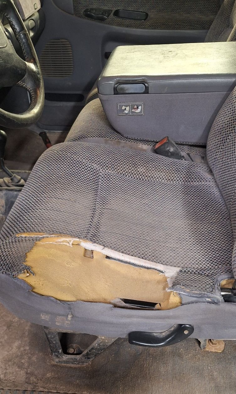

Hello! I have recently acquired a 2000 Dodge 2500 work truck, standard cab, 360 engine. My driver's seat bottom cushion is done, both foam and cover, and it hurts my back to drive the truck. In my research, I have found that seat cushions are different between my regular cab and any other cab, and mine are apparently much harder to find. I have checked inventory junkyards around me, and I see no trucks that would have the same seat.
Is there any alternate seat cushion that will fit a 98-2002 Dodge regular cab truck? Will an earlier cushion fit? Can the quad cab cushion be made to fit? If not, can any other seats be fitted in the truck? I like my 40/20/40 bench a lot, but if the solution to back pain is Grand Caravan buckets, so be it. I cannot care less what it looks like, so long as it solves the back pain.

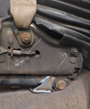

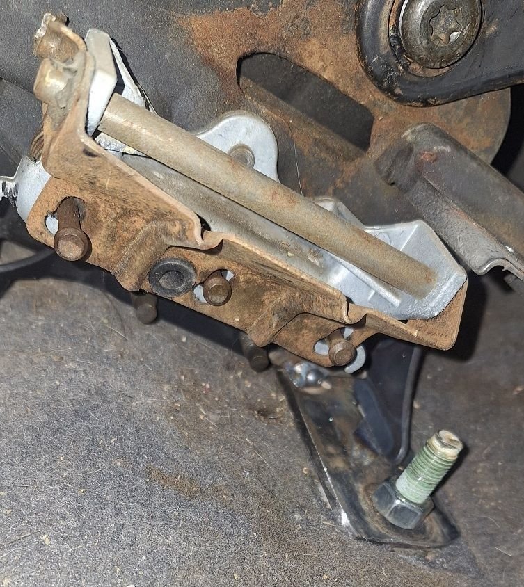

Quoting myself, I finally tackled this on a '98 regular cab. It was just a pet project that I insisted on pursuing so aftermarket cushions could be used.
I like a challenge and am not afraid of fabrication but this was a PITA. I would not recommend this approach, but now that it's finished I'm glad I was stubborn.
BEFORE: regular cab seat. The cushion is South Park Trapper Keeper level integrated with the frame
New inner rear bracket
I failed to get shots of the extra cab seat before cutting it a dozen times. You need to take ~4
I failed to get shots of the extra cab seat before cutting it a dozen times. You need to take ~4" of height out of the rear mount area. This puts your cuts on the ragged edge of the seat tracks. New outer bracket partially shown here
This is what makes the extra cab seats easy: the lower cushion simply unbolts and can be lifted out
AFTER. Heavily modified extra cab frame in a regular cab. I could only find a tan used seat after years of searching. New Dorman bottom cushion
AFTER. Heavily modified extra cab seat frame in a regular cab. I could only find a tan used seat after years of searching. New Dorman bottom cushion
