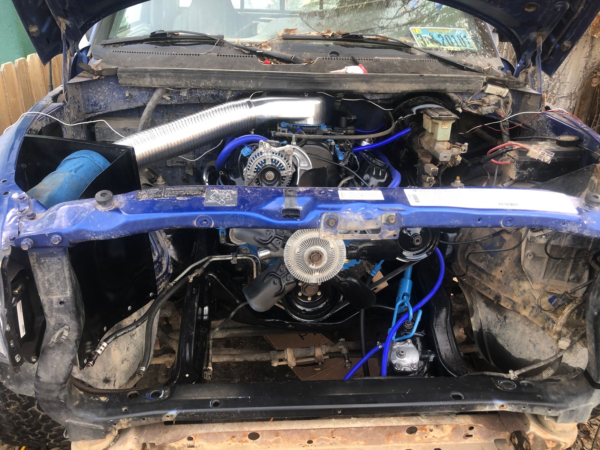

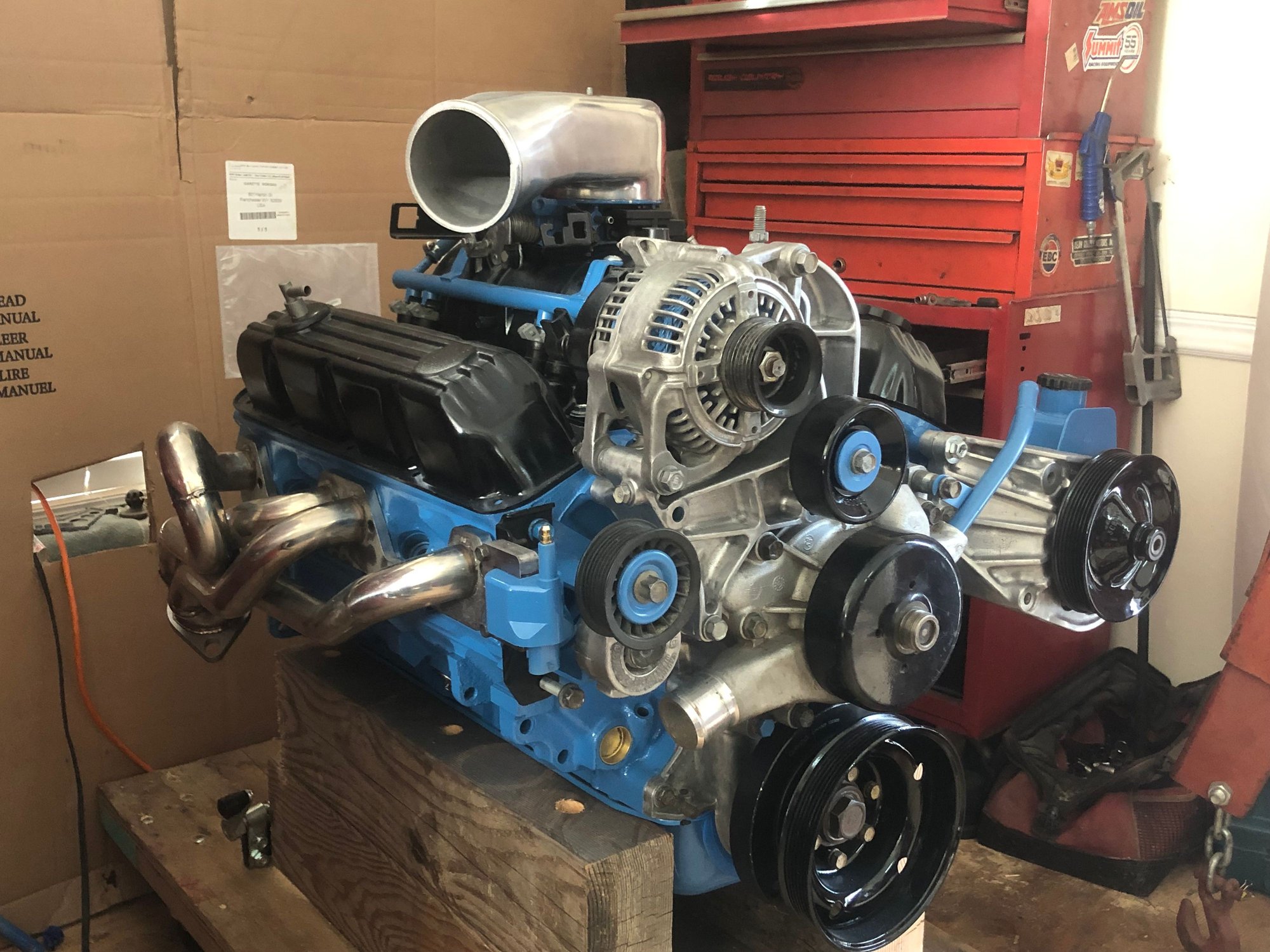

Hey guys new to the forums. So I grew up in a transmission shop. Turing wrenches for a while. I teach the boys (8-17 years old) the basics in mechanics. So my Dodge was puffing white smoke so it was my turn for a big overhaul. Picked my 5.2 out of my truck and took it my living room! Yes wife not happy at first but after while it was ok . 2 years later (a month ago) she went back in! Now she crank pops blops blop no start. I’m not Shure where to post everything I’ve done and diagnosed and get some advice?
Was almost done
Dropped in day

Very nice paint work and detailing on your engine.

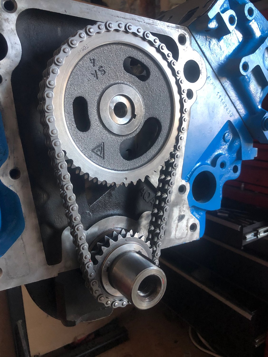

Yea I know the timing chain it I did it twice cuz I switched to a dubble roller chain set and the cam plate under the distributor cap are new was told with this motor only mopar sensors work the best…

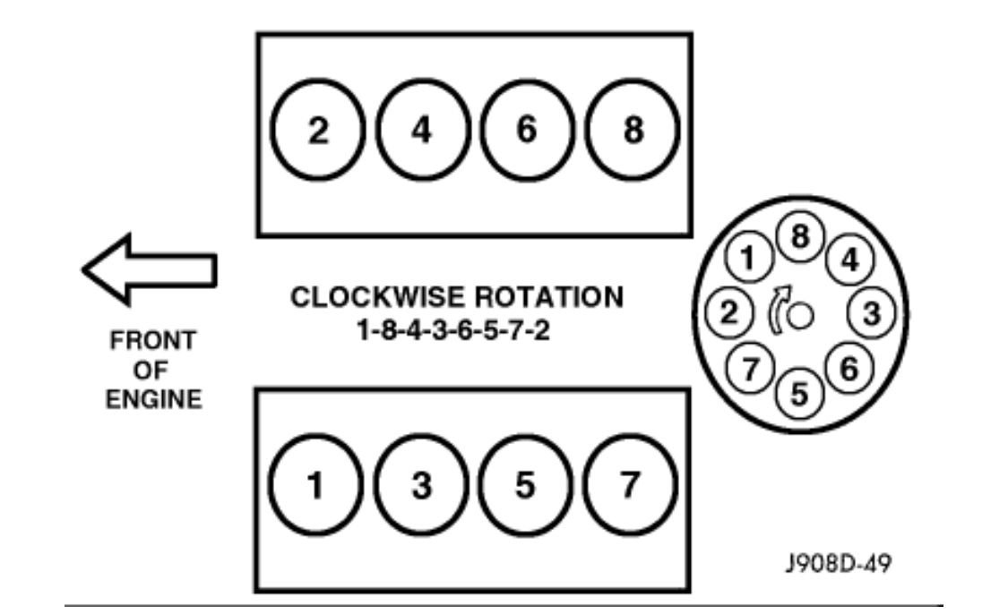

I pulled the distributor before I put it in the truck so when I put it back in I put the motor at DTC reset the oil pick up tube just to make Shure that when I drop the distributor it would be close .. got the rotor facing cylinder #1 and put new cap and rotor of corse

This is what I did the wiring order from

Put #1 cylinder on TDC ON THE COMPRESSION STROKE then position the distributor like shown.

Ok that’s where I messed up I have the rotor facing cylinder #1 not the mark on the cam position plate
