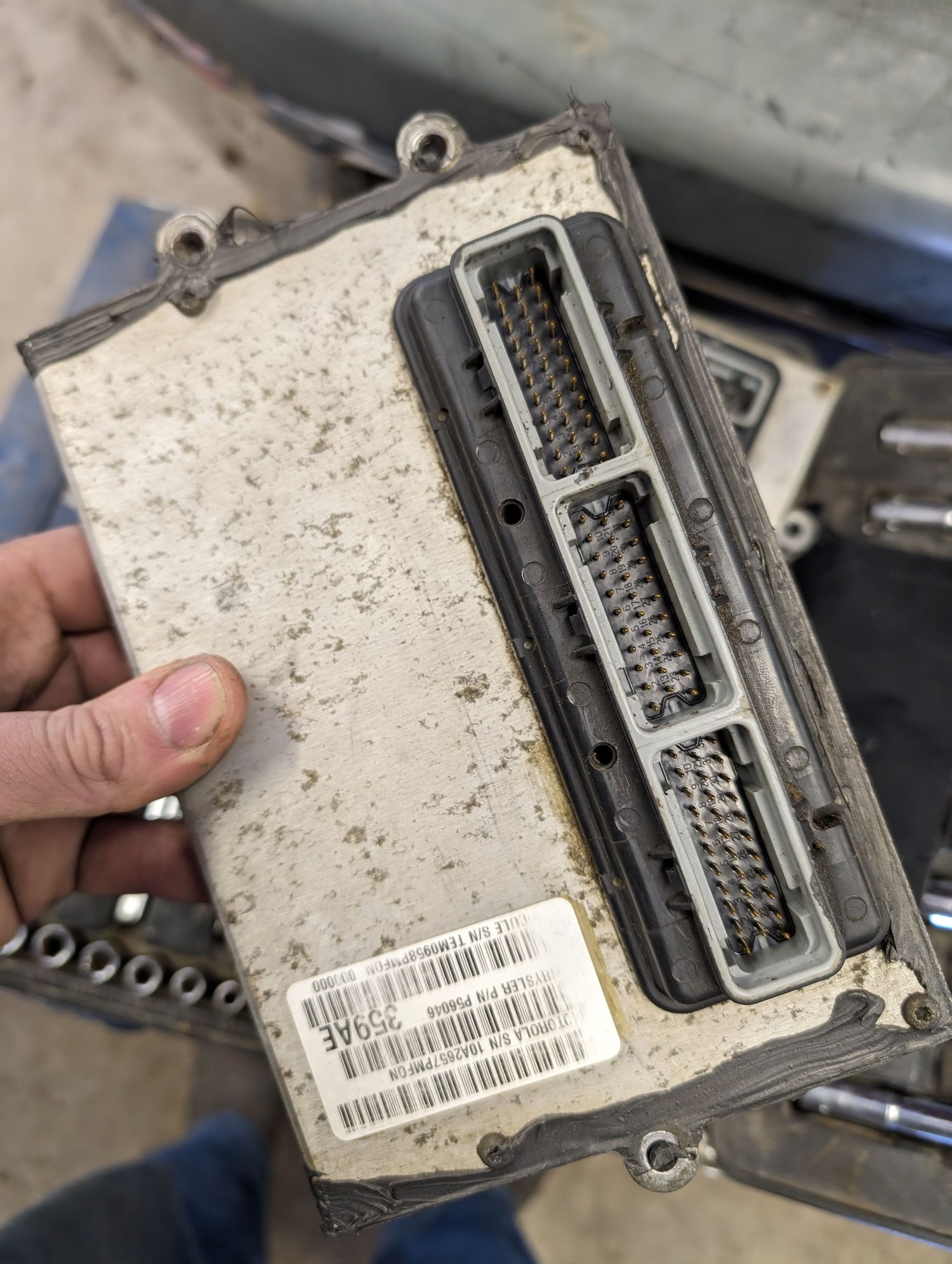

So I think someones opened up this PCM before - attached pictures.
Anyway - I put the new-used PCM in and got the same result. Back to the original "No 5v on MAP" code. The other two didn't pop up - and unlike in the past the truck didn't even TRY to fire.
I did some poking around and did, once again find 5v on the signal wires for the MAP, Crank and Cam sensors... I clipped the splice I had made before right next to the PCM connector and found 5V there. Then I decided I would take apart the connector itself to see if there was something going on inside that to cause any 5v shorts - and everything looked perfect.
I brought the new-old PCM inside. Hoping I can reference some electrical schematics and see if I can poke around with some continuity tests or something to see if I can identify a problem in the PCM? There's got to be a short in there, right? I mean - the guy that I got the PCM from told me the truck ran fine. There was a lot of parts gone when I got to it so I didn't get to see it myself when I pulled the PCM... Maybe he meant that it ran fine until it didnt HAHA Is this 5V short in these PCM's a common issue? Otherwise it kind of seems weird if both of these have the same problem....
