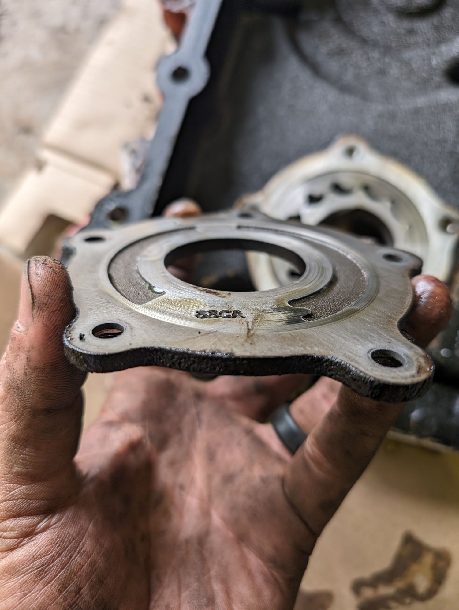

Alrighty so got the truck fully tore apart and back together again.... She's waiting for RTV to set up overnight before I fill the coolant and oil back up to fire her up...
Took a lot of pictures and wrote down a lot of things so I could do a writeup of sorts if anyone's interested? Feel like everyone in this thread has done this job before though 😂
The oil actually came out as OIL this time. 😂 I think I've managed to clean a bit more gunk out of the system as the beginning it seemed to come out almost black and towards the end it looked a lot more fresh...? Maybe getting more sludge/sediment out of there...?

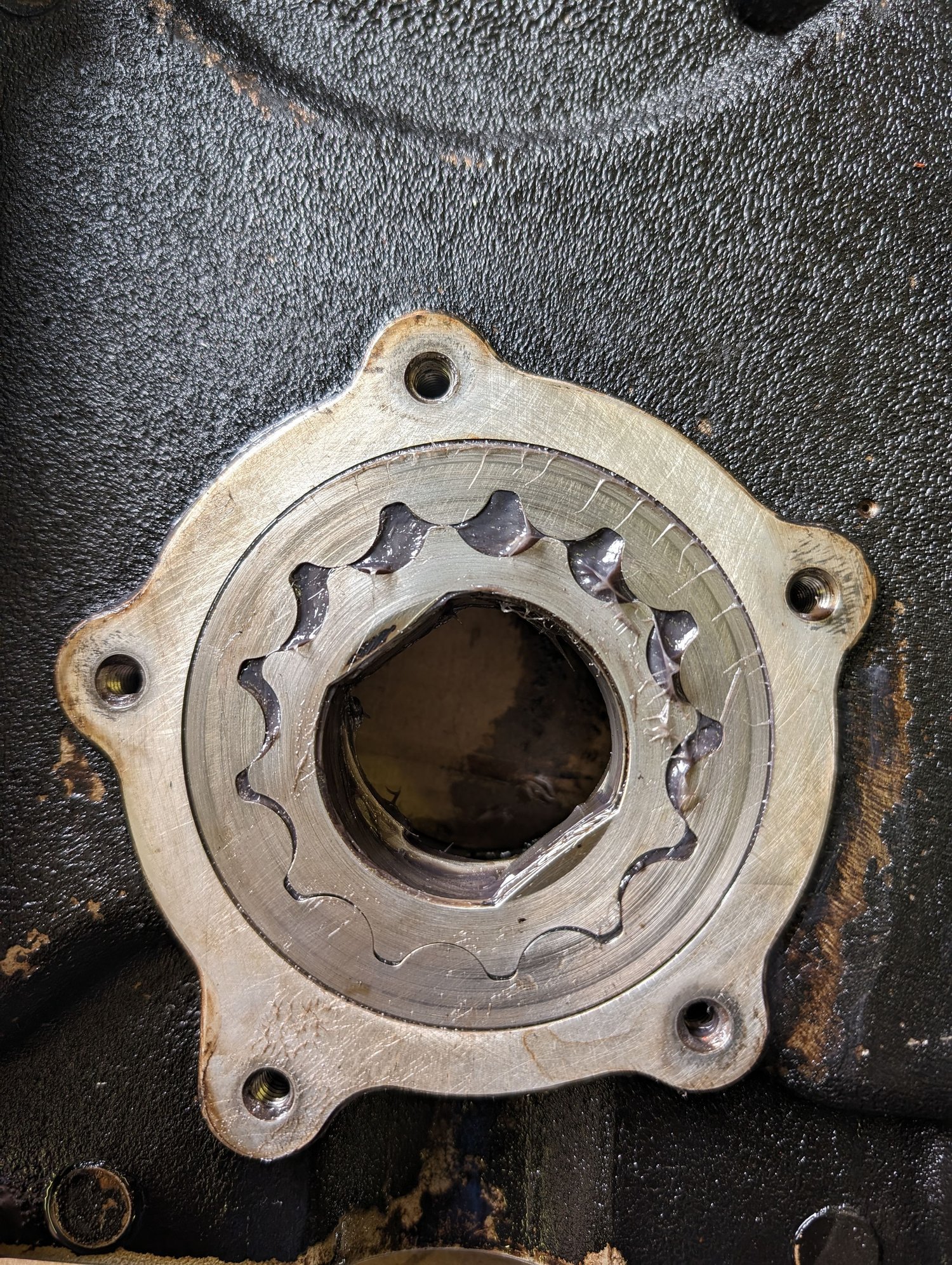

Anyway - oil pump cover - NOT the issue. All screws were VERY tight when I got it removed. Like I was afraid I'd bend the torx bit removing them, tight.
I removed them to check if the case had been worn/damaged and everything looked fine.... For the most part...
Could see a very slight amount of damage to the case...
Packed the rotor with lithium grease - made with I had the rotor in the exact position it needed to be in for reinstall beforehand.
​​​Torqued the screws back to spec (125in/lbs - from what I could find...?) and peened the heads.
Thought about scraping off the whole inside of the cover but decided against it because....

Now what's concerning is the pump definitely doesn't seem like that was the issue... While I had the pan dropped I checked the torque of the pickup and was able to give it a little more but still... I'm worried there's something else going on...

Clearance the rotors?
No- I didn't check. I'll be getting in there again for the timing chain.
