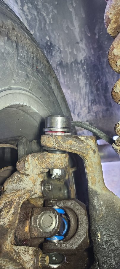

So i finally got around to replacing the universal joint on the passenger side along with new hub and upper and lower ball joints, I still have the same horrible knocking sound when it goes into 4x4 and a turn on the wheel, any other ideas,
I now have a secound problem when I put in the ball joints top no problem and bottom no problem when I tighten up the bottom nut on the ball joint it pushes the upper ball joint up so its not seated, im not sure if the ball joint is too big for the knuckle and the knuckle is pushing up the ball joint.. so now i have a gap on the top ball joint, not sure if i can get away with that ? Hate to redo everyhing or is it a problem with the ball joint, it seemed like a fit.

Really shouldn't be doing that...... is it the correct ball joint? How does it compare to the one you removed??
Can you duplicate the noise with the truck up on jack stands???

He was H tHat wit Was like tThey looked close to tue same, slight different design, but itwas like that with the other side laid a fewbyears ago. I did ggoof up and put the top joint in first and have to take it out in order to get the lower in first. I also used a little grease to press it in, did I wreck the upper joint
The doubd onky comesvin 4x4 when its moving .

They looked about the same, slight different design, but it was like that with the other side l did a few years ago, the video i watched showed the same thing new ball joint slight change in particular the rubber boot, i had to remove to install the lower one then re install. . I did goof up and put the top joint in first and have to take it out in order to get the lower in first. I also used a little grease to press it in, did I wreck the upper joint or was grease a bad idea and makes it pop out to easy? Should the knicke be able to slide right up to the to the top without of whete the ball joint goes in or should the pin in the joint get fat enough it prevents it from sliding all the way up?
for the noise in 4x4
it only comes in 4x4 when its moving particularly on turns.

You aren't using 4x4 on a high traction surface are you???
As for the ball joint...... I really don't think it should sit like that..... why it does though, that's a mystery. It isn't gonna come out though. Don't think that's possible. (unless something else breaks....)
How do the u-joints in the front driveshaft look? I know on my 96, the joints at the CV joint by the t-case were pretty dry and noisy..... that went away when I had the shaft rebuilt.
