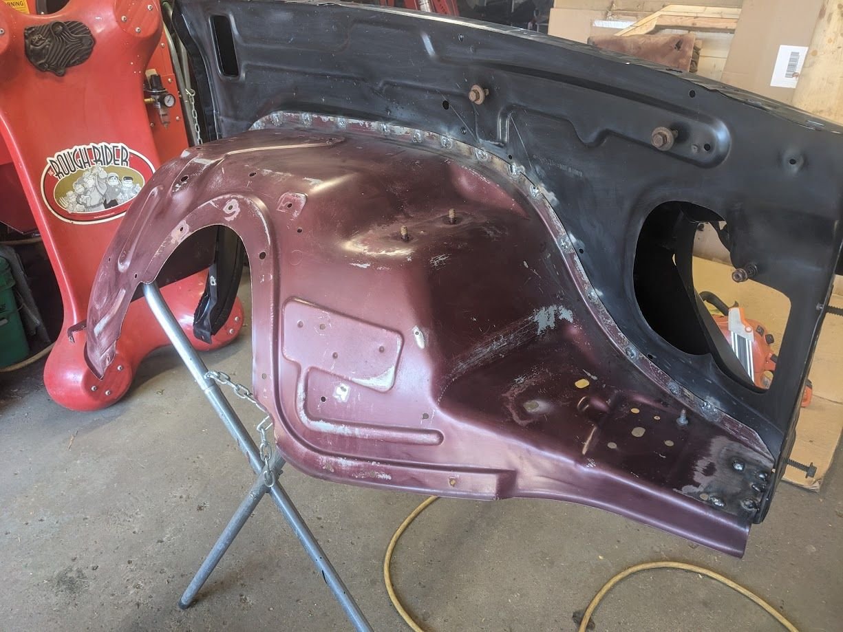

Now that winter is passed I'm back to making some progress on the truck again.
I've got the driver fender off at the moment. Old inner is all cleaned up and welded to the new outer. Both are in epoxy.

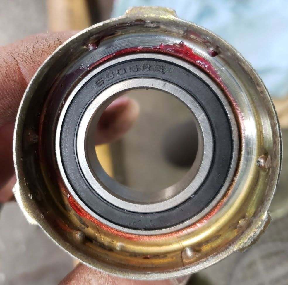

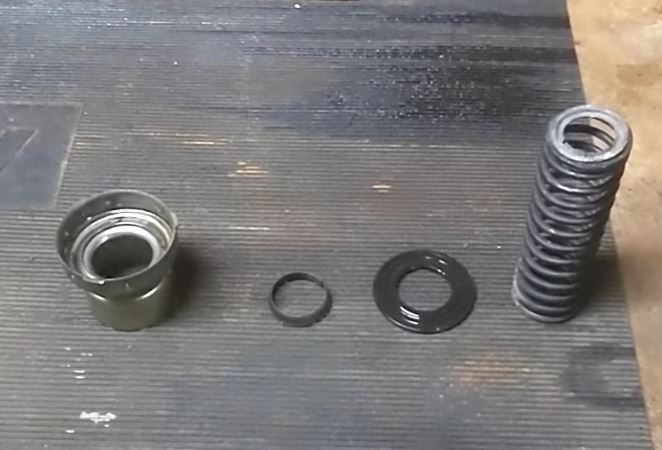

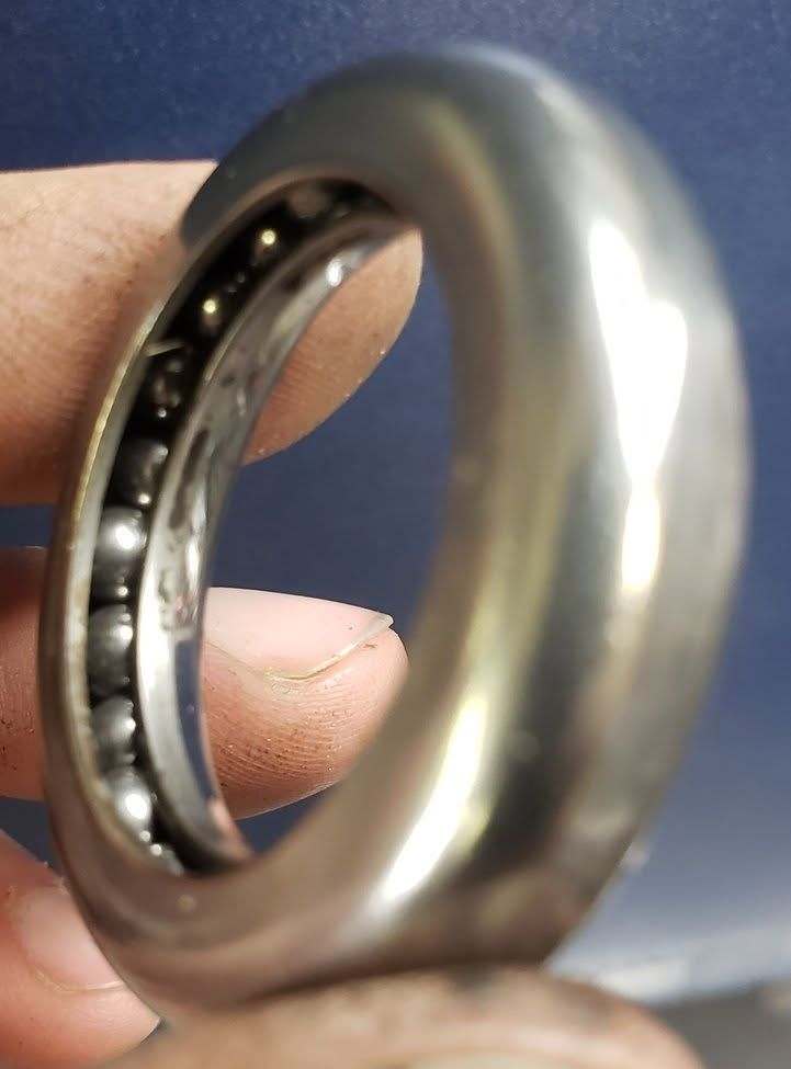

To start off, let's look at the lower steering column bearing. I have the assembly apart here, and apparently these are a common issue. The spring rides on the steering shaft against a little metal retaining clip, providing preload to the centering ring against the bushing to center to the shaft. I found it odd that the retaining clip didn't have a groove in the shaft, meaning it's not only just held on by it's own deformation pressure, but also there's no standard depth of installation. So I suspect that a lot of guys who've had steering slop issues in this area (the reason the rock solid ram steering thing exists) is because that retaining clip wasn't installed tight enough, or backed off slightly over time causing the spring to lose pressure.
My upgrade solution here, thanks for fellow forum member Keith_L is to install a full groove bearing in place of the ring bearing used in the stock setup. https://dodgeforum.com/forum/2nd-gen...n-bushing.html
I like this solution much better than the rock solid ram bushing, and it's substantially cheaper.
The proper bearing is 25mmx42mmx9mm. I found a high quality Japanese made NSK bearing in that dimension on ebay for under $15 shipped. Part number 6905DDU.
Image below and above courtesy of Keith:

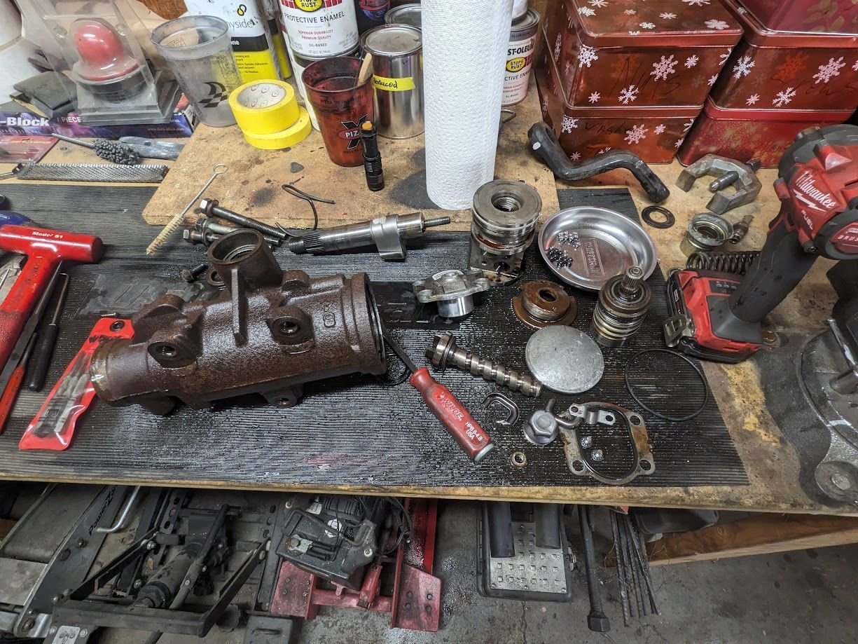

I've got it all apart now and inspected. Disassembly was a bit of a pain, in particular the large lock ring in the big end, it was rusted in place pretty good. I also didn't have the proper tool to back off the adjuster in the small end, and snapped my cheapo needle nose trying to break it free, but got the job done with a hammer and punch. Probably need to order the right tool for re-assembly though. Very messy job this.
Fortunately it all looks pretty good inside. I don't see any excessive wear on the gear teeth or the *****. I'm going to install a new pitman arm shaft bearing, as it's got a little play it in, but otherwise things look good.
I didn't suspect this to be worn out given the truck still steers pretty good, but new seals and a paint job are in order. Also, I made some adjustments to the preload a few years ago trying to eliminate the slight bit of on center slop. I did it in the truck which the service manual says not to do, and didn't get it quite right, so it was a little twitchy on center after that. Having it out gives me the ability to do both adjustments properly on the bench. Should be good to go.

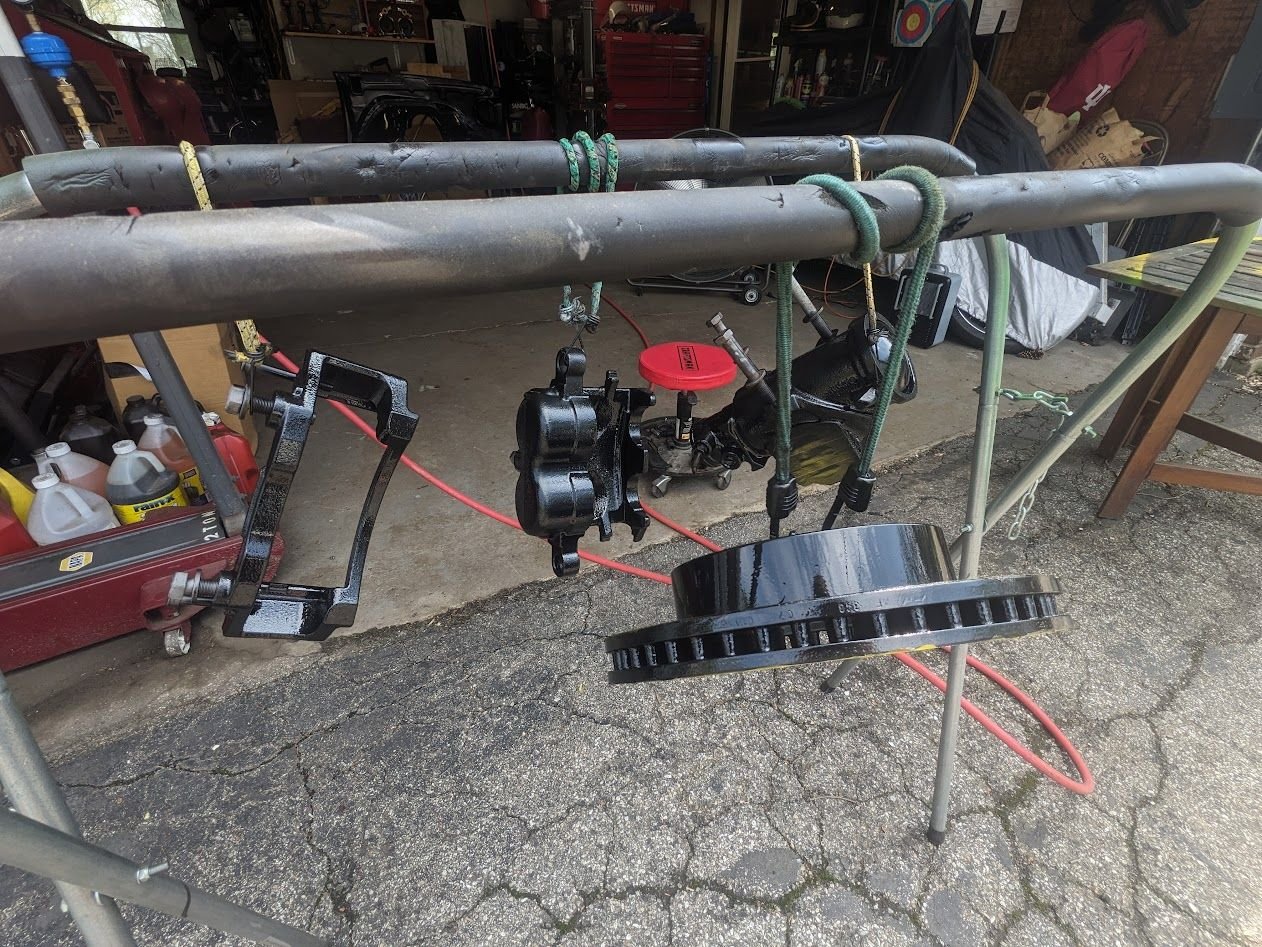

Quick update, steering gear all back together now, ready to be adjusted and installed.
Also cleaned up and painted the drivers side brake components.

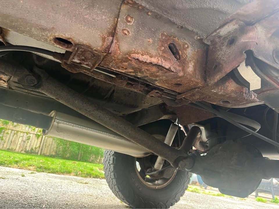

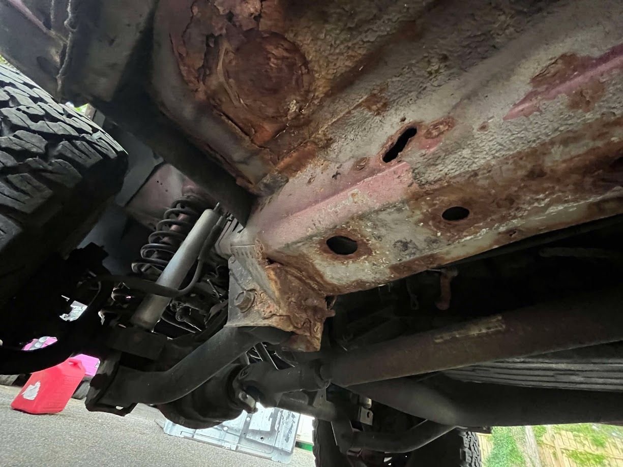

Chipping away at it some more. Got the driver side of the front axle and things cleaned up and primed. I also drilled some drain holes in the coil bucket since the other side rotted out so badly. Too bad I didn't have a before photo because they were crusty. Basically my proceedure with this stuff is as follows:
1. Air chisel any chunks or scale
2. Use an angle grinder with a knotted cup brush to hit everything you can see
3. Use a handheld wire brush on whatever you can't get with the grinder
4. Pressure wash (to remove any grease, I use lanolin undercoatings so this stuff is everywhere)
5. Apply phosphoric acid rust converter
6. Wash again
7. Prime
8. Paint
Old Apr 24, 2025 | 11:46 AM
  #117
Skeptic68W's Avatar
Skeptic68W
Joined: Jun 2014
Posts: 412
Likes: 26
I noticed while doing the above that there are some channels in the upper shock mount that were rotting. Turns out only one side has a drain (which was plugged up anyway). So I made a drain for the other side and cleared both out well. I'll treat and paint in there as well.
From the shape of the mount I thought perhaps there was a hole in the frame that let it drain into the frame itself, but it appears not.
