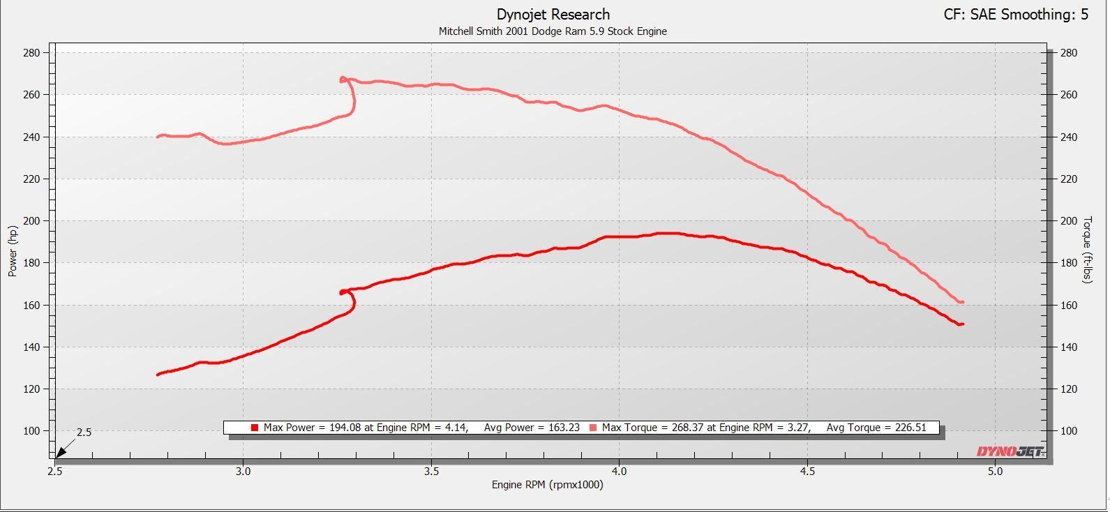

Well we had some fun today boys. First time I've ever run anything on the dyno.
For reference again, this is a stock 5.9 with 180,000 miles on it. The heads were off and redone (just stock rebuild, new valve job) about 5 years ago. Intake manifold runners were cut down about 2 inches, though I don't expect that made any difference.
The purpose of this dyno day was to establish a stock baseline, not tune it, so we made no adjustments to the spark, though it was kinda lean so we did add a little fuel. I figured it would make 180 at the tire. Here are the results.
The first graph here is actually the third run. We were playing with the TCC lockup in hp tuners because as you'll see in the other runs, it was acting a little strange. By the third run we had added fuel twice (12% more total), so this isn't the best power figure of the 3, but it is the cleanest since we got the TCC right.
187hp/247tq. More or less what you'd expect.
The next graph is the first run, nothing changed from the stock calibration, and you can see at about 3200rpm it has a woopiedo from the torque converter clutch lockup.
As you can see, in stock form, it made 194hp/268tq. Not terrible for what it is.
Finally, here is the second run. We put 7% more fuel in it up top and it picked up a few numbers above 4200, but it didn't change the peak.
I'll put up the dyno videos up as soon as the old man gets them sent my way.
If we take the best run and plug it into a conversion calculator. The puts us at 258 at the crank. Not bad.

Interesting curves there. I would have expect a bit more down in the lower end..... but, it is what it is. What are they rated for stock from the factory??
245 crank hp is the rating
What do you find interesting about the curves? They're essentially exactly what I expected. Unless you're referring to the TCC loops on 2 of the 3.

The loops are puzzling..... But, Its the lack of torque on the low end I find strange. These are supposed to be TRUCK motors..... I would expect the curve to be steeper, and start lower..... Your graphs don't even begin until north of 2500 RPM..... But, I would guess that the dyno just isn't accurate below 2500.....
Suppose it's an illustration of why we have torque converters.
​​​​​​The loops are the TCC clutch applying or releasing in an inopportune fashion, the green run doesn't have them after we figured out how to prevent it.
We actually started the pulls all the way down at 2 grand, so I'm not sure why it only starts graphing at 2700. I'm not that surprised by the shape. If you think about it, most dyno charts you see start at 3000-3500, so if you lopped off the sections of my runs before that it would look just as you describe, highest at the start and an immediate decline in torque.
I mean the starting torque number is probably only 10-15 below the peak number. 🤷 Seems like a good truck design to me.
