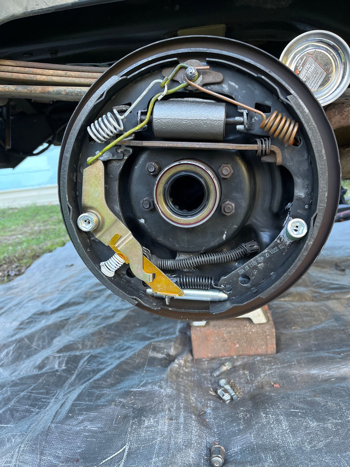

Well….its been a little bit but…
Broke my d*ck doin this outside but i got it done 😁 did both sides while i was at it

New shoes and hardware? Not a bad idea.

Yes sir, new everything pretty much except the axle shaft, im waiting on the wheel studs. And filling it with fluids in the morning.
