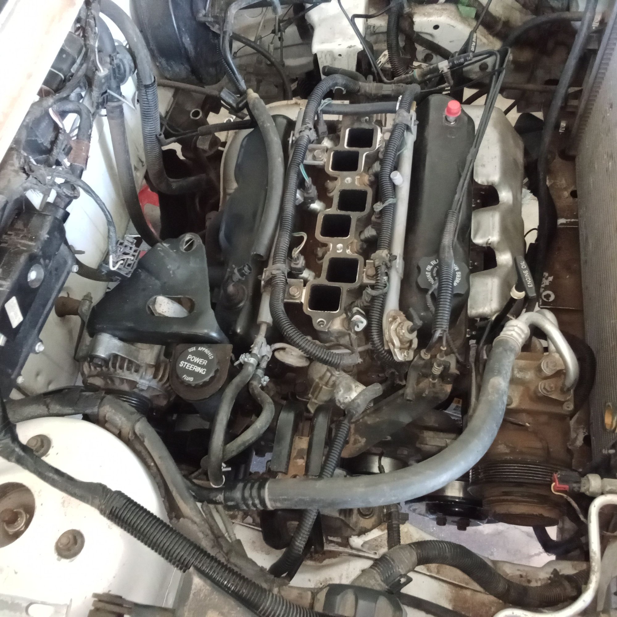

@nathan3674 I just replaced the plenum ..... Now I'm curious.
Why did you replace the plenum and did it use oil like this before replacing the plenum?
Just to be sure we are talking about the same things ..... the plenum is pretty much non consequential .... May get a vacuum leak but not affect oil consumption.
V6 with just plenum removed.
V6 with plenum and intake removed.
if you removed plenum and intake and then got a bad gasket installing them, ..... that could be your initial complaint.
For example when you are cruising and let off of the gas and the engine vacuum is at it's highest .... you could be sucking oil and or coolant into the intake passages and burning them.
All 3 meet right here and is crucial you have good gaskets and sealing here. .... Blue smoke is oil, white smoke is coolant ..... black smoke is telling you it is not happy.
I believe your original issue is "When turning off cruise control while going 65 and engine starts slowing down, lots of blue smoke out the exhaust. 2. At 65 mph it’s running 2600 rpm 3. When in park and revved lots of white, blue, and black it’s varies from time to time"

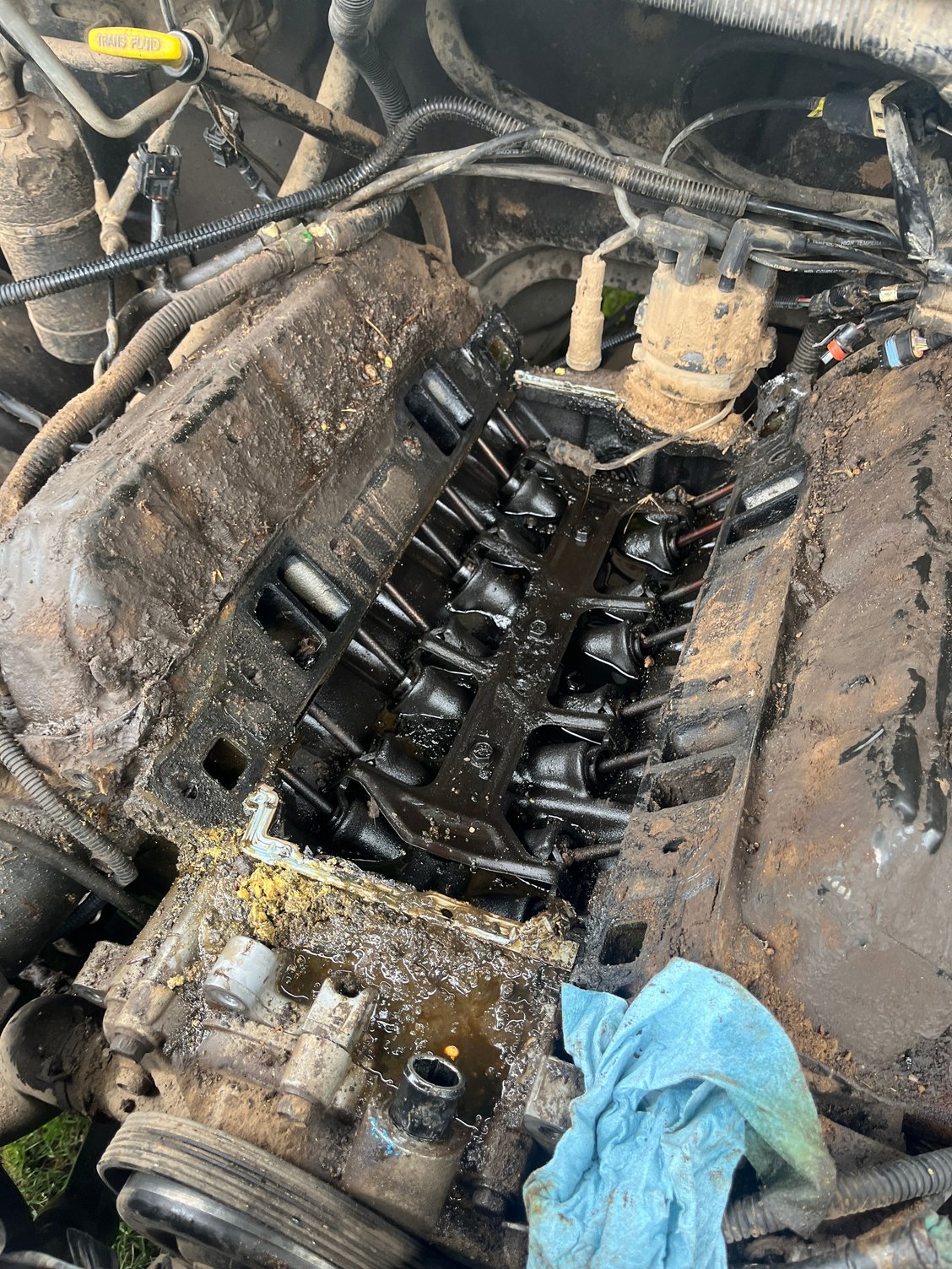

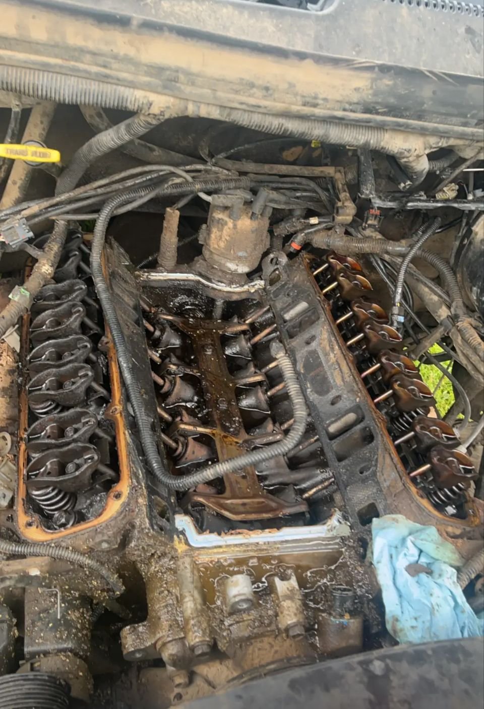

But I wont. ..... I'm trying to look at the gasket surface and see where it might leak to cause your issue. ..... On the passenger side near the rear it is wet and maybe was your issue.
The bigger issue is all the filth on the engine. If you bump that distributor cap a shovel full of dirt will drop into the engine .... we can see evidence of where it has already.
The gasket surface is incredibly dirty ..... In order to get it spotless for a new gasket to seal ... all that crud is going into the engine ..... it will be a terrible painstaking process to get all the crud out of that engine and clean gasket surface to make the new gaskets seal.
Very first thing that should have been done is pressure wash and clean that engine before you opened it up .... now it is too late.
I honestly can not remember the last time I saw such a filthy engine and it still runs. ..... you get bonus points for that.
I'm not a Debbie downer or something ..... That engine has been rode hard and never saw any maintenance .... be happy you got 200K+ miles from it.
You say it actually runs now? .... go grab another engine while the truck still runs .....
There is a lot of natural sludge in the engine to be expected. But introducing all the extra dirt into it .... it is in the oil and going through all the bearings .... that engine will not run long.
It reminds me of a DR opening up a stage 3 cancer patient and wants to do some work .... Once opened they realize it is a stage 5 cancer and they just close the patient back up because they are beyond their help. Nothing they can do to fix it. IMHO thats your engine right now. .... I would concentrate on replacing the engine.
I would not try to repair this engine after seeing the photos .... others may disagree and thats fine .....
The obvious lack of maintenance, the fact it survived 200K+ miles ..... praise it and put it to bed.

lmao I cleaned it it’s beautiful now, but I diddnt pay anything for this pickup but yes it’s been a farm truck and they never changed the oil I’ve also cleaned out the oil pan and entire crankcase it was horable

I still think you have a leak of some sorts that is allowing oil and coolant to get sucked into the intake ports and burned ..... maybe it is a cracked manifold?
Could be you have a opportunity to do a better job cleaning and installing new gaskets. ..... somewhere you are sucking oil into the cylinders and the intake is the most obvious place of origin.
I have no idea where the original issue is coming from or whats causing it ... cracked manifold, broken part, warped manifold ... bad gaskets .... something is not sealing.
Same time I wonder how much time you want to spend on a old farm truck engine that never got any maintenance or oil changes .... it is your call.
I just imagine new gaskets, maybe a used intake .... the time you already spent on it .... $500-$600 you can get a engine that got some sort of maintenance and is warrantied for 90 days.
I bet you have $200 into it now and no improvement ..... that engine you have is done, stick a fork n it .... call out the fat lady to sing .... smile and move on.

Have a look here. See that plate on the bottom? Gasket for that is the problem.
