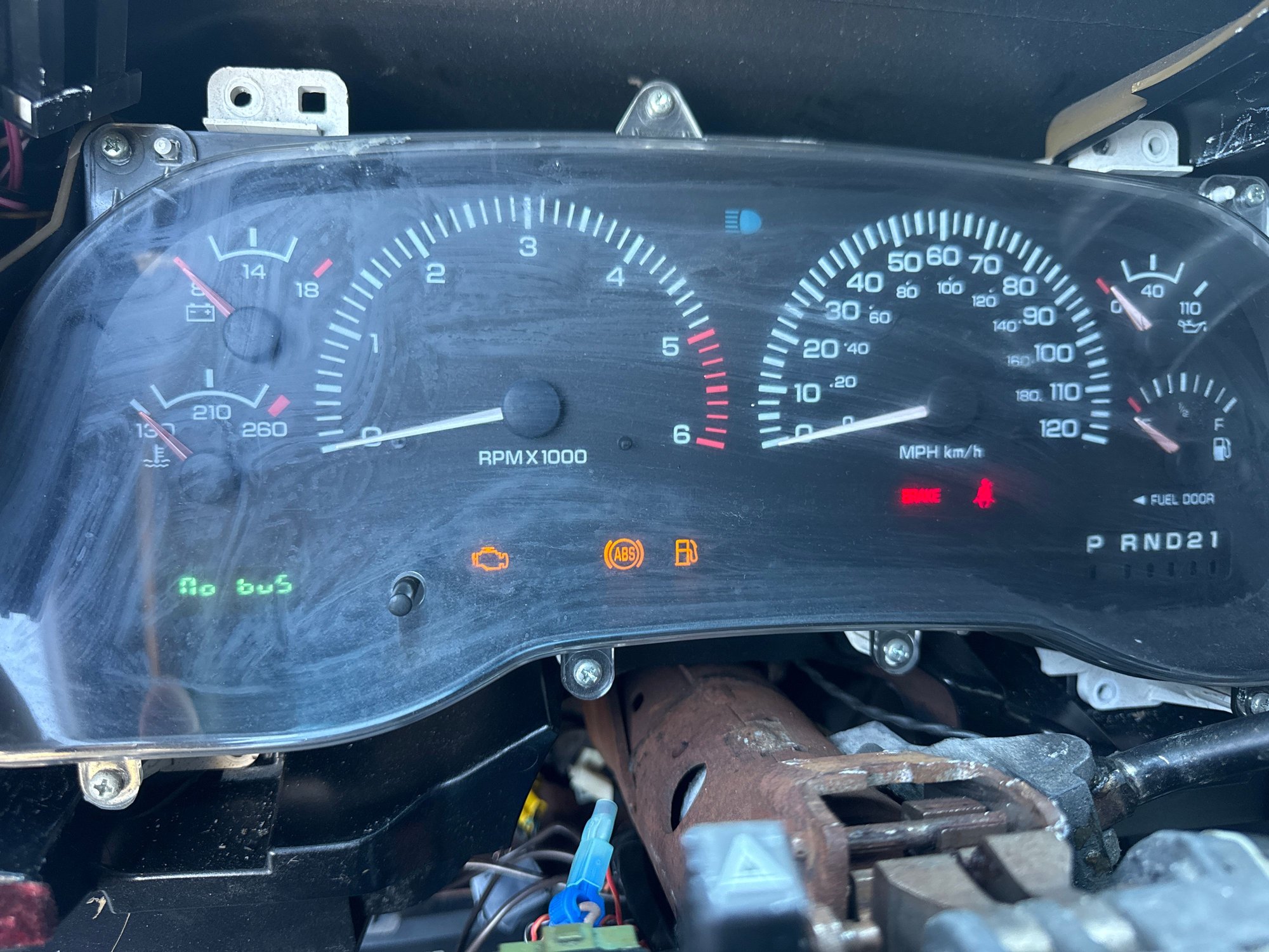

Default Update
I was checking the connections between ground and two particular wires on the OBD connector. I was getting 2.55 V on both the white and black wires as well as the velvet and brown wires. To my knowledge, these both correspond with the PCM and there is no overvoltage. I tried to swap out my gauge cluster with one from a 2002 3500 ram that happened to run on a V8 and I was able to properly install them however.
now I see a no BUS
with the new gauges installed

The comm bus is like a mini computer network in the truck. If there is voltage there, then it is *probably* working. Is this a different cluster???

Originally Posted by Chrisce250
I was checking the connections between ground and two particular wires on the OBD connector. I was getting 2.55 V on both the white and black wires as well as the velvet and brown wires. To my knowledge, these both correspond with the PCM and there is no overvoltage. I tried to swap out my gauge cluster with one from a 2002 3500 ram that happened to run on a V8 and I was able to properly install them however now I see a no BUS
The wires in the OBD2 port are indeed the CCD bus connections. The voltages are about right, literature says 2.51V and 2.49V but I wouldn't be too picky. The voltages are bias voltages and the actual data bits change the voltage difference but that can't be measured with a simple voltmeter.
You might be able to figure out if the bus works with a "shop level" diag tool that can talk on the CCD bus.
