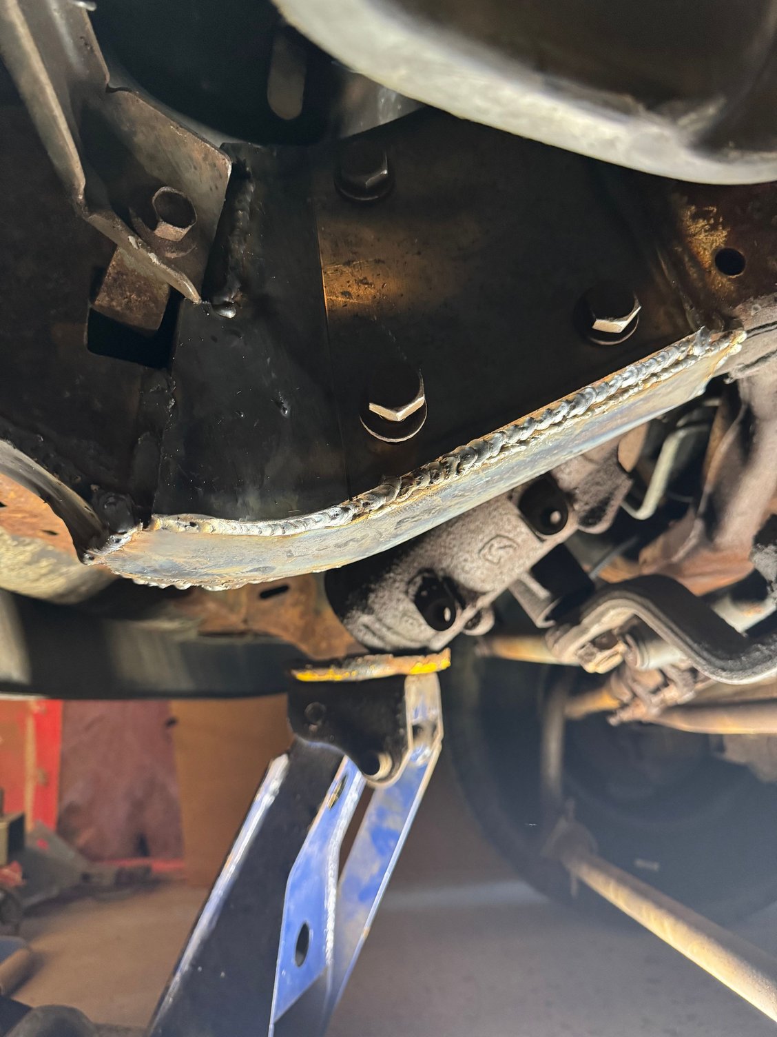

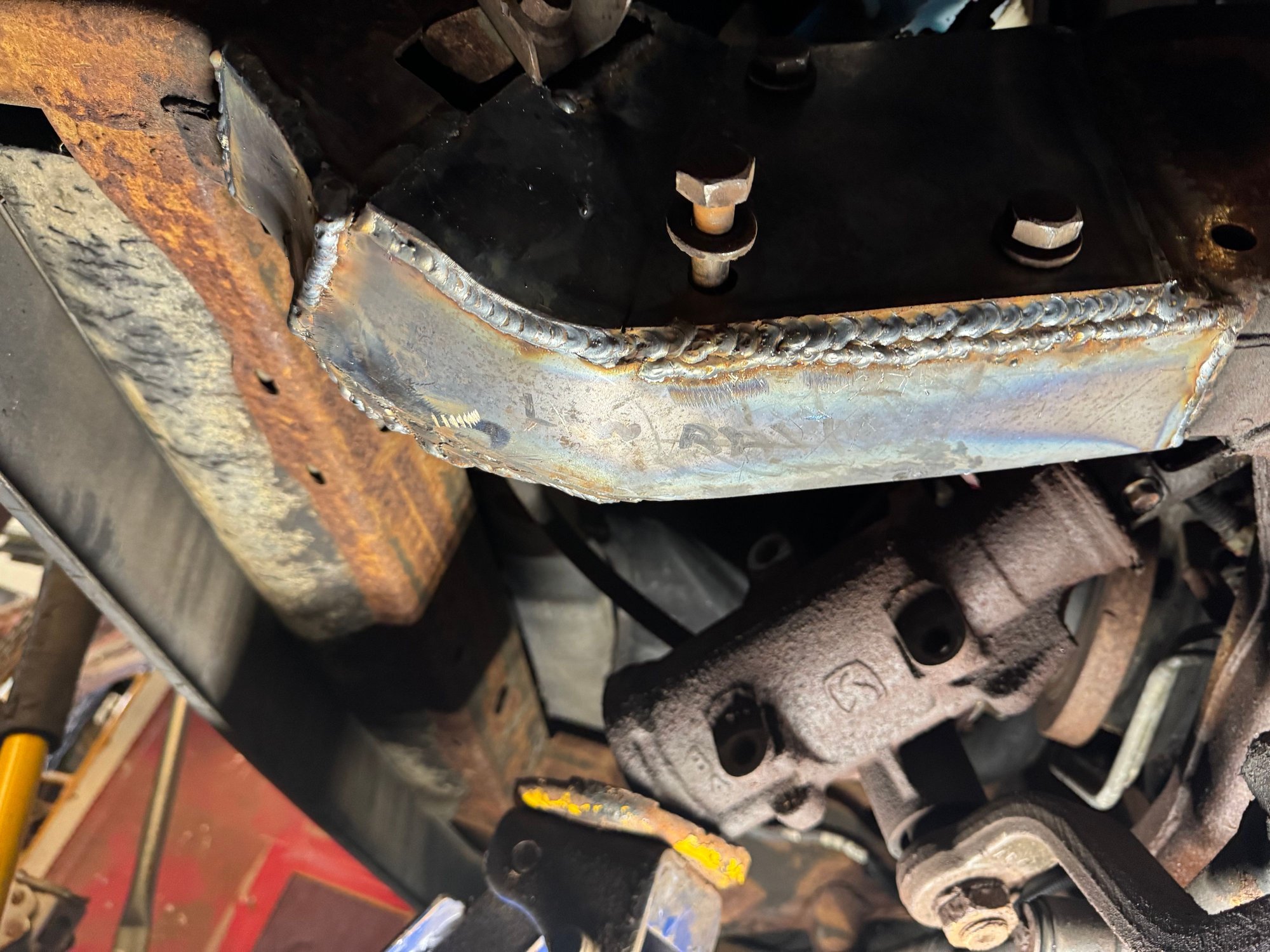

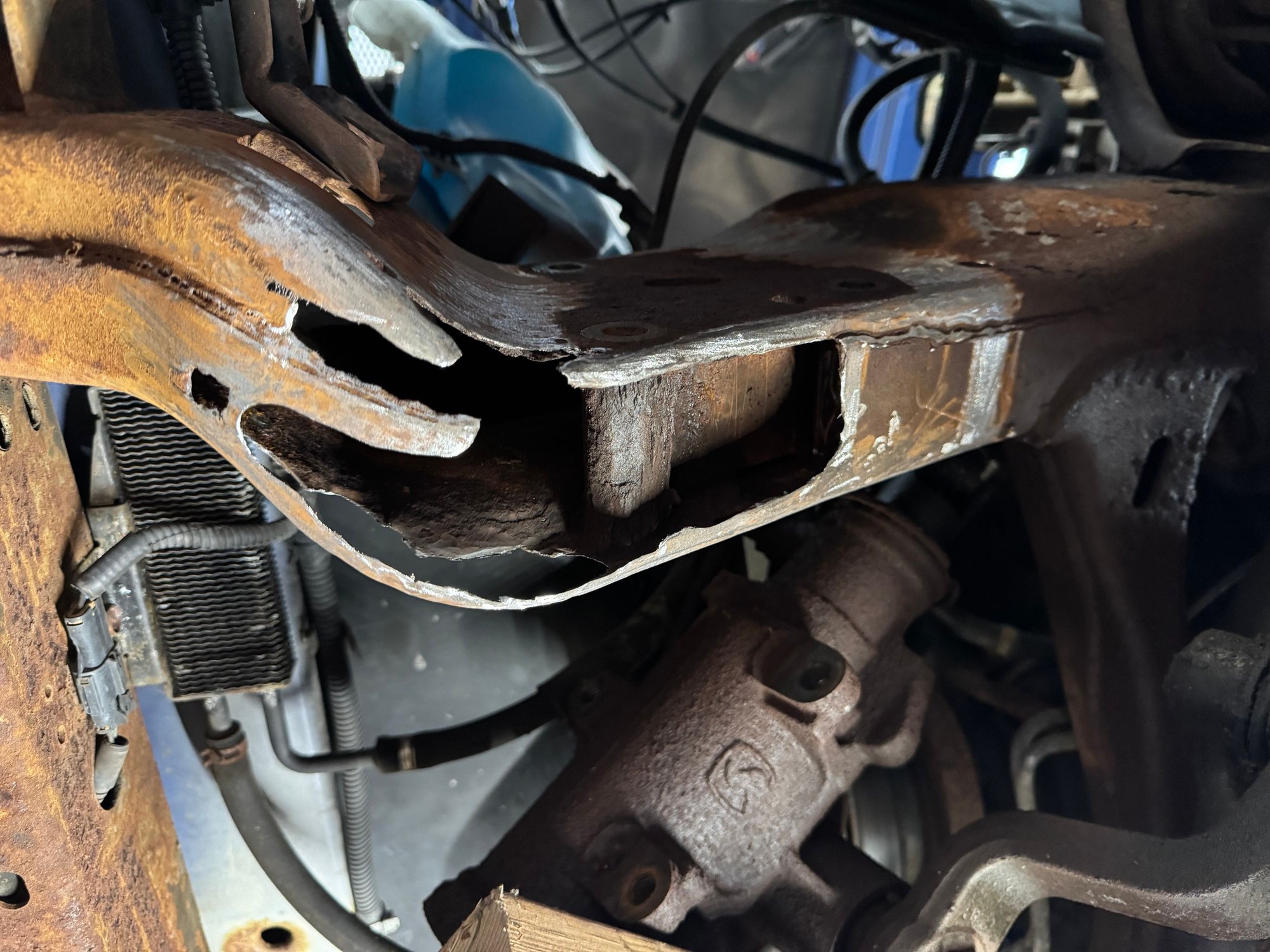

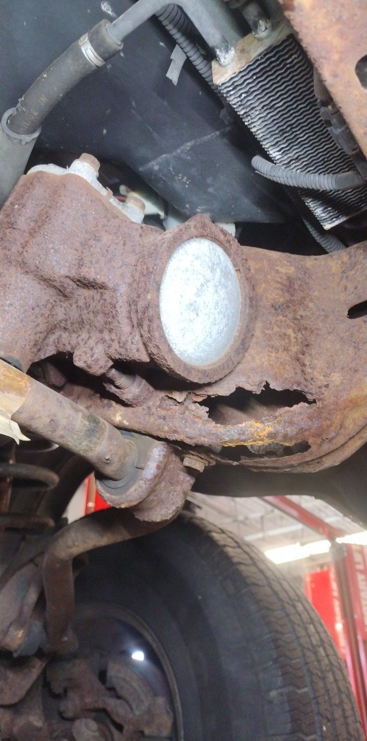

After taking my 96 ram 1500 club cab 4x4 in for an alignment, I was notified that there was a hole in the frame in front of the steering box.
Thankfully my friend is a welder and a boiler maker at work. So after tracing out the frame and then prepping it for repair.
He made the replacement pieces out of 3/16th plate and welded them in place.
There is still one more small patch to make, but the truck is safe to drive now. Probably will need to make a sway bar spacer for the other side, but that will be for another day.

Terrible lighting but awesome!

Lighting in my buddies shop is pretty bad and I think I have the flash off on the phone. Thanks. It was all him. I was there to learn.

I work on a 2000 that spent a bit of its life in PA and is similar but not as bad. The bigger concern is the inboard wall of the frame under passenger door.

When the factory made these frames they made a "cup" by the steering box. There is a hole near it and water splashes in and the "cup" holds it. What where they thinking? Could have at least put a drain hole there.
