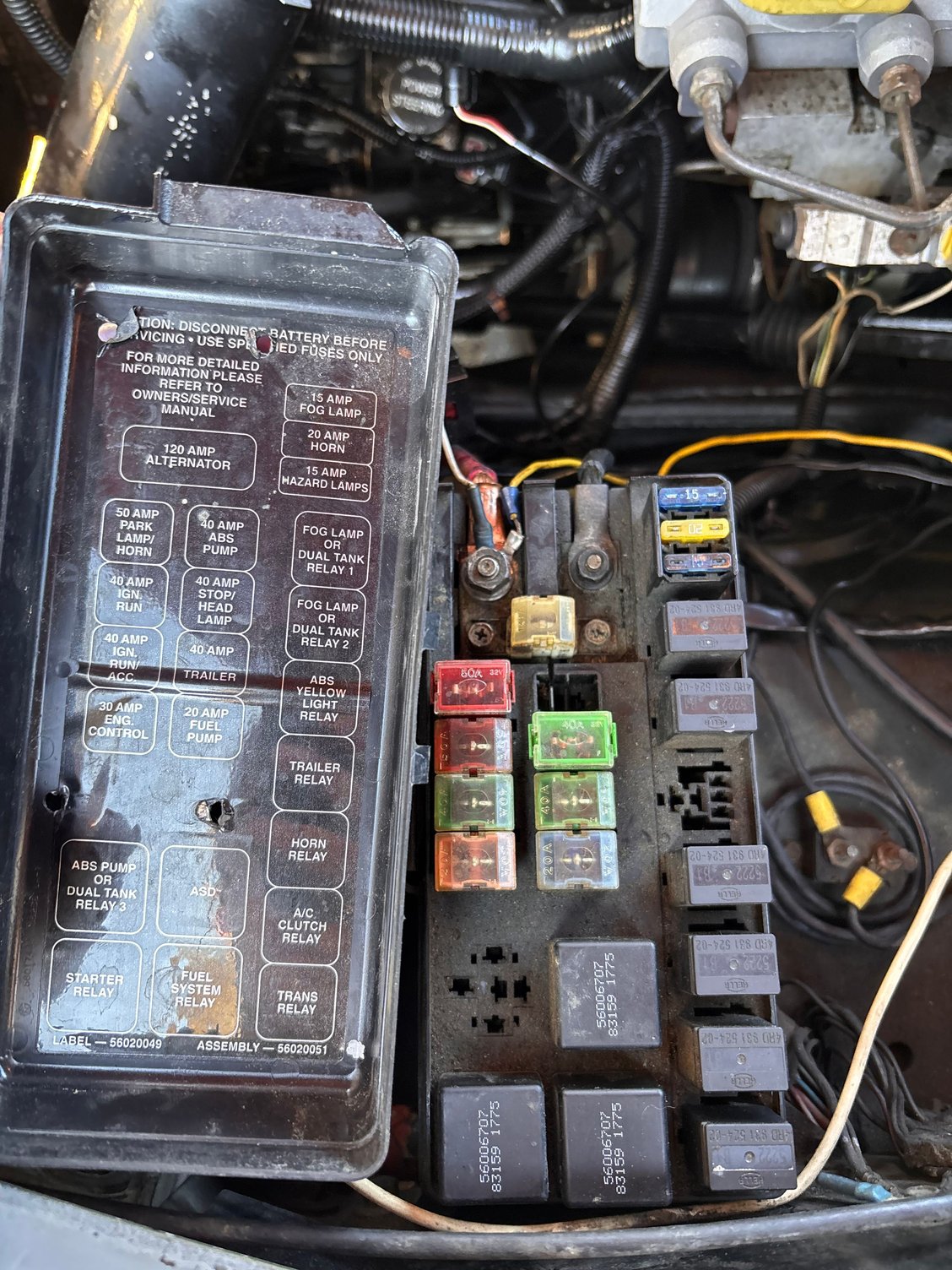

You likely only have RWAL, which wasn't really all that effective..... Does the ABS light test when you start the truck?

You may want to reference the factory service manual for your year truck and have a look at the wiring diagrams that relate to the ABS system, since it sounds like the prior owner may have modified/butchered them. You can download the factory service manual for your year truck here - https://dodgeforum.com/forum/2nd-gen...e-manuals.html
Yeah for reasons only the enlightened gods at Chrysler of days past know the rear wheel only ABS is not wired at the underhood fuse box/PDC at all. There are two fuses (14 and 20) in the inside fuse panel and no relays.
Because it is a really simple system.... Just a dump valve, controlled by the PCM. Doesn't need a lot of power.... It's just two solenoids.
The ABS light does not test when I start the truck…the bulb is still there I checked…unless it burnt.

That would be something to look into. It *should* come on for a few seconds at initial key on.
