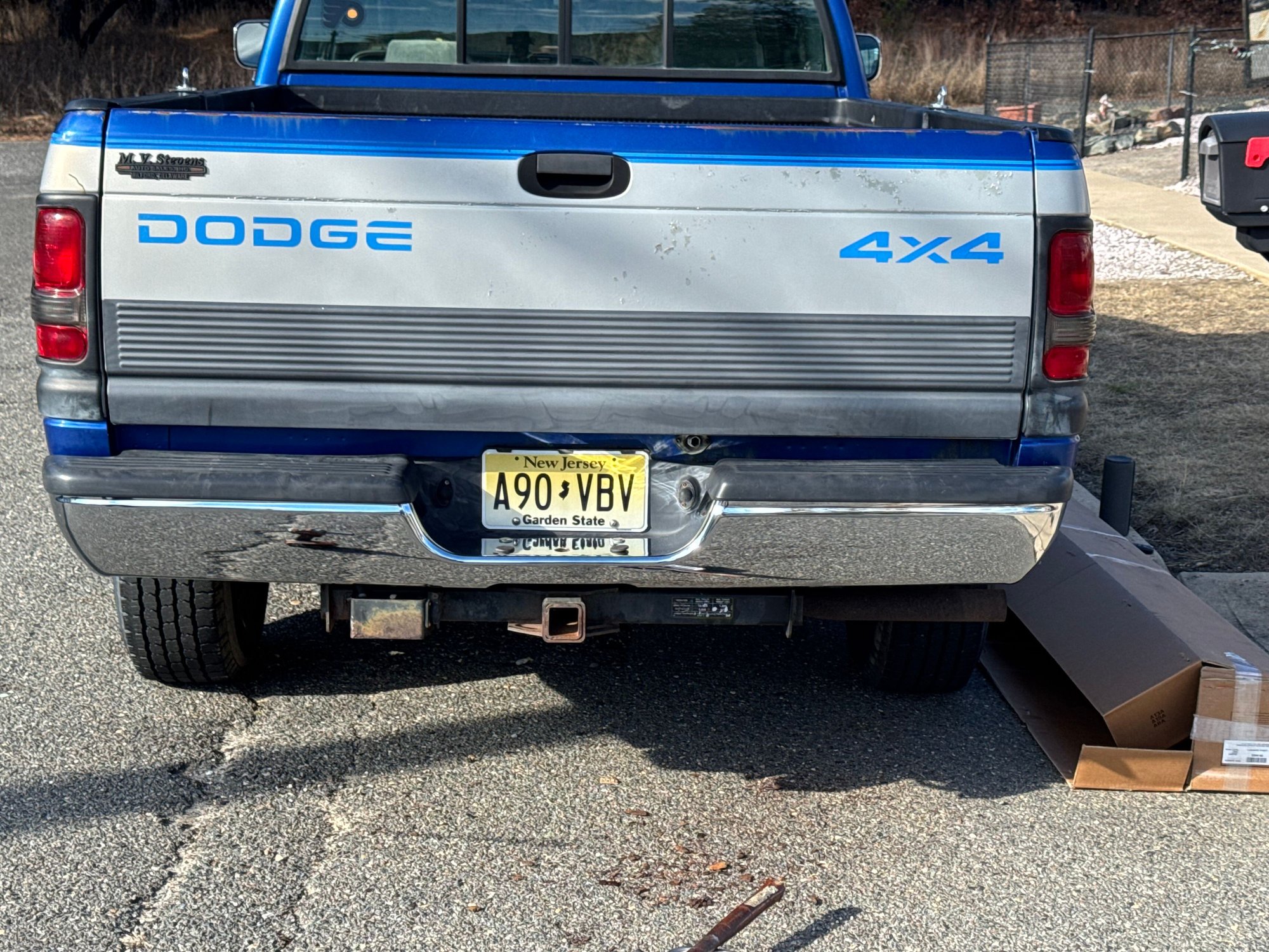

Thank you. Sounds like a spring time job along with shocks, lights, and steering stabilizer. I did replace the rear bumper. She is a work in progress.

Where did you find your bumper? Mine is a sport model, so, body color bumper, but, most of it is gone.....

My kids got it for me for christmas. LMC
You could certainly purchase one new, but you'd almost certainly have to have it painted the color of your truck.
You can try checking car-part.com for a used bumper that 'might' match the color of your truck. I once had to swap out a front fender on my wife's car that got hit in a parking lot while parked and no note was left by the fender-bending offender. I ended up finding one via car-part.com locally that was an exact match, color and all.
