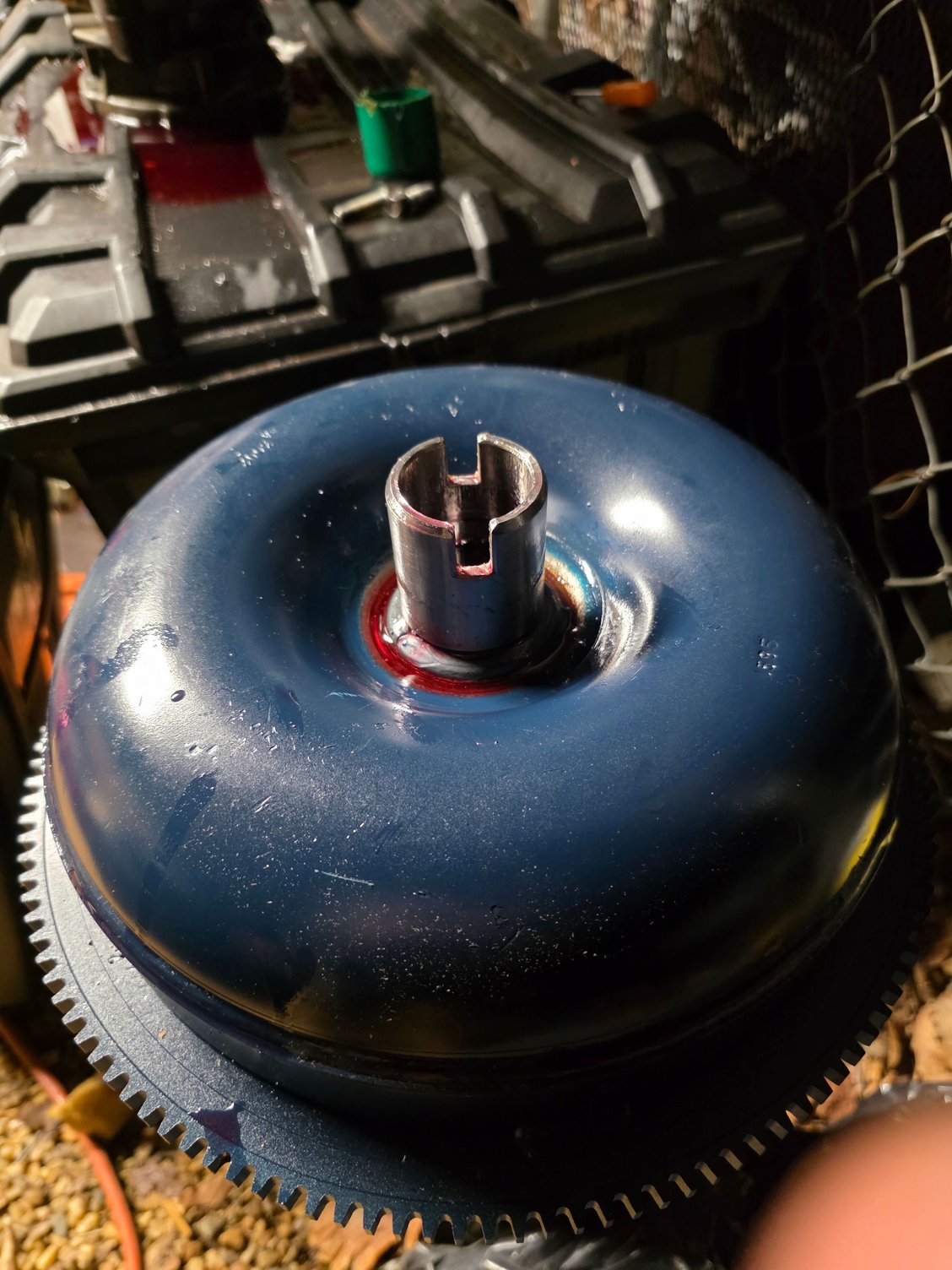

This is the reman TC1054 converter from O'Reilly! Nowhere near within spec, Junk!

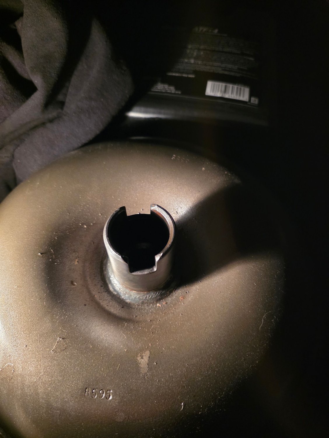

This is a Recon reman from Transtar! Big difference as far as specs go. I looked up what the torque converter specs are supposed to be, and this converter is within specs.
Old Apr 3, 2025 | 06:31 AM
  #42
Moparite's Avatar
Moparite
Joined: Feb 2015
Posts: 7,435
Likes: 578
Why you didn't notice this before you put it in? Did you compare the one you got from O'Reilly to the original? Now a days you have to look and examine everything! It may have the right part # on the box with the wrong part in it. Or you get something with missing parts. I have never dealt O'Reilly's because they are not around here, But I have with the other chain stores. I miss the days of small mom and pop places to buy stuff. They don't exist today.
