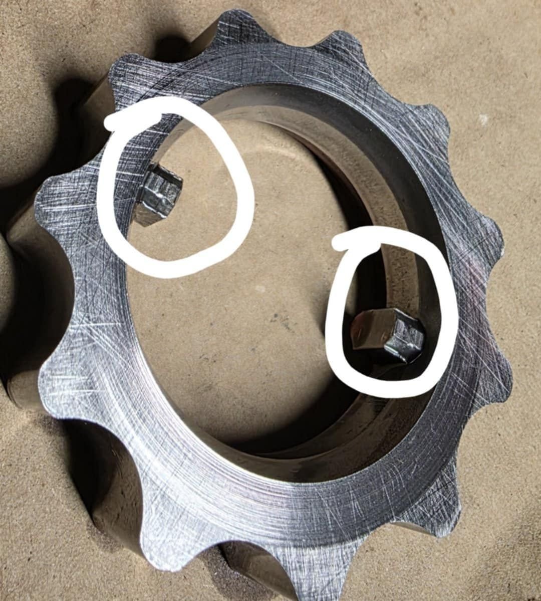

Figured out what the problem was, went to take the torque converter bolts out pushed the converter back to see how much distance is between the pad and flexplate, 3/8", so tried to push it back in and it wouldn't budge! So when i tightened it up, it pulled the converter away from the pump gear tabs. The mounting pads on the converter are just under a 1/4" thick. Going to go ahead and exchange the converter out and check thickness of the pads and tack weld 1/8" washers or whatever thickness washers I'll need. I would need to stay between 1/8" and 3/16" end play, correct?

Torque converter mounting pads are too thin. When I tightened the torque converter bolts, it pulled the converter off the pump gear tabs. 3/8" end play!

Yep, that was the issue, you can see on top of the pump gear tabs where the TC was dragging across them. Man, the quality of remanfactured parts has went to hell!!
