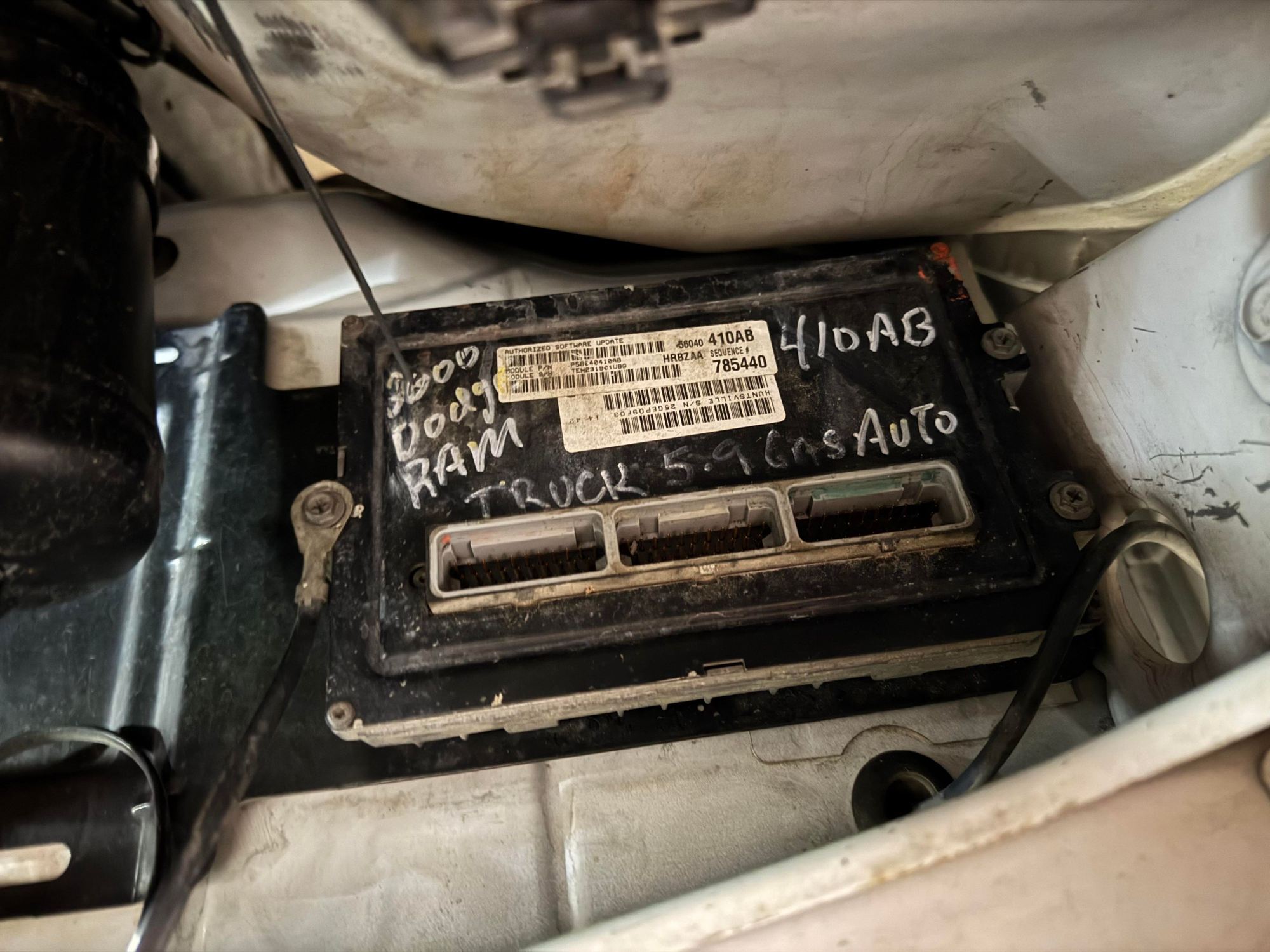

I have not replaced the PCM. It along with the driveshaft, leaf springs, cruise control bellow, vacuum vapor cannister, and brake booster will be quite literally the only things on the truck that have not been replaced. I've spent a LOT of money and time on this thing lol
One of the previous owners might've though as there is white sharpie writing on it stating the year and engine size, so either a junkyard PCM or a flashed PCM, which gives me some concern.

Junkyard PCM would be my guess. And yeah, that IS suspicious..... Though what would be really enlightening is WHY it was replaced in the first place.... O2 sensor codes perhaps??

Just for reference this what my PCM looks like:

Also may be a non Cali PCM. Disconnect bank 2 sensor 1 and see if you get any codes. If not it's not a Cali pcm.

What's the part number on the PCM? (I can't really read it...)
Using the enlargement feature on the photo, it appears to be part number 5640410AB with a software update...
Definitely appears to be a junkyard PCM..
