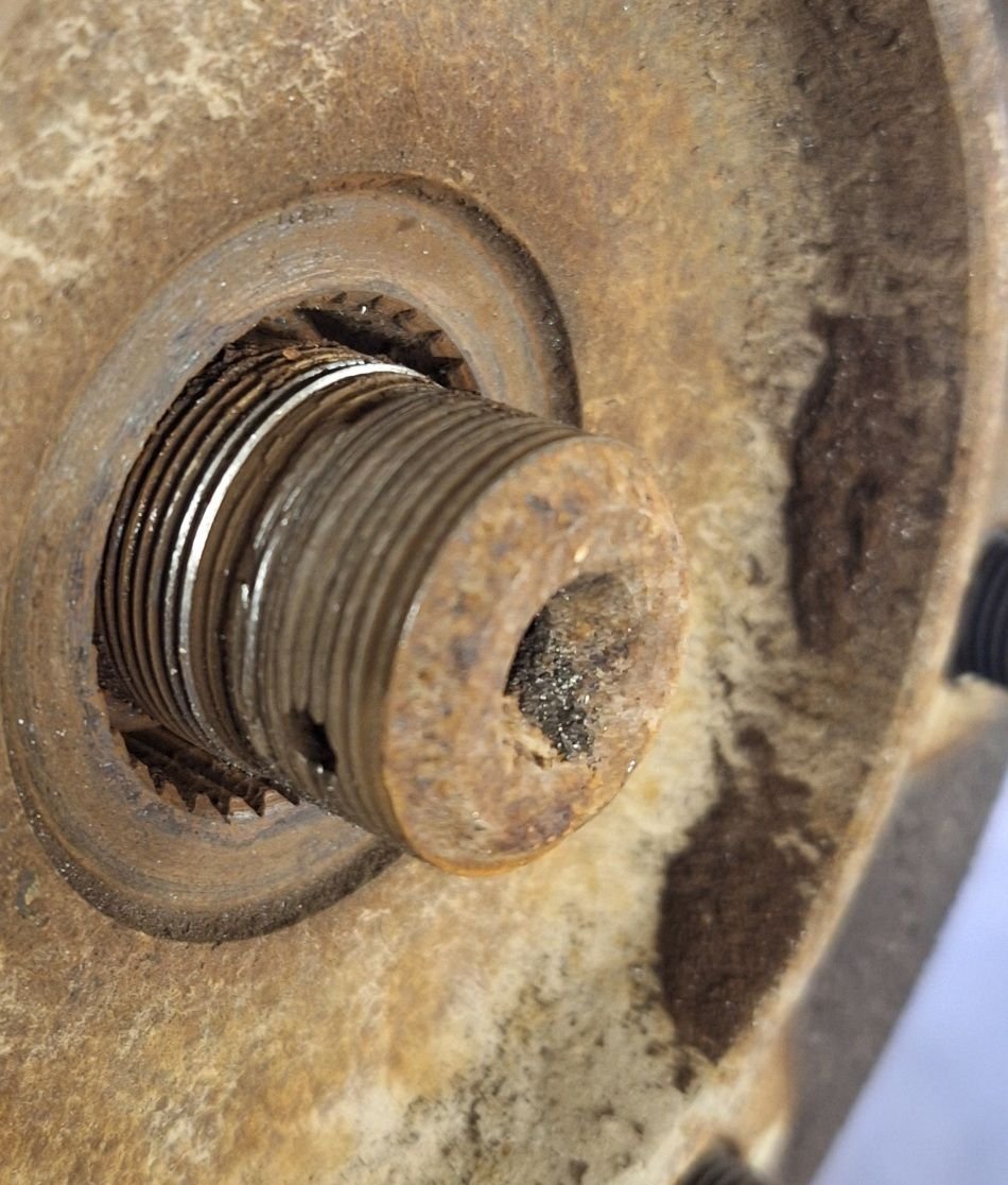

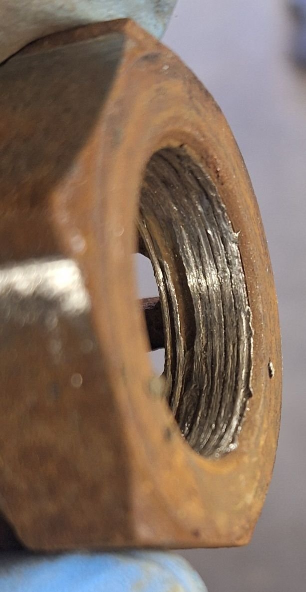

Thread chaser, and new nut?
She's 1.090" where the threads used to be and 1.120" where threads still exist. She's cooked
I ordered the Spicer 75689x which I believe is equivalent and has the slinger (unlike the Dana part #)
