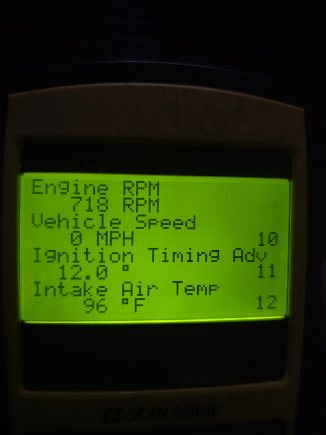

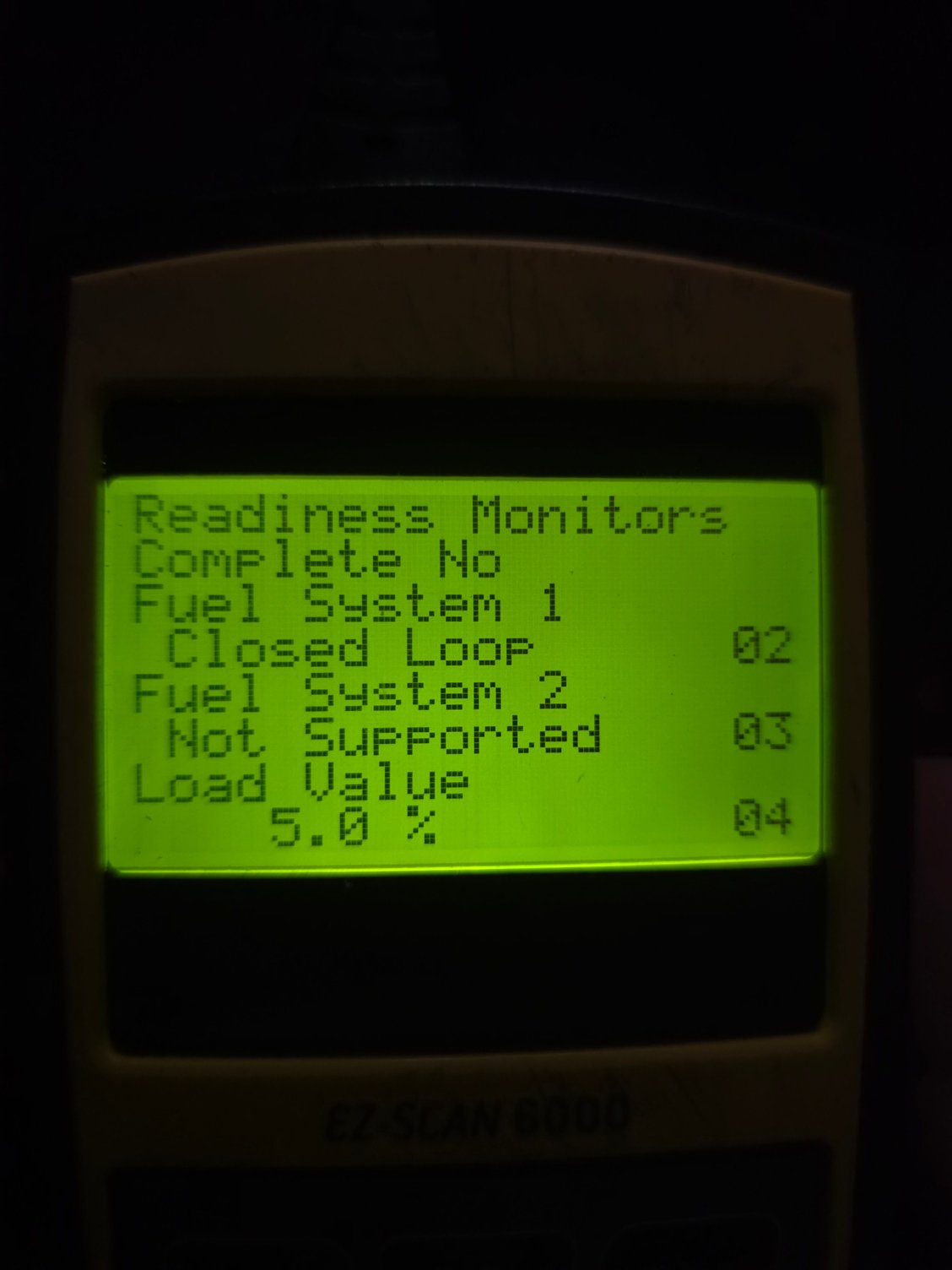

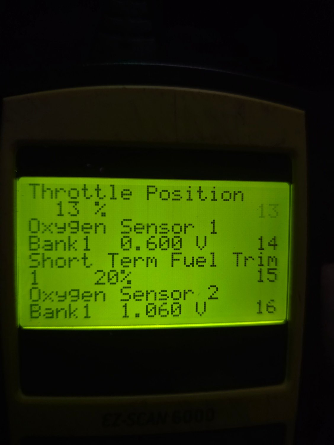

Here is the scan data. Only thing I noticed if fuel trims are high and the rear O2 sensors is only fluctuating 0.20ma.
Old Jul 17, 2025 | 08:57 AM
Posts: 87,483
Wow. That's adding a LOT of fuel...... How old are the O2 sensors??
