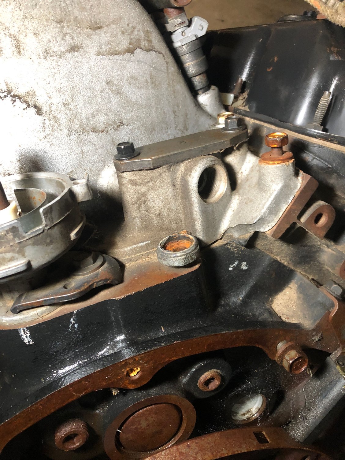

So I did some engine shopping on fb marketplace recently, I thought I was getting a complete 5.2 for $100 which already was a great deal but then I checked the block numbers and it's a 5.9! Boom! Got a fresh 5.9 that supposedly was a runner when it was pulled and clearly came from a junkyard that treated it as such. I pulled the plugs and sprayed lots of WD40 down the cylinders yesterday.
Soon I'll disassemble the fresh 5.9 and examine everything I can before reassembling it with a fresh timing chain and sprocket and with everything as clean and well lubricated as I can get it. I'll post some pictures soon, there is a strange new thing on it's intake manifold which is different from mine, besides that it's identical to my engine in every way. I'll post a picture of the mystery plate in a minute here, I'm curious what you guys think it is.

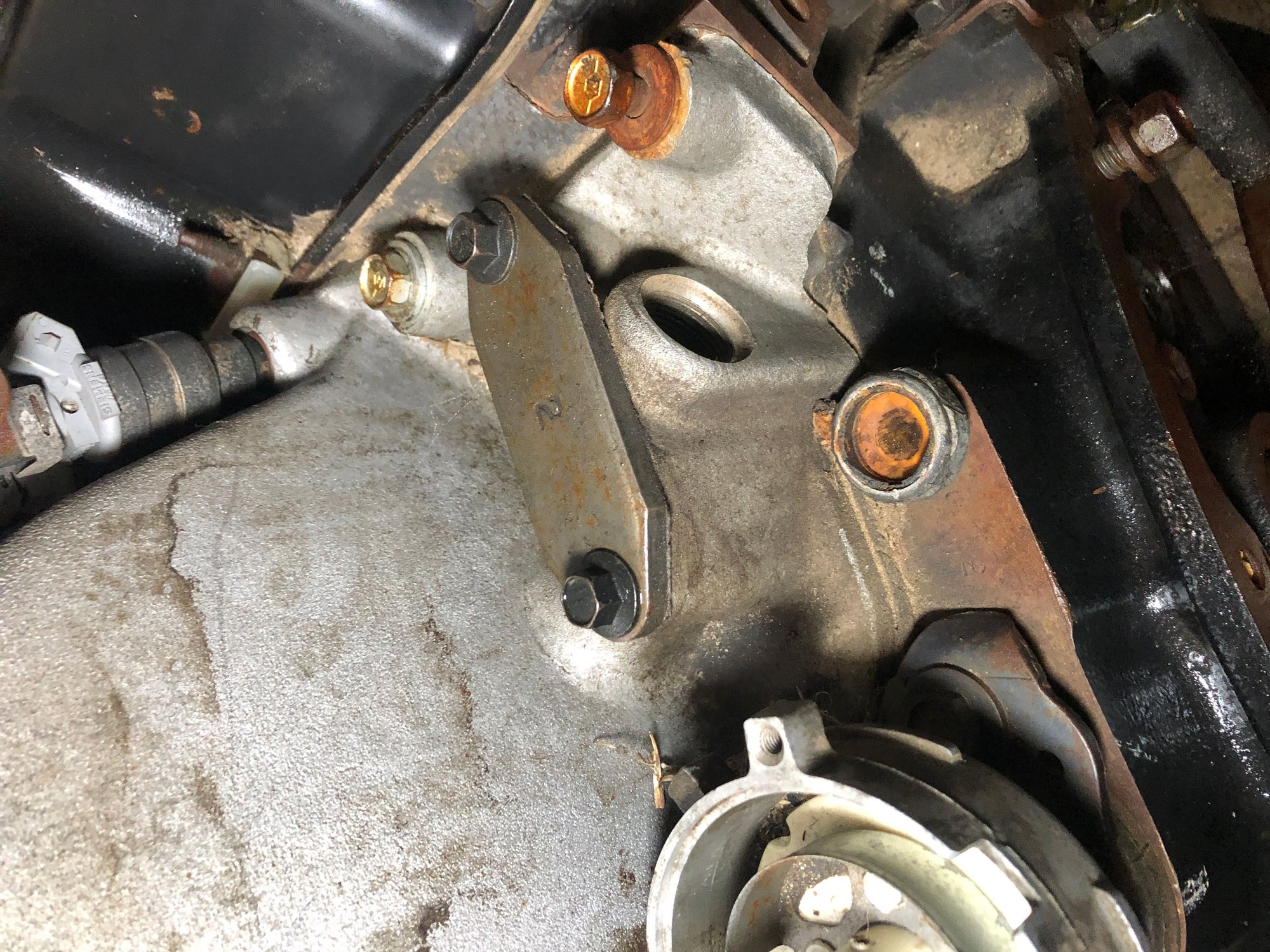

The hole is threaded

My guess is that this is the EGR valve and someone deleted it with that plate. This would indicate that this engine is probably a bit older like a pre '96 right?

I'm still trying to locate the date for it, I've been having troubles finding on on the block.

Posts: 87,478
Should be cast into it somewhere.... usually on the drivers side, towards the bottom.
My 96 didn't come with EGR, but, the intake had the blockoff plate. My guess is, they had leftover manifold from the EGR age, and just put a plate on 'em, and used 'em. You don't wanna use that intake though if your truck didn't have EGR originally. The china wall, and tube for the EGR is kinda restrictive.....
