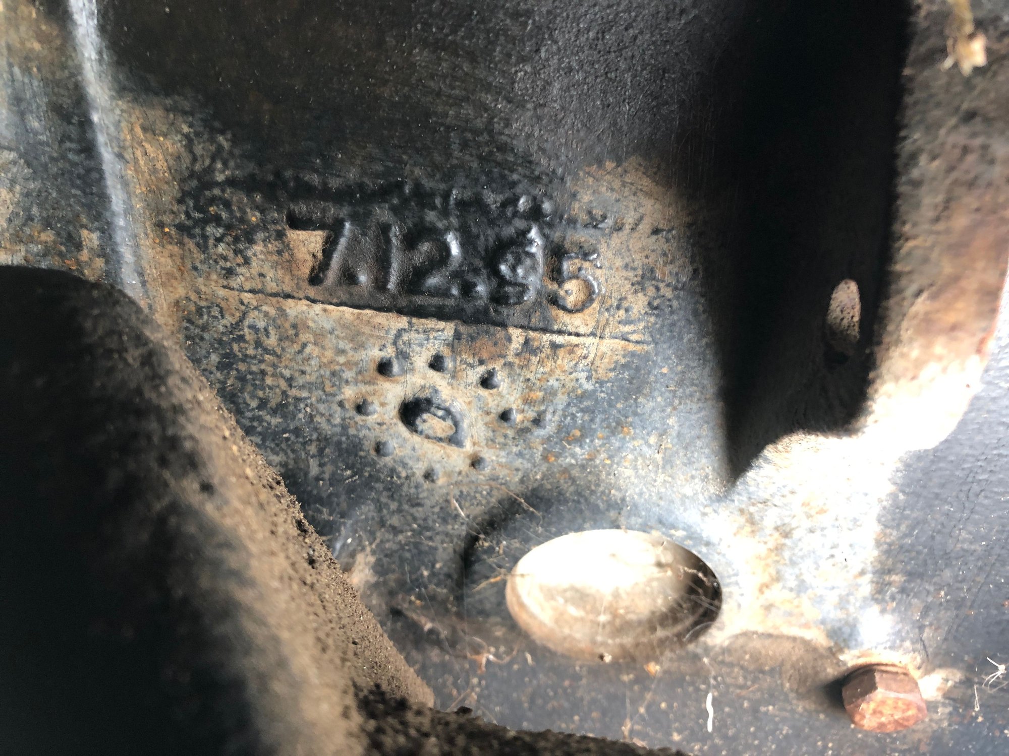

Hey Y'alls,
So I'm trying to date this new 5.9 block I got on facebook. The guy who sold it to me said it was from a 1998 dodge ram but who knows. From what I can tell the closest thing to a date on it is an 95 on the passenger side on the block. Maybe I'm reading it wrong and it's a 85? Trying to make sure it's going to be compatible with my 99 ram 1500. It looks identical except for the EGR plate on the intake. What do y'alls think? If it is a 95 is that compatible since I've got my own intake and such already? Where there any differences with these 5.9s?
Old Oct 5, 2025 | 08:00 PM
  #37
Posts: 87,480
I don't think there ARE any differences in the block. They were all in the bolt on stuff. Intakes changed several times over the production run.....
I think that implies the block was cast in 95, when it actually found it's way into a truck though, that's a very good question.

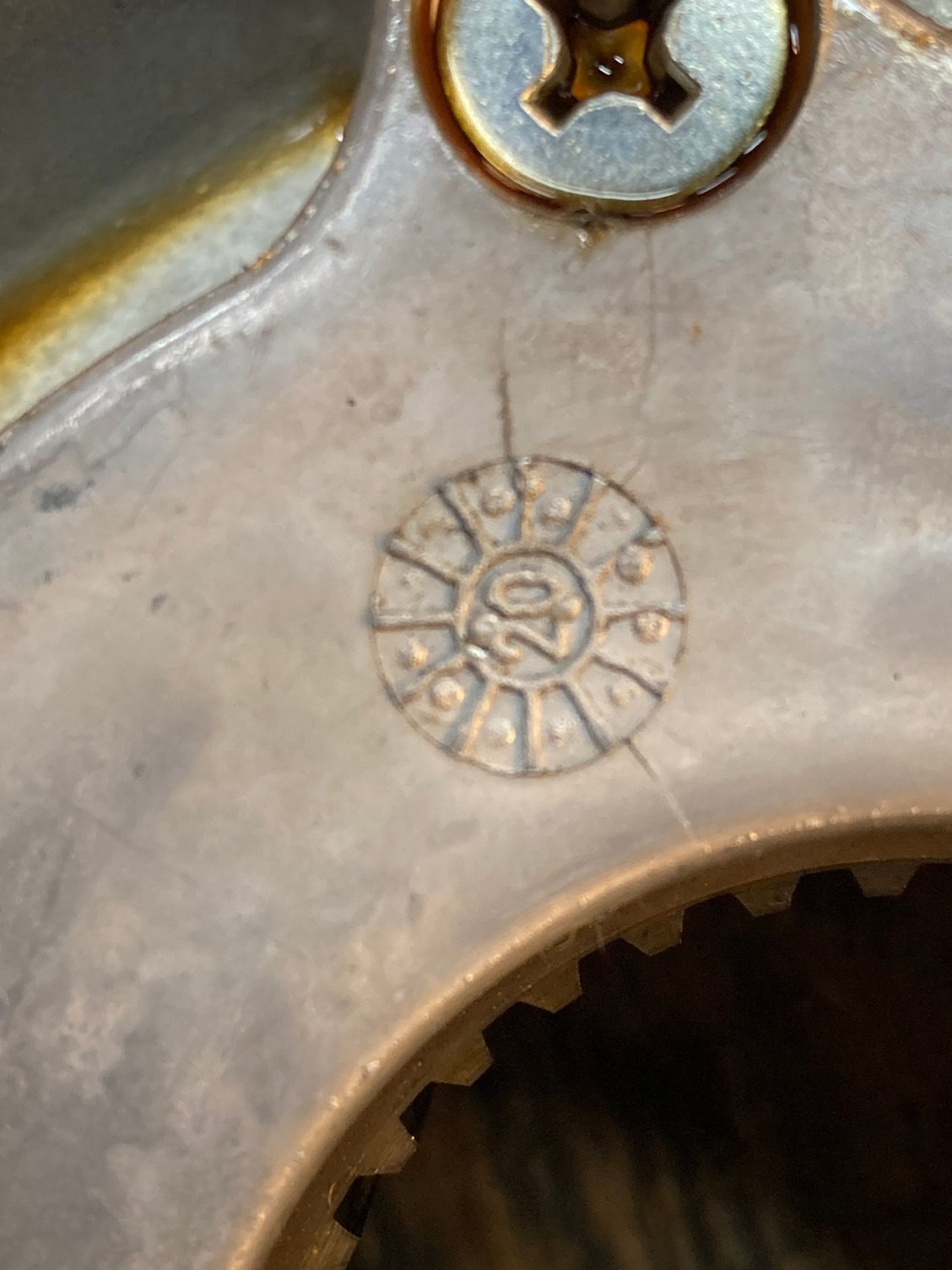

They stopped doing that in the early 70's, It was nice you could tell what the motor came out of. The magnum blocks are the same the entire run just different casting #'s if it's a 318 or 360. Sometimes you will notice something that looks like the image below, It's a casting date (year). I would imagine the intakes had them somewhere. This is not taken from a dodge but it looks very similar. Chrysler has been doing this for years, It's not on all parts (block and heads excluded) but quite a few.
