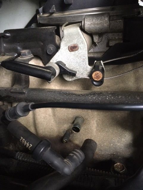

Hello again and may I say that I did a very extensive vacuum test to see if my plenum gasket was leaking and yes it is. You have to be careful of others showing how to on this subject.
I used rubber female and male plugs, not duct tape and closed off every vacuum line or nipple including the brake booster and every outlet coming out of the valve covers (2). In other words every outlet or inlet to the engine with the exception of the dip stick tube and that is where I hooked my vacuum gauge to and found 10" of vacuum in it. When I started the engine I waited and watched at a minute or two to see it slowly climb to 10" at idle.
