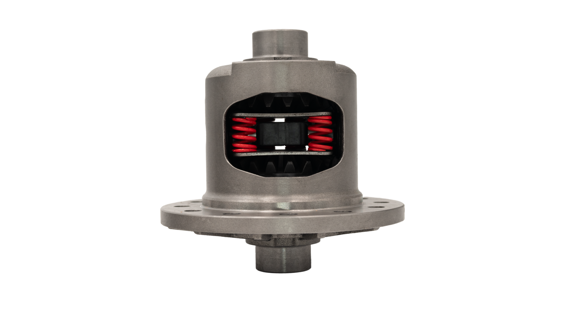

If you compare it to other limited slip units you will see springs to put pressure on the clutches. This is a pic of a "sure grip" rear from the 70's(in a 9.25).

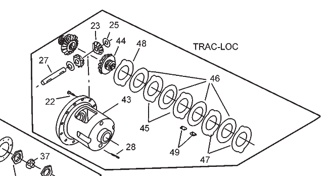

This is a diagram of the "Trac Loc" Dana/Spicer made these not only for the 9.25, This diagram is for a Dana 60(different parts but same design).
If you look at #48 it's called "Plate – Preload Spacer" AKA spring. I can see this working with brand new friction plates/steels but not long after they start to wear. Not sure how well heat effects their performance either. Also how much pressure is it applying? Another issue is #49 the clips that break and cause problems. I would think on paper this would work but in reality? Add in that many manufactures make rebuild kits for these but are they the same quality as genuine Dana/Spicer parts? The Dana 70 has a "Power Loc" but uses two " Disc Dished"(aka springs) between the friction plates and no clips. Although similar but different.
A conventional friction disk type with "regular" coil springs are the norm for any true limit slip.

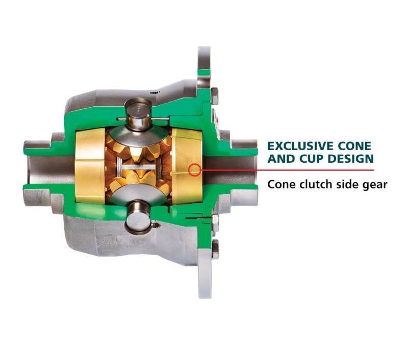

A conventional coil spring will apply force over lot longer distance than a belleville/conical spring will. I have experience with these styles along with the Auburn style limited slip units.
These use a cone and cup design, And as long as they are clean of debris work well. Add debris and it tears up both surfaces and doesn't work as well. And from what I seen you can't get parts for these unless straight from Auburn. Neither of these have any problem putting down two black strips of rubber on the asphalt!

They make a plated lsd to but it uses a belleville washer for a spring also. I'll stick with the conventional plate coil spring type. Tried and true only down side is you have to replace the plates when they wear out. You can get the Auburn style for about $450 here. I'm not knocking the Auburn it works but I would make sure the diff you put it in is spotless and change the fluid more often to keep contaminants out. Yukon Dura Grip I found for $360 here. Options are available that won't break the bank.
