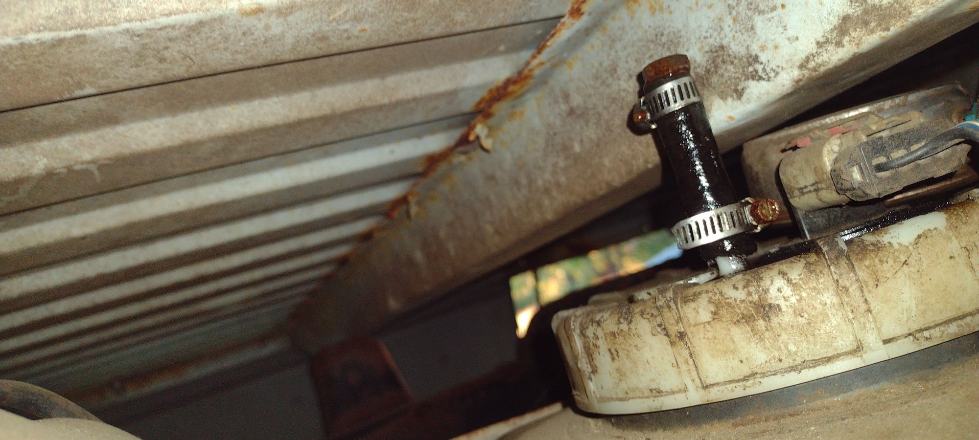

Put pressure at the line that comes from the fuel tank to the canister. Saw no smoke, but did see seepage at the fuel pump area. .The little stub at the tank with two hose clamps. I did apply more pressure that recommended for the evap system. Tomorrow I will apply vacuum to that .line.
rom the regulator to the fuel rail, so that is the guess here as well. I will double check pressure with a separate fuel pressure gauge to be sure.
