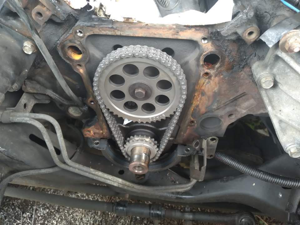

See how much slop your timing chain has. Take the distributor cap off and use a marker or soap stone (absolutely NOT a pencil!!!!) and make a mark at the spot where the rotor is pointed. Out another mark on the balancer. Not put a socket on the bolt on the balancer and rotate the engine backwards. Watch how far the balancer moves before the rotor moves. I'm thinking your timing chain has jumped if it hasn't ever been replaced.
I did a major tune up on my '96 a couple of years ago when it blew the plenum gasket. I didn't pull the heads or exhaust manifolds but everything else on the top and front of the engine came off. With 168K showing, the timing chain was still timed but was getting a lot of slop. I found all sort of surprises. A beer can laying in the valley, oil soaked cigarette butts, a leaking oil sending unit, a balancer coming apart and so on.
I also replaced some broken bolts and put new injectors on it. I had to make a new gasket for the throttle body by hand and I don't think I did a good job as it idles low when you first start it and I get a purge code at times, but it purrs like a new engine now.
If you do need a new timing chain, go ahead and replace the water pump while you're at it since the labor is already done. Pull the intake and check the intake gasket too. I put the Hugh's engineering kit in but if you just tighten the intake gasket bolts with some sealant you should be okay.. I doubt you'll find an old can of Schlitz beer in there though.
