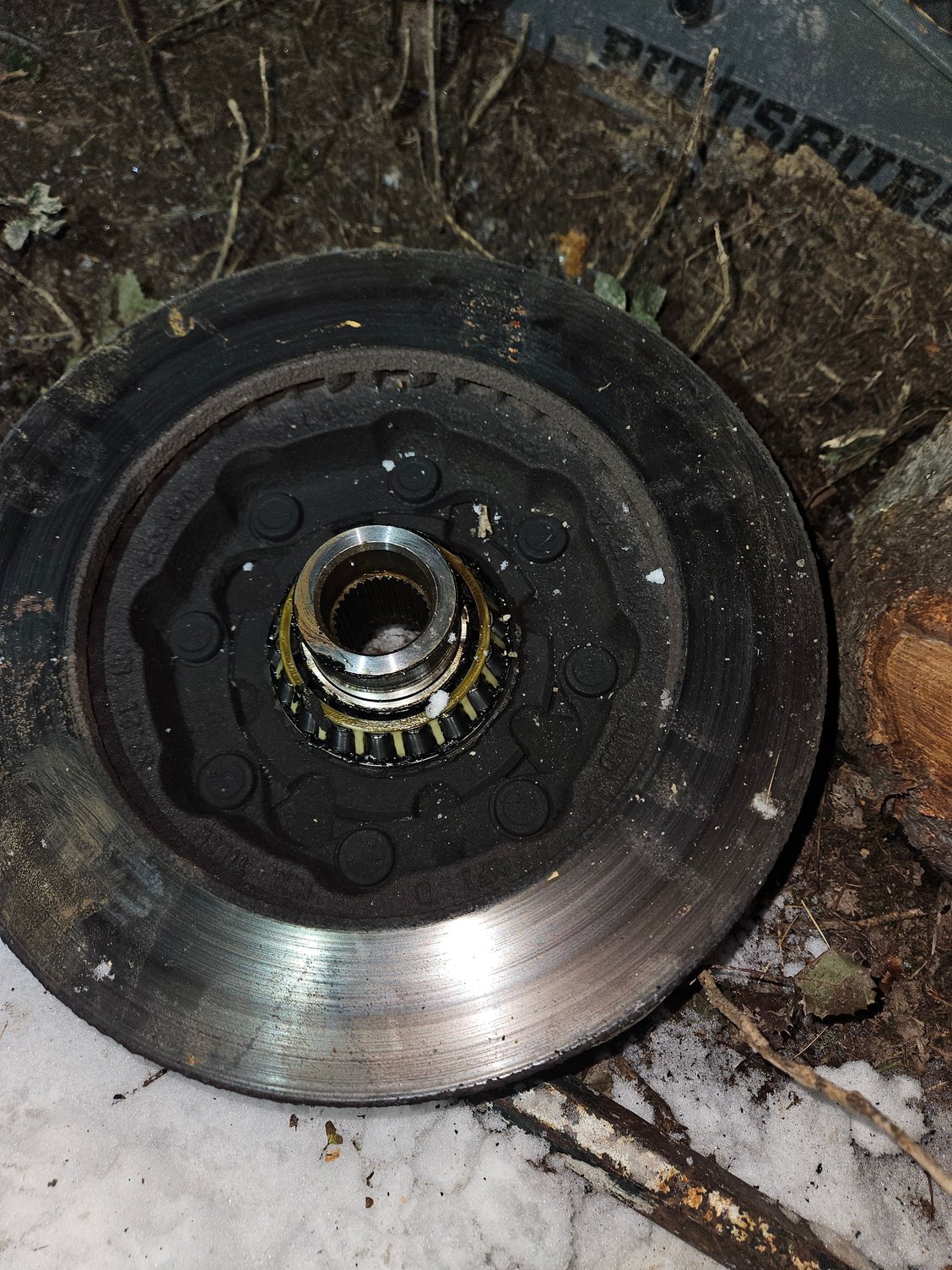

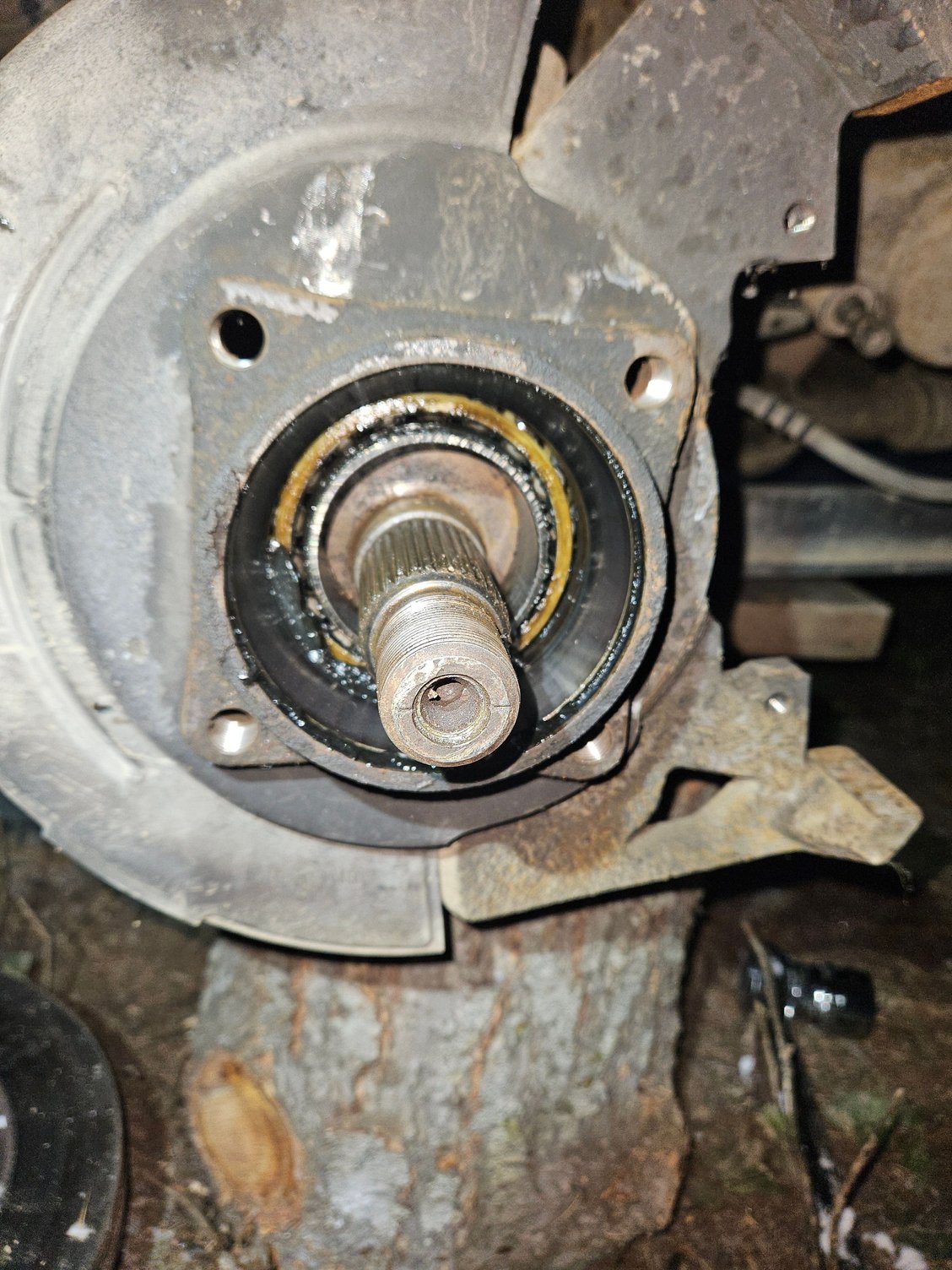

Hey guys, I'm in the middle of changing my wheel side U-joints on my 94 Ram 2500 4x4 with the dana 60 up front. I removed all 4 wheel hub bolts , as well as the axel shaft nut. Then, I used a puller hooked to the outside lip of the wheel bearing hub assembly to pull the bearing assembly and rotor off. My problem is that only half of the hub assembly came off. The other part is still stuck on.
My first question is how to get it the rest of the way out. I talked to a mechanic friend, and he said to get a some linger bolts and screw them back into the hub assembly part way, and then just beat it off.
Secondly, am I correct that I should replace the wheel bearing assembly, or since the bearings themselves still look good, could I press the assembly back together?
And then lastly, did I miss a step or do something wrong that caused it to break apart?
The hub or bearing? Do you have a pic?

The longer bolts trick works pretty good. Since they have been pulled apart though, continue with replacement......

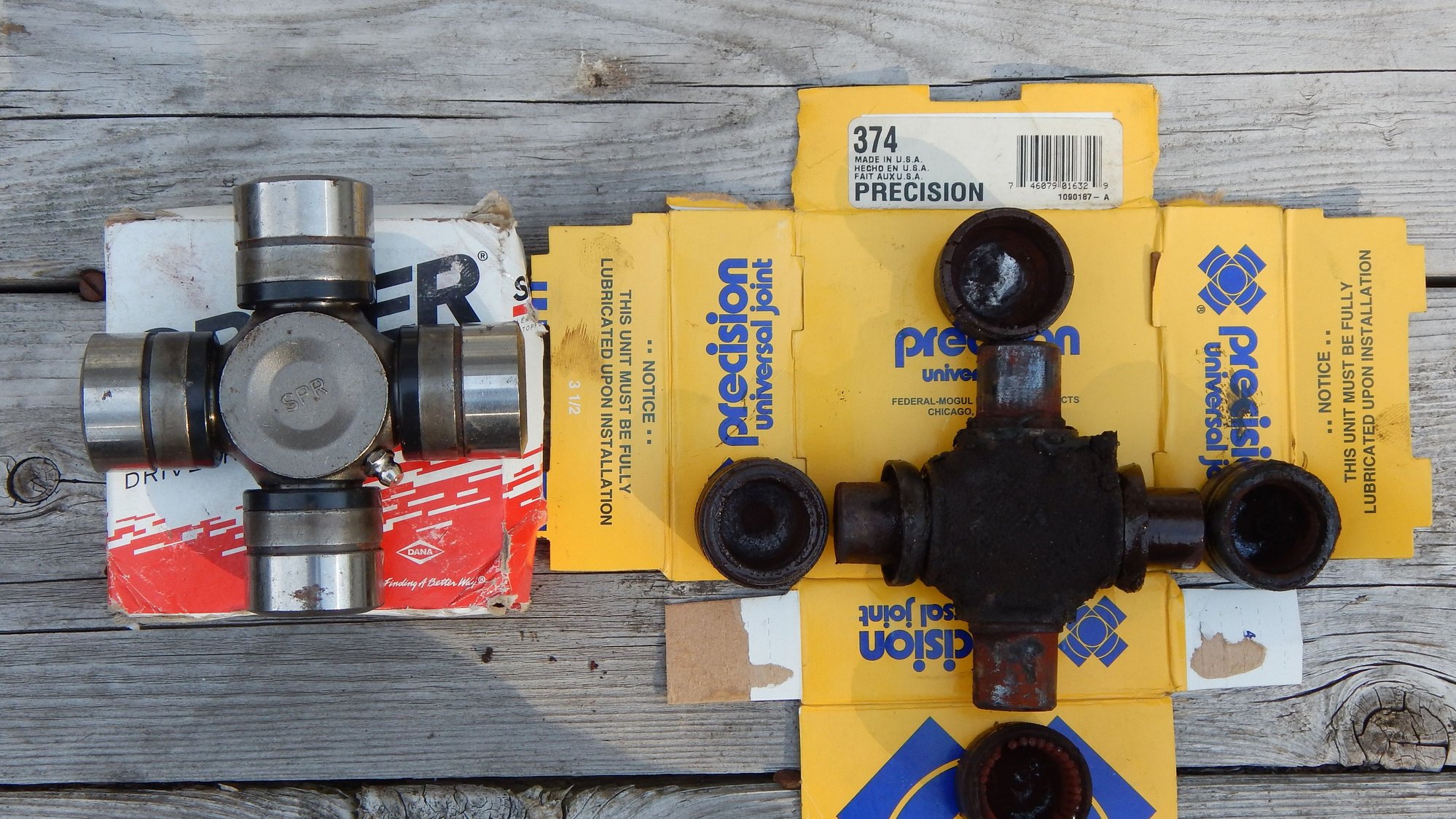

I only put Timken in mine! If you haven't been down the wheel u joint rabbit hole yet let me fill you in. Cut to the chase, Get spicer life SPR u joints. Why? Here is a pic of both joints. The one on the right was replaced when i got my truck about 60K miles. These failed about two years later, JUNK! Replaced them with mentioned joints above. My truck now has 254K and these u joints are still in it!
