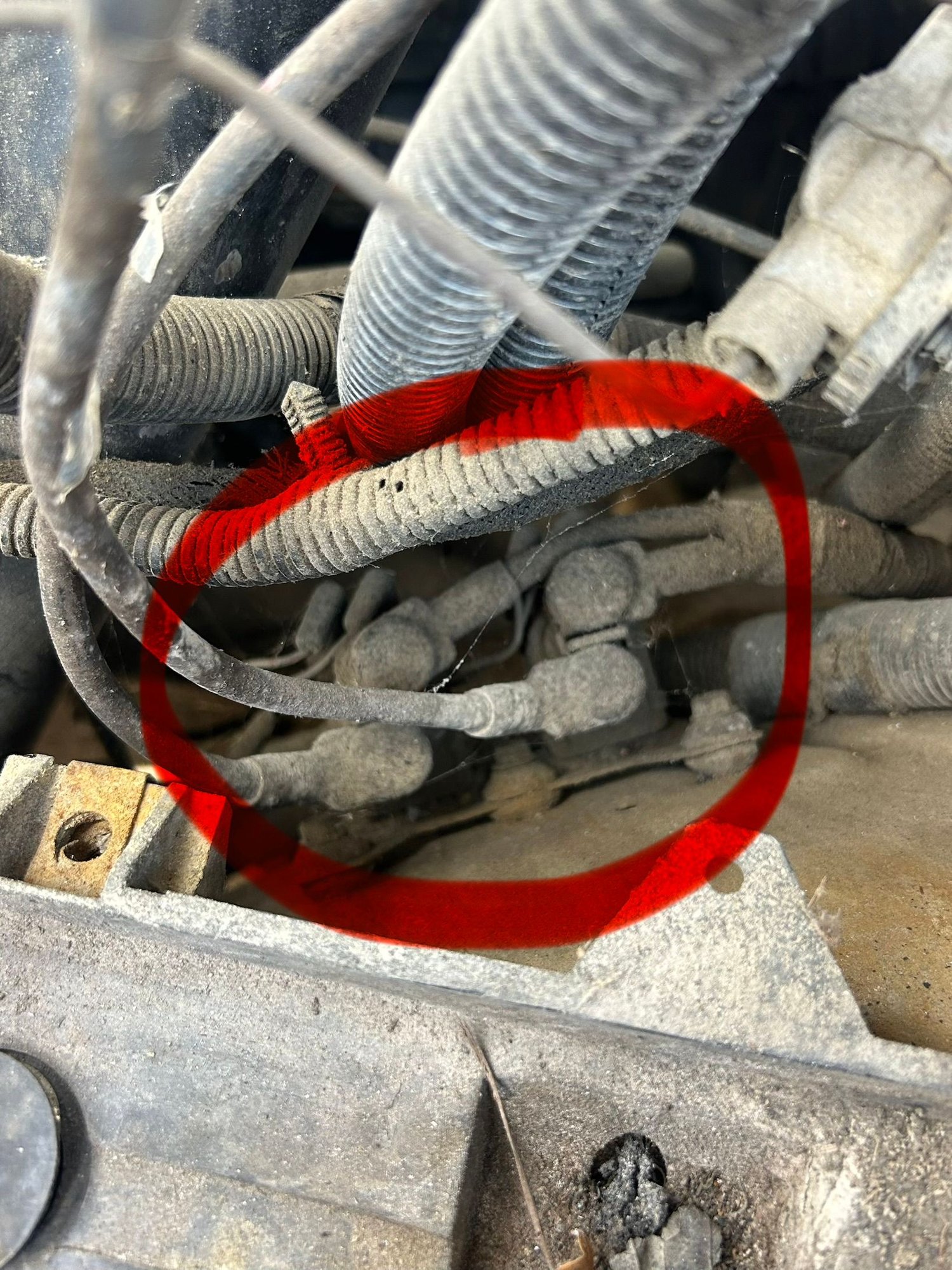

Ok guys so i have a question…i need to know what this part is called…its on the driver side attached to the inner fender

Those are relays for the grid heater (used on cold starts), that is located on the intake.

where do they go to, it looks like there is 4 is that right​​​​​, where do they run to cause i got one broke
Grid heater is between the intake elbow and intake manifold, wires go to there from relays, and relays get their power from the power distribution center, next to a driver side battery.
