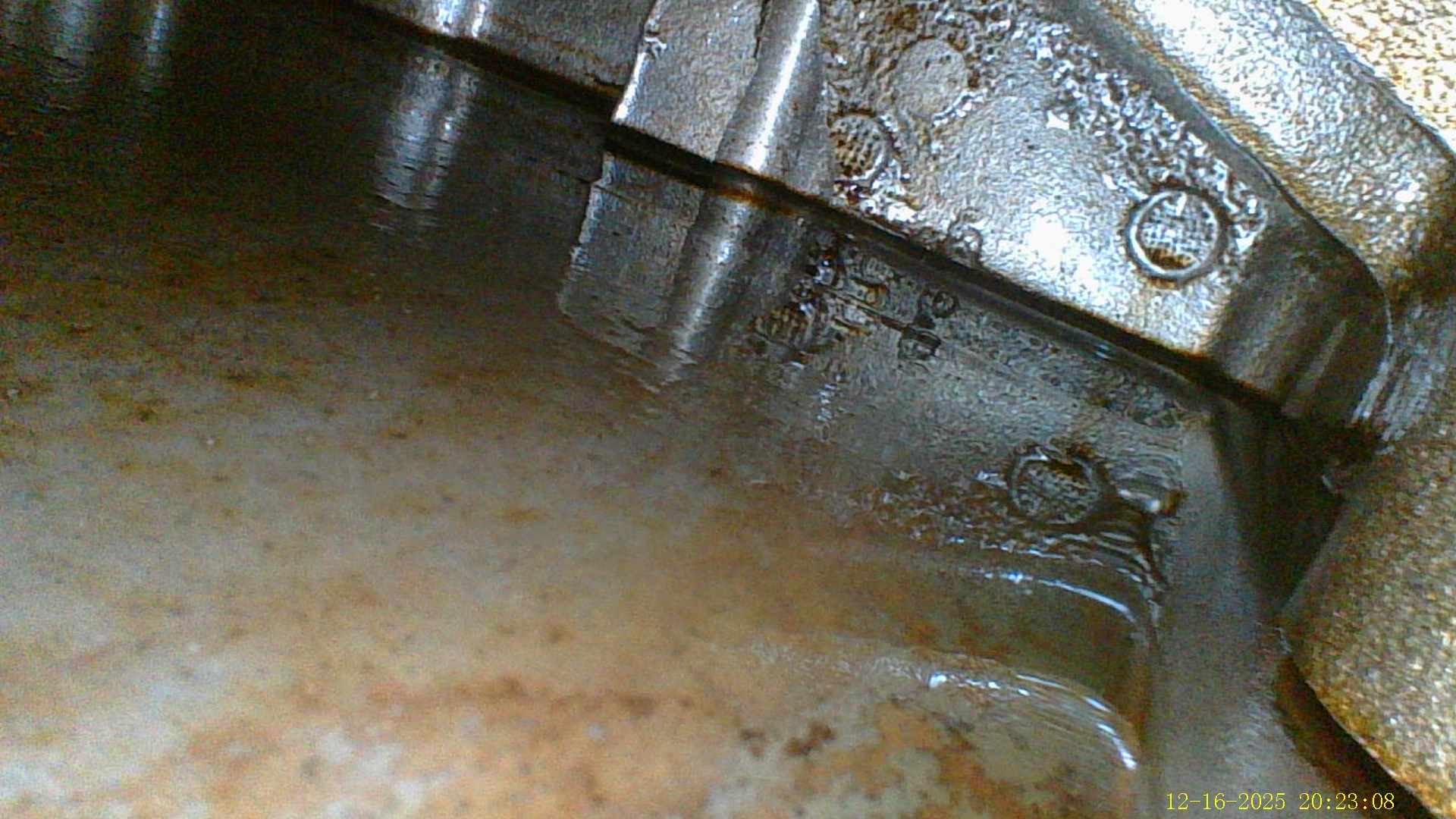

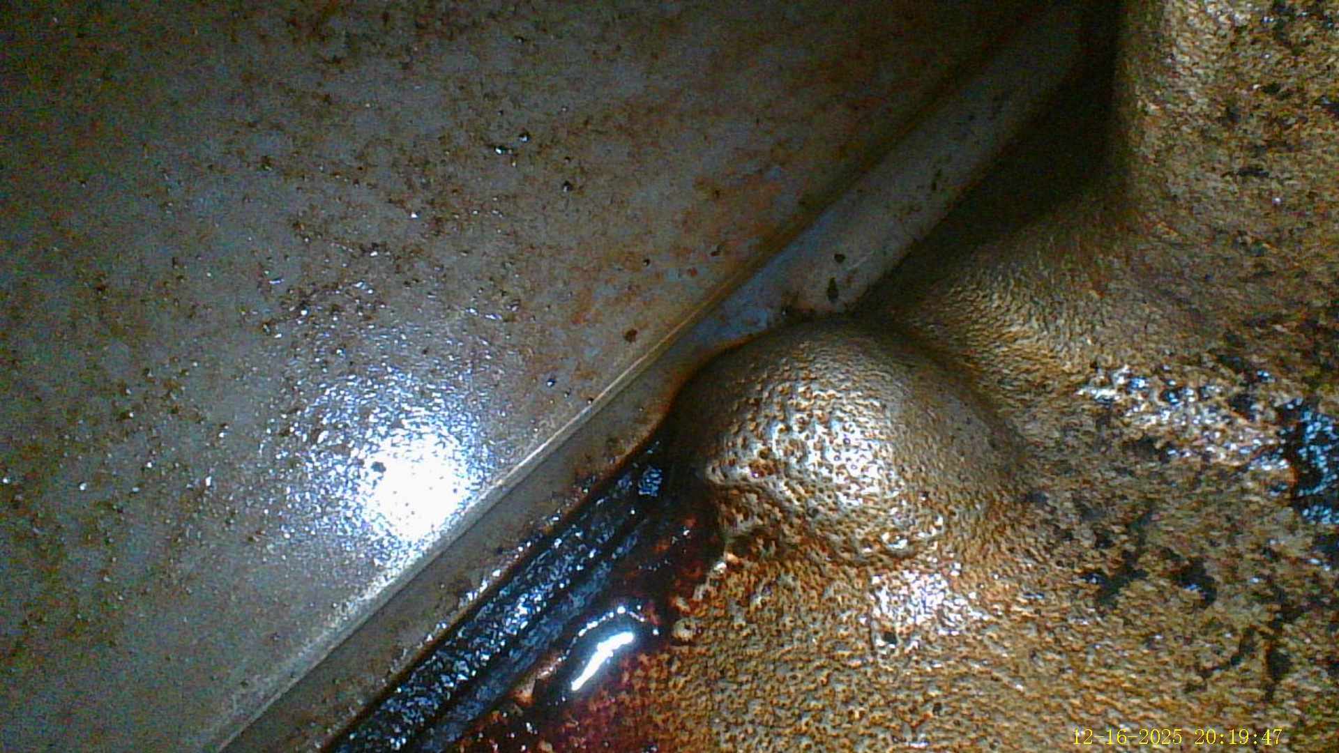

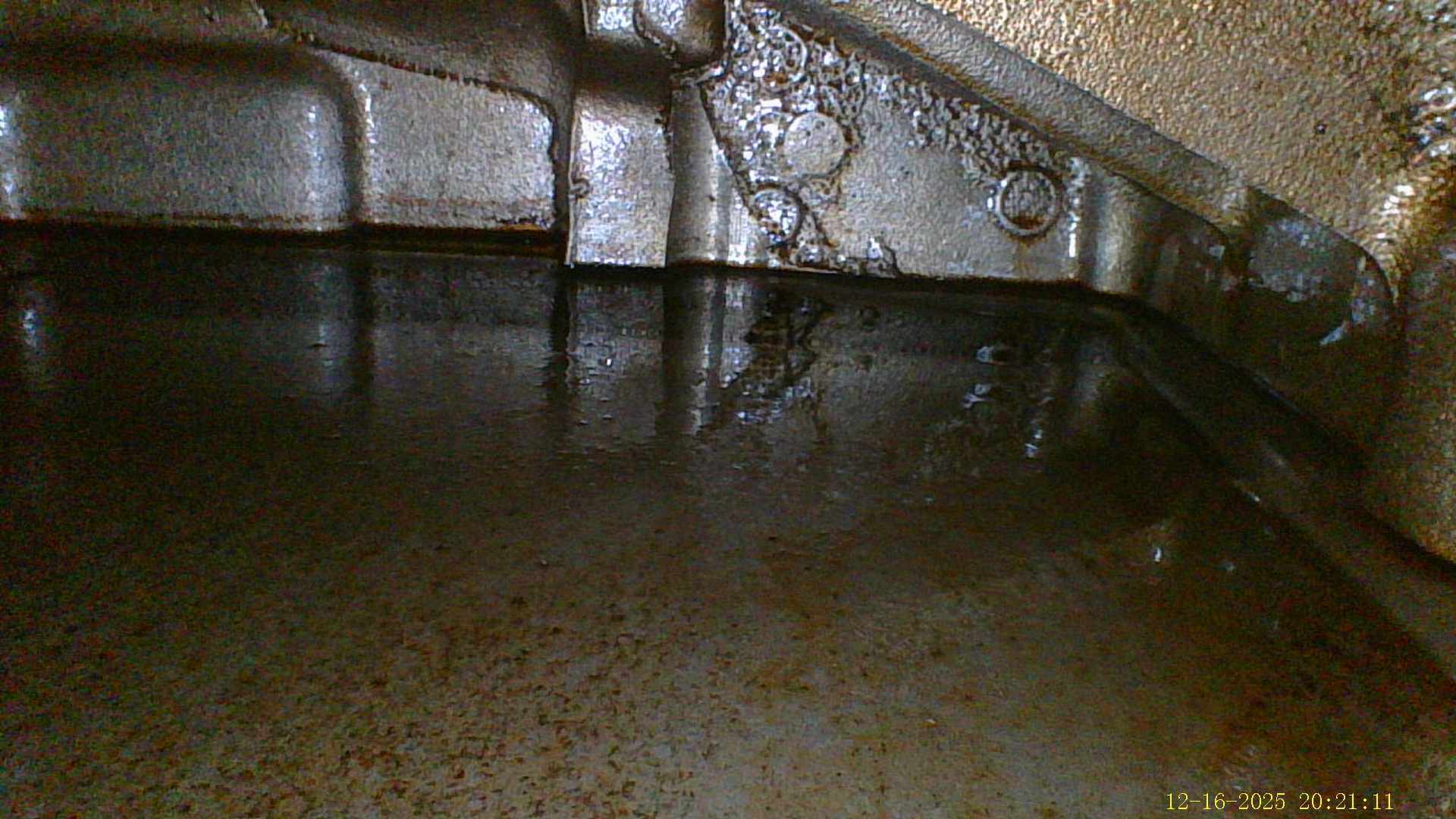

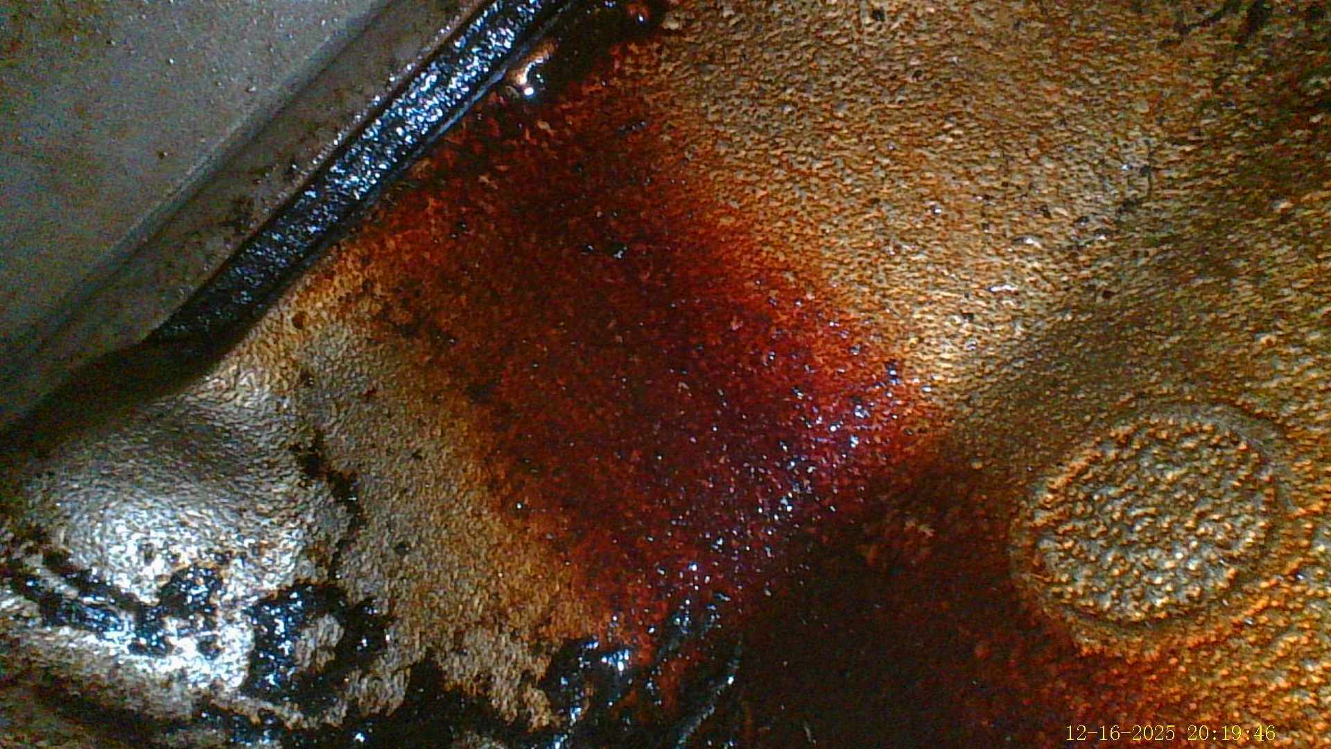

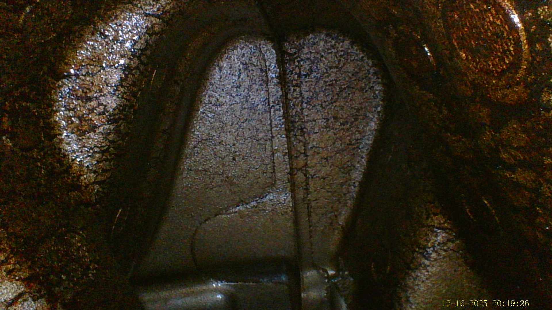

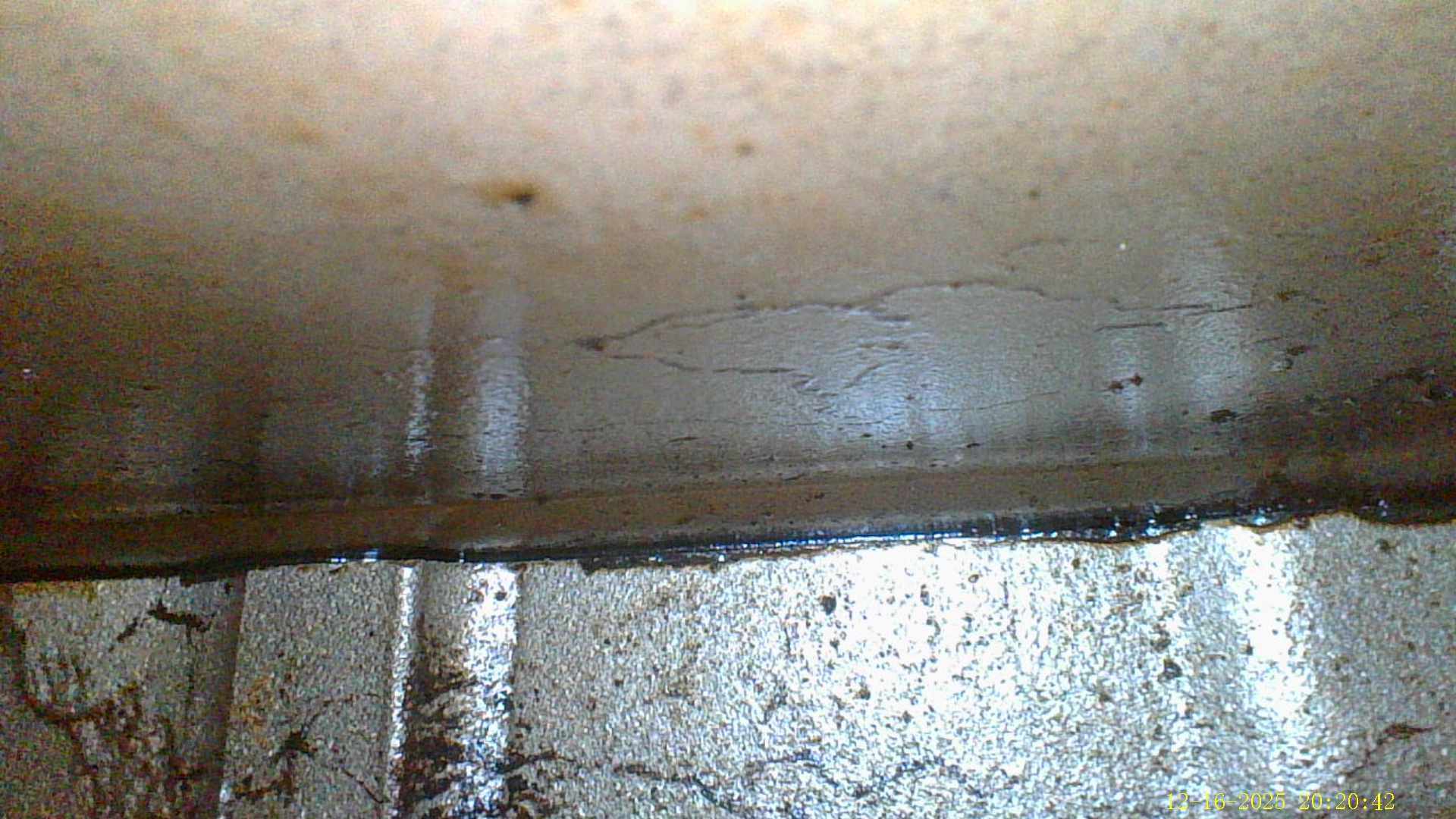

getting major oil loss and marbles in a can noise
Old Jan 16, 2026 | 08:52 AM
Posts: 87,399
Likes: 4,213
Yup. Time to pull it and reseal it.

Got around to pulling the intake manifold off. Gasket doesn’t look blown out or anything.
3 bolts broke off in the head.. only could get 2 out so removed head and took to a machine shop to get it out and resurface it.spent >8 hrs welding, drilling(breaking tons of bits), using extractors(1 of which broke off in the bolt that’s stuck in the head). Just waiting to hear back if they can get it out or not.
I hope I didn’t do all this for nothing…
When I pulled my intake, it looked okay but the bottom of the plenum was definitely blown out. Someone had been in there before and some of the bolts were (barely) finger tight and other needed a cheater pipe to break them loose. I had to drill one bolt out and use a heli-coil in it. That's why it took 2 1/2 to 3 months instead of the 2 weeks I expected.
