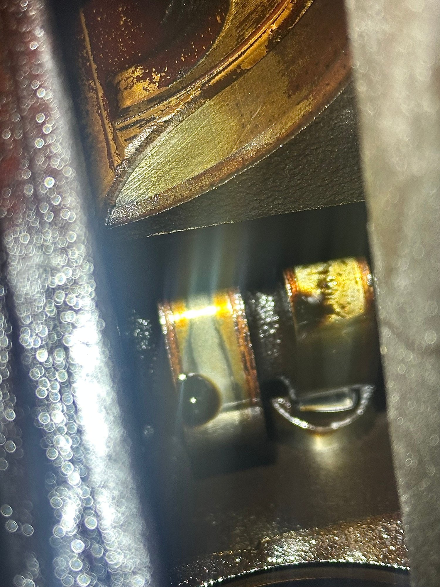

so after doing a pan gasket replacement I noticed what appears to be scaring on my cam shaft.
assuming that I need to do replacement. I would like some recommendations for upgrading

Is (was?) your valvetrain noisy?

I do feel that it’s making more of a tick than usual
But I definitely would like to try to get this done before issues make it worse

Maybe I'm not as easily concerned, but I'm having a hard time seeing anything of concern in your pictures

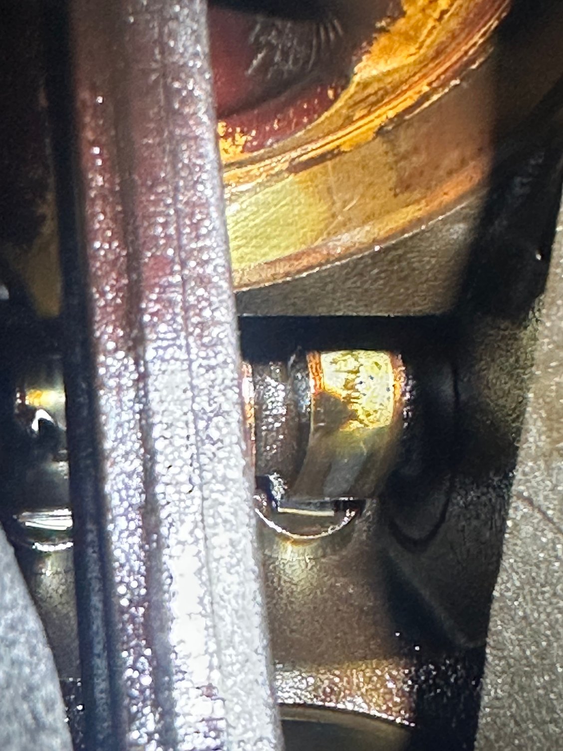

One of the main things that caused me concerned was the scarring on the camshaft lobe as shown on the right in the picture

I understand now, the reflection threw me off as just oil residue, there is some flaking on the peak of the lobe in question?
