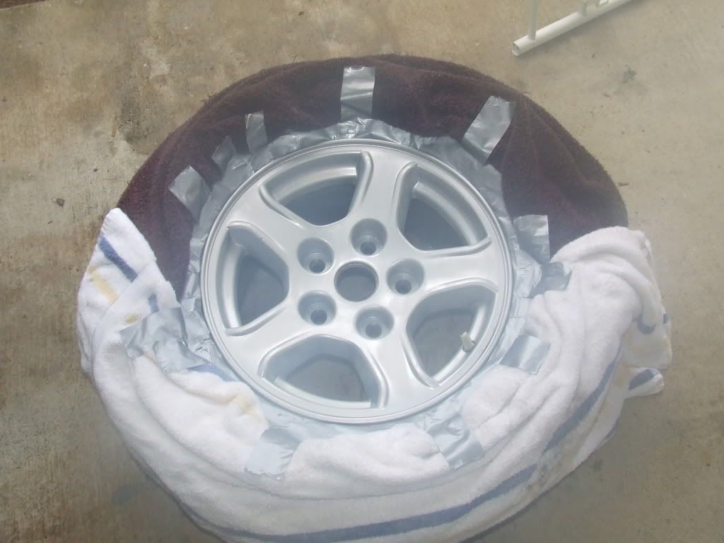

5. Mask off each wheel using the masking tape and newspaper (I actually used towels, much easier to manuever and tape down). Another approach is to use wal-mart bags instead of newspaper. Don't forget to tape off the valve stem as well! http://i236.photobucket.com/albums/f...y/DSCF8218.jpg
