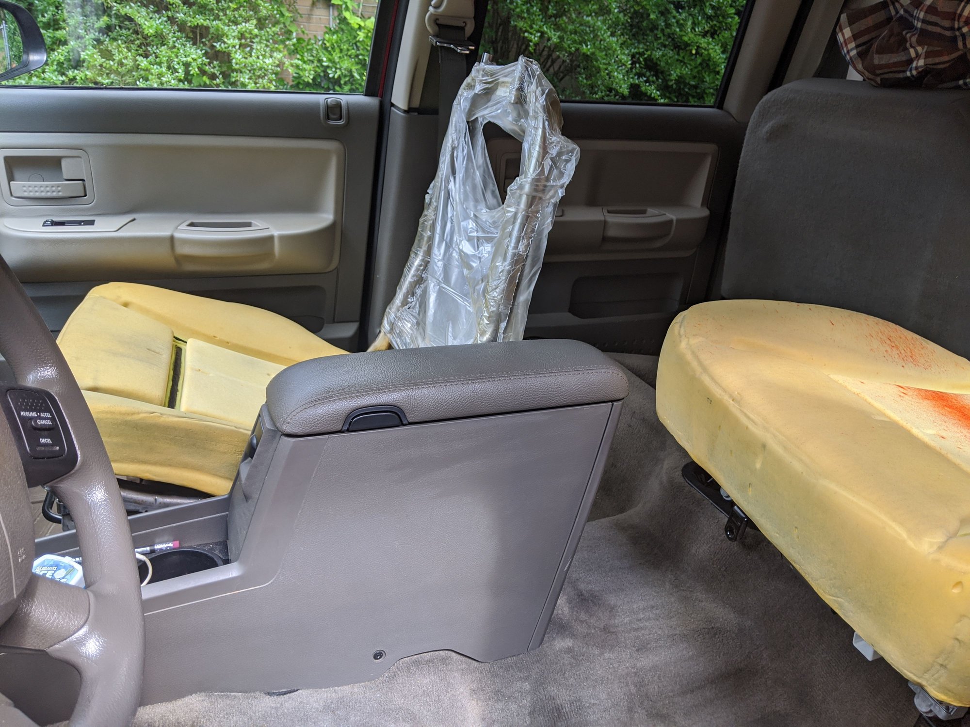

Oh, thanks for the picture with the driver's seat removed. Good to see how the later ('08-11) console sits on the floor. Looks like I have two options:
1) Find someone with bucket seats that wants to trade for my bench seat.
2) Cut the brackets like Dakotaff did when I can find a console at a reasonable price. (not $200)
