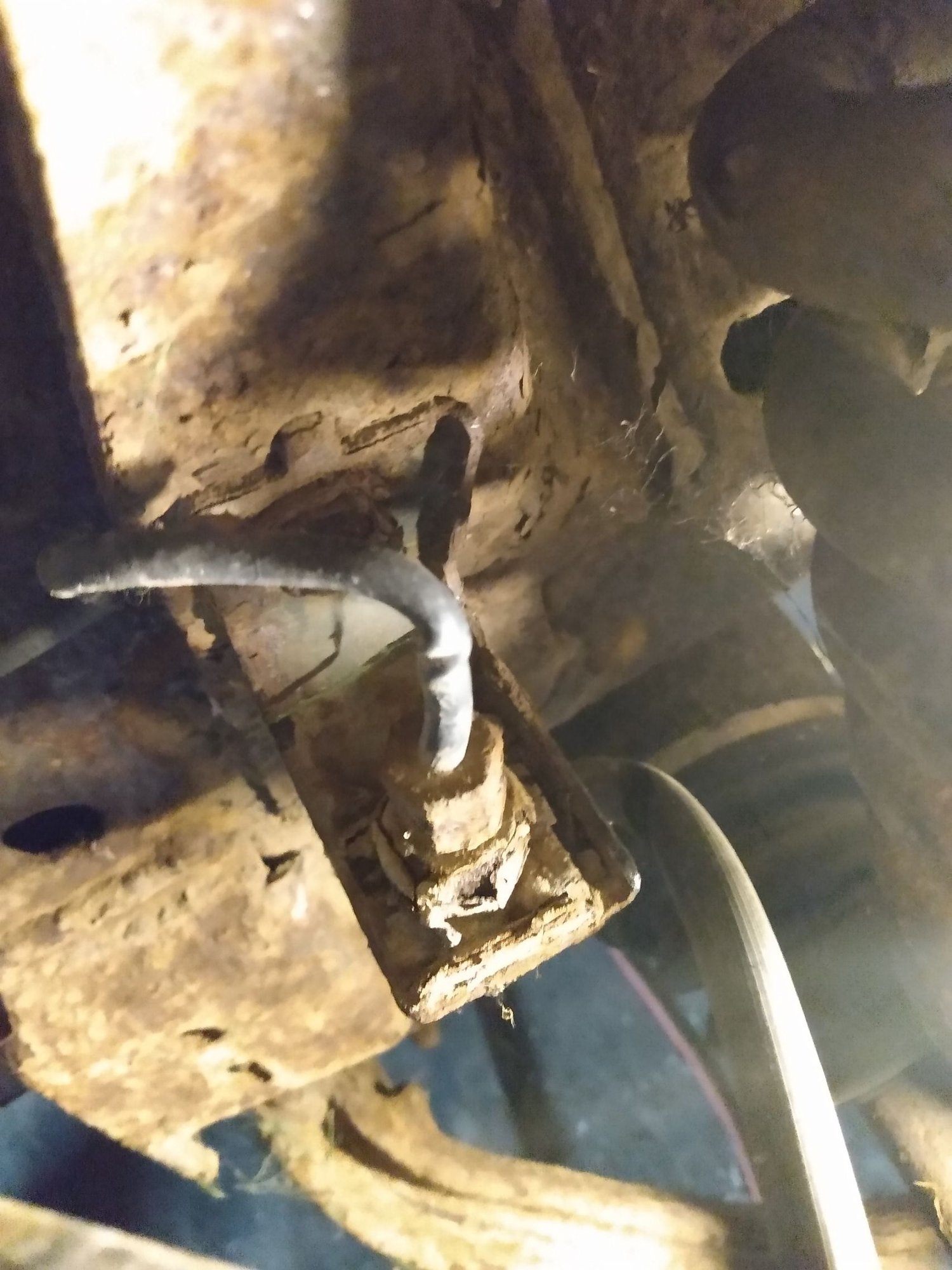

Well Thanksgiving with the family is over. I spent most of the time playing with the brakes on the Dakota.
Here's the skinny. The last owner fancied himself as a 'mechanic'. He installed the RF Caliper with a severe twist in the brake hose. That indentation you can see with the hose, would be where it was rubbing into the mounting bracket. I actually removed the caliper and flipped it back to the correct position and it aligned up 100% correct. He had to have forced the caliper onto the mount for it to get such a severe kink. The hose is worn almost to the inner workings.
Before anyone comments? The frame is coated in crust. Welcome to upstate NY!! The frame is pretty solid, just covered in surface rust and crust. Before this hits the road, it will get a complete wash down with 'Fluid Film Black'. We use it on all our cars and my Journey once a year to keep the rust at bay. (It won't stop it, but does slow it down.)
Both caliper's of course didn't care for the bleeder screws being tampered with. And they snapped clean off. I'm actually okay with that. Both calipers are very crusty and didn't respond with my attempt to push the pistons back into the caliper. The donor Dakota in the scrap yard has 2 new calipers. So if they are still there on Sunday? We're going to do some shopping... The front faces of the rotors look great, but the rear of the rotors are crap. About 30% usable surface and the rest is crust. The LF caliper didn't have any anti rattle clips for the pads, and the ends of the pads where broken off the steel backing. The RF did have anti rattle clips, but severely rust seized in the bracket. I'll have to see what can be recycled and what needs to be 'new'. (yes, pads and shoes will be new, along with all hardware)
Any hints on how to get the rotors off? I nailed 'em both with my small sledge hammer. (We call it "Thor Junior") Didn't budge. I put a chisel between the RF rotor and the caliper bracket and gave it a few swipes. No movement. Currently both rotors are soaking in PB blaster in the hopes it brakes down some of the rust. I'll probably have to apply some heat to the rotor face to see if that helps brake the rust bond.
Rear brake wheel cylinders are going to be here probably on Saturday. We're making solid progress, but the conditions of the brakes have me concerned. Planning on doing a rear brake job as well. My inspection was only on the RR side. (The LR side is sticking out of the work area against the brace for the garage door, so no access until I spin it around). That inspection showed brake shoes down to about 30% and the wheel cylinder is leaky. Another reason I attempted to get the front bleeders open up. Planning on a flush and refill of the brake fluid once all is tended to. As noted we'll be reusing the rear brake drums after I clean things up. Heat glazed... But looks like it will clean up with some scuffing.

Had to spin my head around to try and figure out the orientation - is that the actual brake line that is kinked? Or just the flexible hose? Either way, she looks a little pooched.
You could take the bearing off and replace both it and the rotor at the same time. Odds are if you have to wail away on the rotorb, the hub/bearing is taking a lot of the shock loads. You'd need 1 32mm axle nut socket for the half shaft, and then the 3 19mm bolts to pop er off.
The other option is just to keep tenderizing the rotor. Mine required a couple righteous swings of a 5lb sledge many moons ago. I have an air hammer these days, which makes life sooooo much easier.
