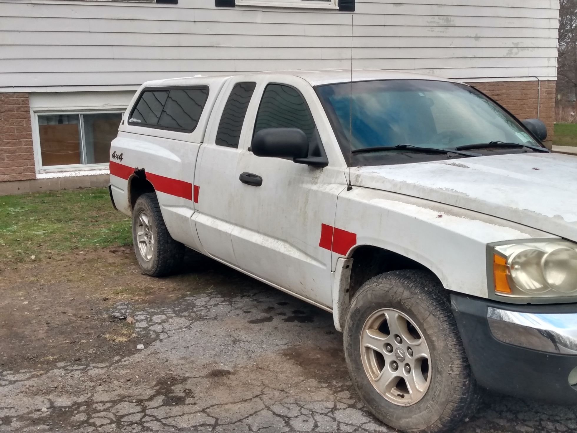

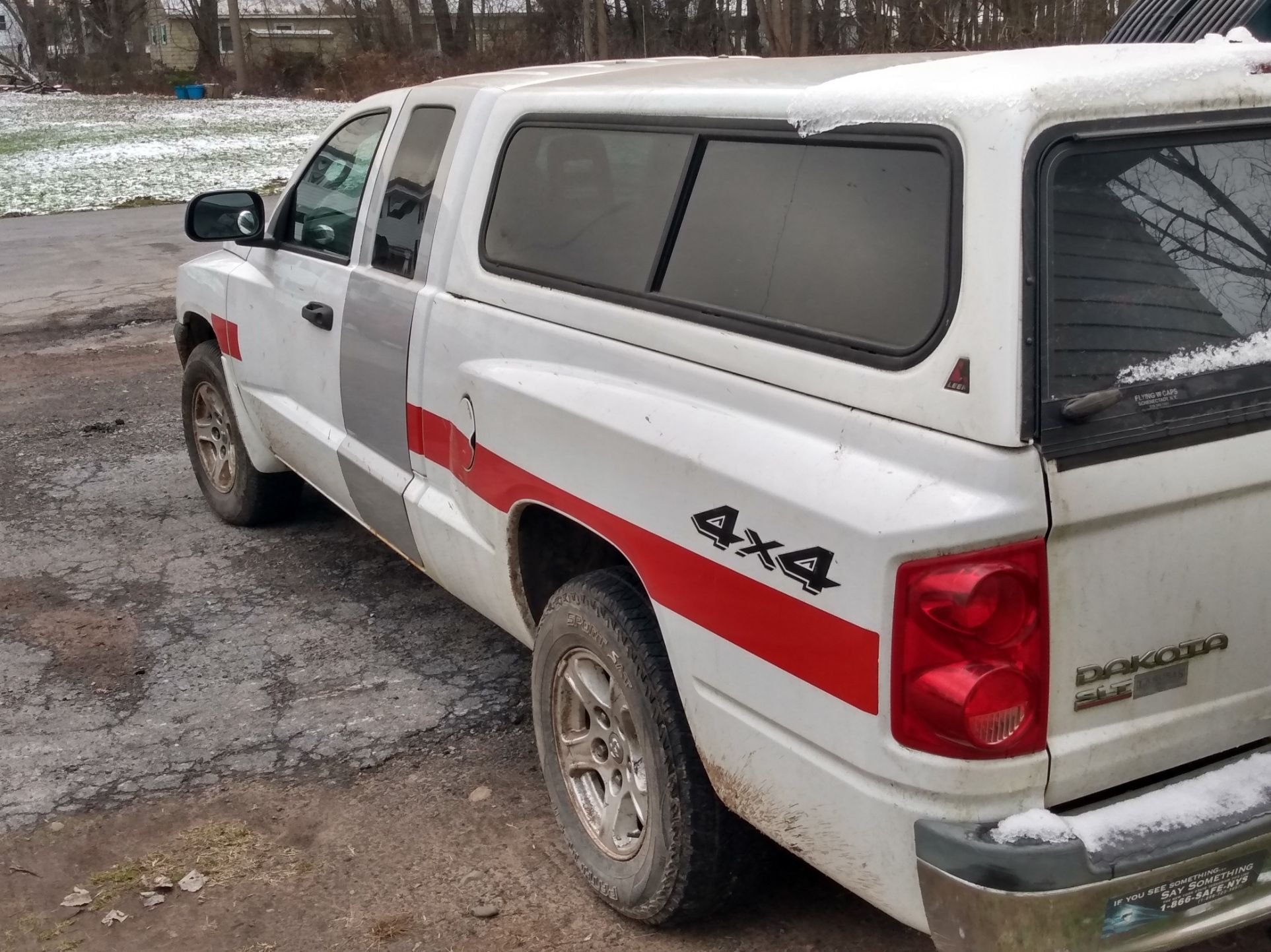

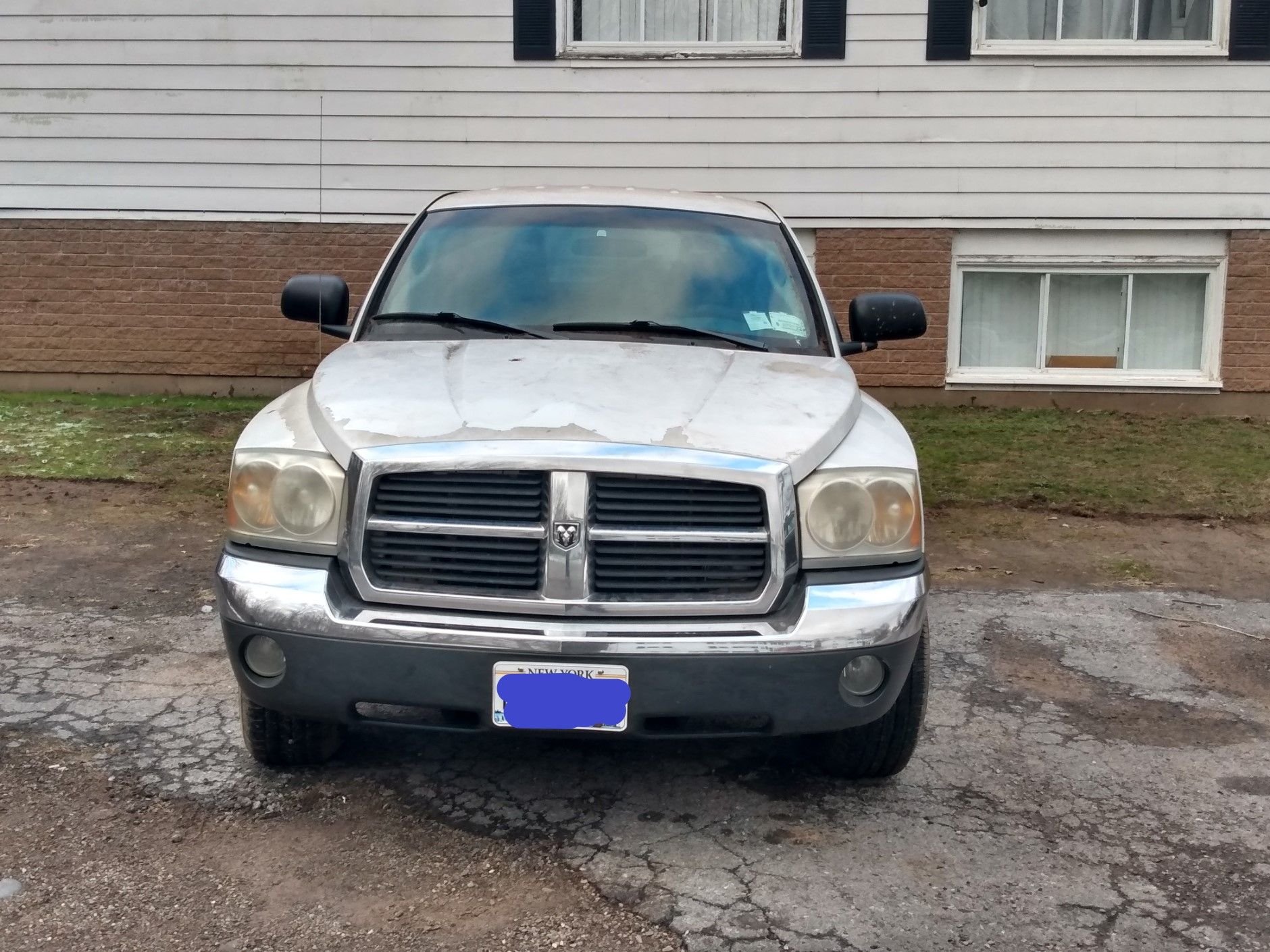

I figured it was time for people to see what the wife and I have been working on. The tires and windshield will be done tomorrow (Wednesday). I'd love to know of any good sources for the red reflective tape the fire dept used on the doors/fenders. I'd love to re-add the missing sections where the fire dept removed them as well the main decals. (not the logo or such, just the red reflective tape) As for the small wing door on the left side- That one was pretty rotted away at the lower 9" mark. Not sure why most of them give out in that same area, but most I've seen in the upstate NY area are like that.
And yes, the ol' girl really needs a severe bath. It sat for so long most of that dirt and 'green crusty' is stuck on. The wife's car was the same way ('88 TurboCoupe that sat for 6 years before we brought it back to life)
The NYSI will be next week. That should give a few extra days to get that brake light figured out and to double check the basics.

Coming along...great work!
Do a Google search for "red reflective tape for emergency vehicles". Came up with a bunch of possible sources, including Amazon.

Check the Yellow pages for a fire and safety supply company. When I was the motor officer for the police unit I was in, I sourced a lot of cool stuff. I even was able to get parts for a Signal Corp. Model 78AR siren. It came off our '59 Plymouth wagon when it was surplussed. It was so loud it would vibrate ***** and handles off the inside when we ran at speed for a while.
