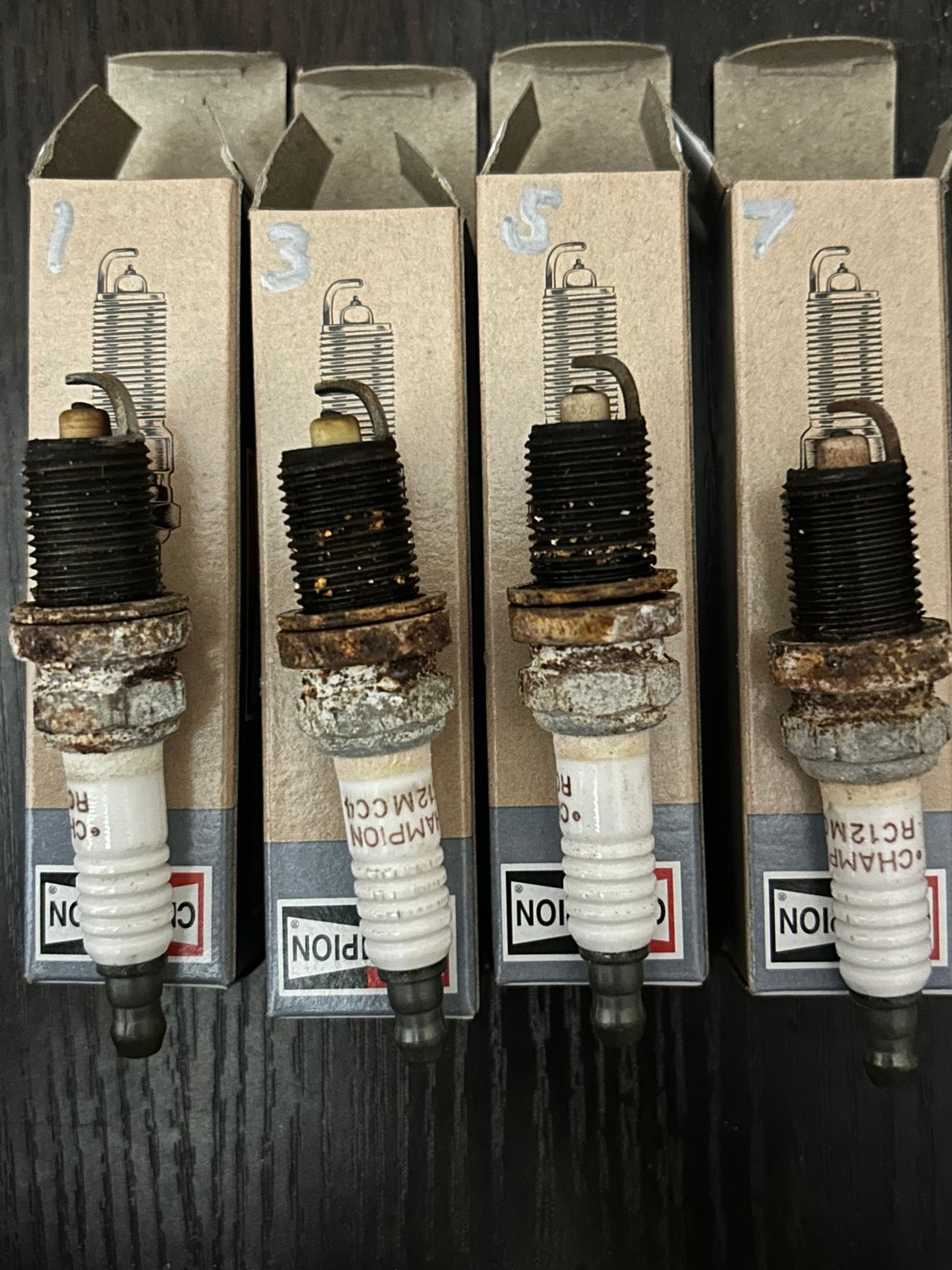

May 05 Dakota 4.7 is giving a P0172 code. I’ve replaced the PCV Valve, all 8 injectors and Plugs. It still falls flat on its face when under acceleration. I’m at a loss of what to check next. Any suggestions would be greatly appreciated.

How old are the O2 sensors? What did the plugs look like? Especially those on the effected side.

They were in bad shape. I believe they are the factory O2 Sensors

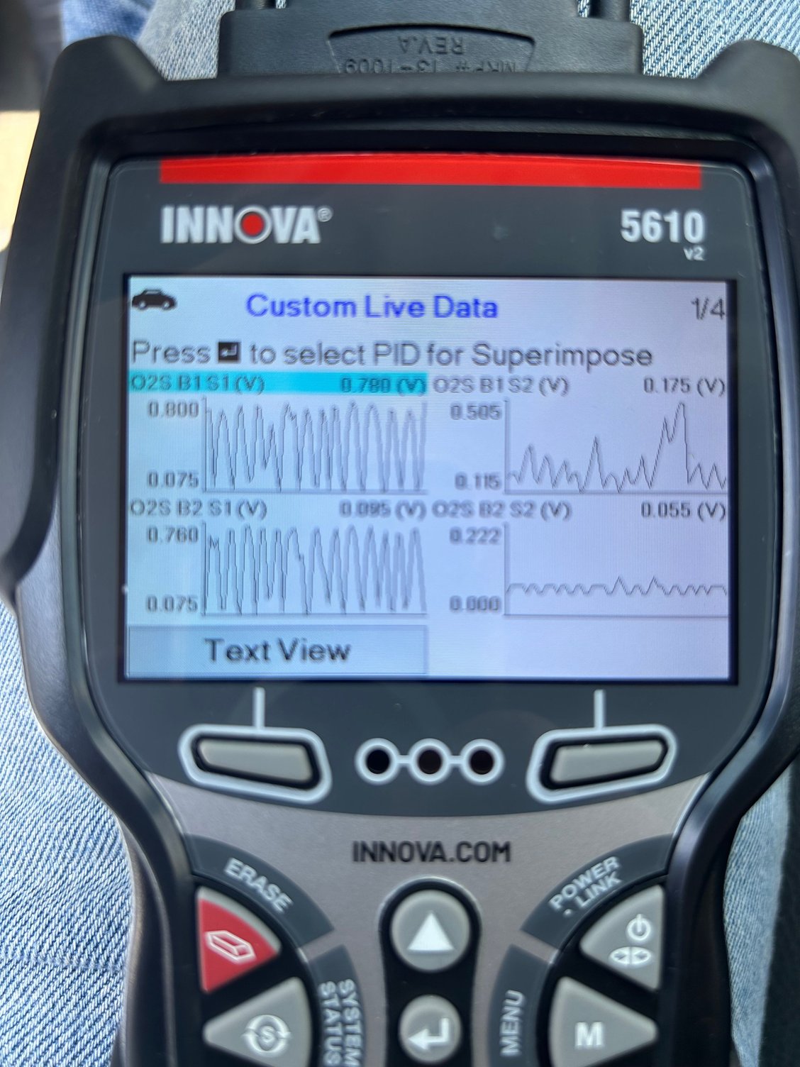

Is this a good O2 Sensor read
ing
Old Jul 6, 2025 | 09:34 AM
Posts: 87,465
Likes: 4,220
Rear sensors are not reading even close to the same there..... Does yours have dual cats??
Old Jul 6, 2025 | 11:17 AM
jmc0281x's Avatar
jmc0281x
Joined: Jun 2025
Posts: 5
It has dual cats.
Old Jul 6, 2025 | 12:17 PM
Posts: 87,465
Likes: 4,220
Hhhmmm.... So, possibly a bad sensor, or maybe an inefficient cat..... The front sensors appear to be reading just fine though...... Could try replacing the rear O2 sensor on bank 1..... Don't know if that will fix it though. Will your scanner show what it thinks the mixture ratio is??
