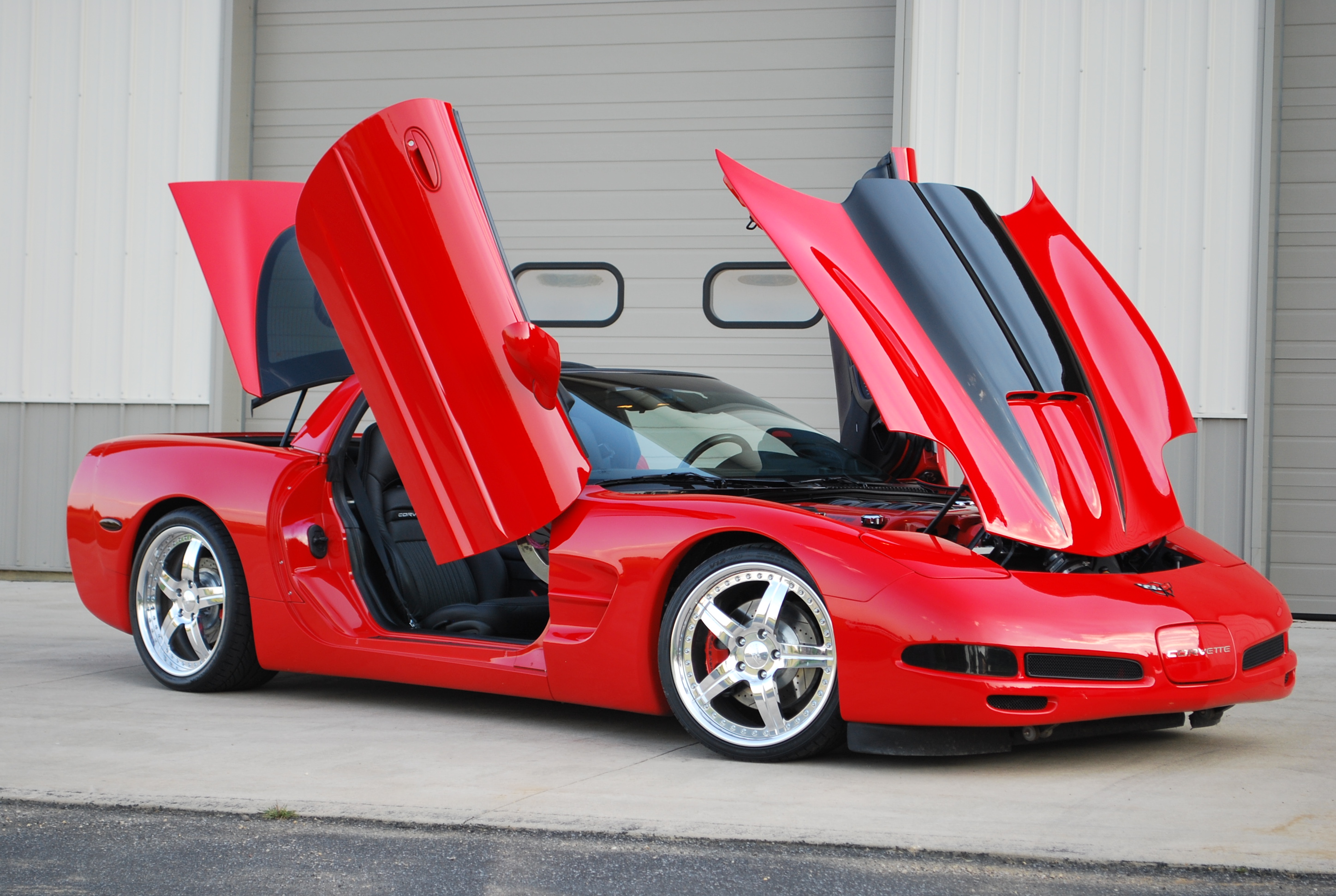

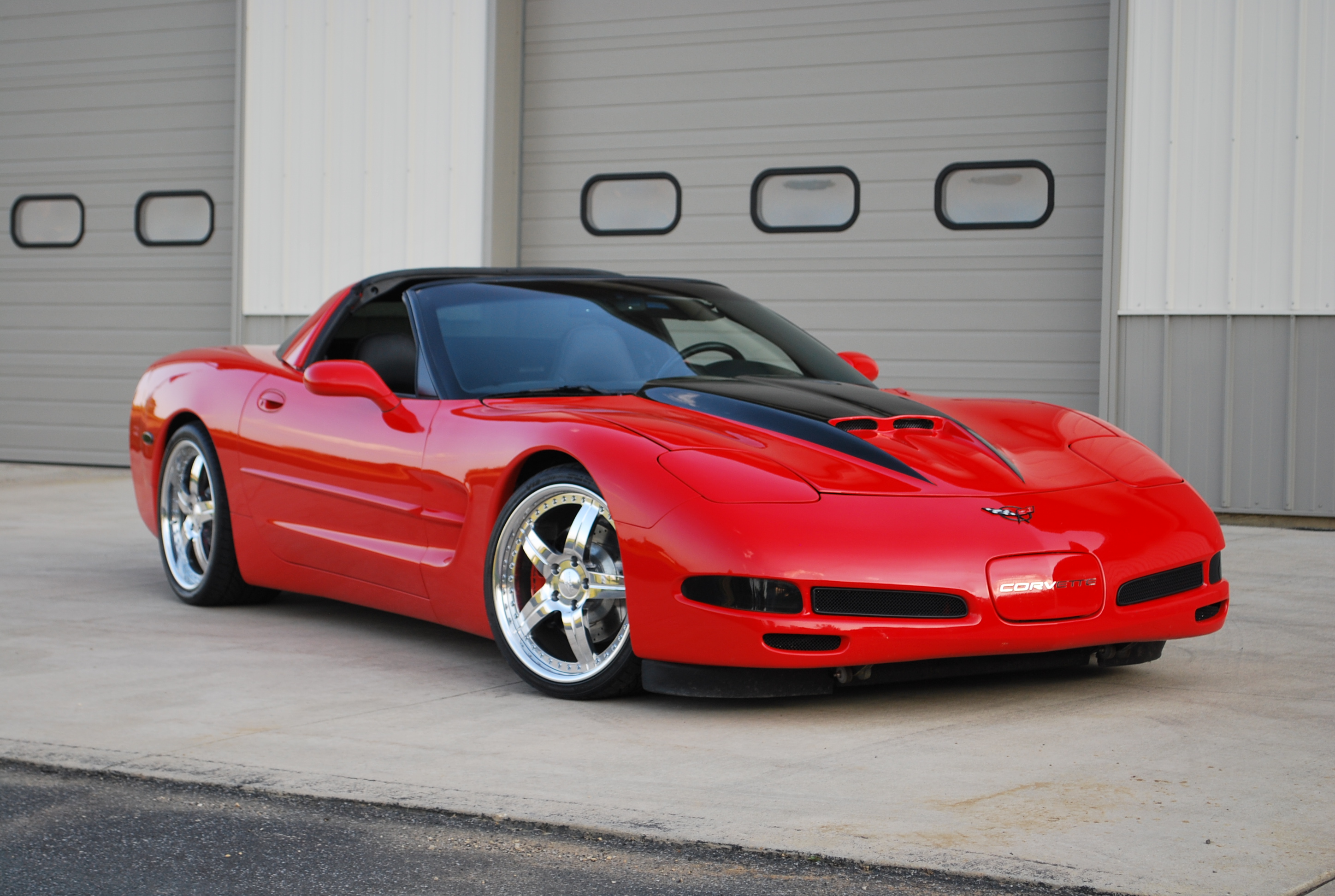

Double D Mods's Avatar
Double D Mods
Former Vendor
Joined: Dec 2010
Posts: 419
From: Kieler, Wi.
clay bar
porter cable
with 3M Ultrafina and a blue pad
Pinnacle Souverane and a polishing pad
microfiber towel to wipe down
Best combo.
The Pinnacle Souveran is the best wax I have ever used. Its awesome on darer colored cars. Its usually about 95.00 a jar but if you catch it on sale you can score one for about 65.00
Here is the results with my Torch Red Vette
