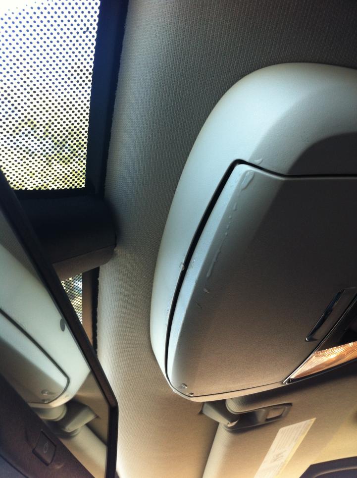

Hey all. I just wanted to inform you all in case you have this problem. After a rain storm or driving in heavy rain I am starting to see drips of water accumulating and falling from the Sunglass holder on the ceiling! It's not much water but enough to drip 5-10 drops after a rain. The water is obviously getting in the body of the ceiling.
This is happening on a 2012 Citadel with sunroof that has less than 2000 miles on it. I thought that the sunroof seal might be responsible, but there should be some kind of drain gutter in there for that.
The dealer starts diagnosis today. I will post updates. I have a feeling this is going to be a cat and mouse game that leads to a lemon. Water through the Sunglass holder???????

Ok got it back from Dealer last night. They dropped the headliner and found the sunroof drain system weep tube needed "adjustment". Lol. In other words a clogged drain tube for the sunroof right from the factory as Venom(above) mentioned. Of course I did not see this done, so only time will tell if it's fixed for sure. I'm not digging the fingerprints on my headliner now though! Hopefully it cleans up.

Old Jun 15, 2012 | 05:19 PM
440sixpack's Avatar
440sixpack
Joined: Nov 2011
Posts: 40
From: SF Bay Area
I did happen to get a pic of it last time too, so people can see the location...
