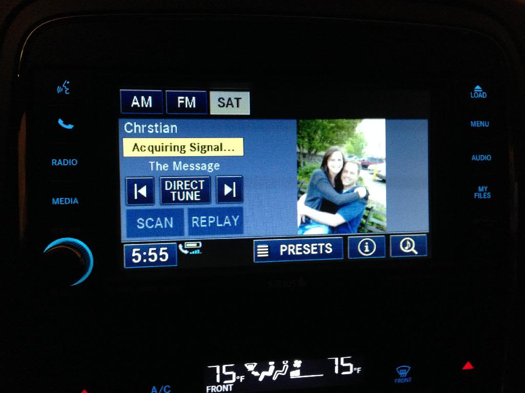

Originally Posted by salrt
OK, so I am already running the 33 software. I burned the 50 from the site onto a disk and my system goes to disk and says "Data". The .iso file looks like it is a Zip file. Do I need to run winZip on the .iso file and unpack it prior to burning it then put it in? When I do unZip the file, there are three folders "Garmin, PICTURE and TLDB" and lots of other files. No .exe files though...
Yes it needs to be unpacked. From everything I have read on the Jeep website with *Sox*, you should update the Garmin first then update. Or if you don't have the updates, download both the 33 file and the 50 file and if need be, "downgrade" to 33, update, then go back to 50. Too as I stated above make sure your radio is in sync with the satellites while doing the upgrade(not in your garage). Be patient and when it asks to upgrade the HDD say yes.
http://www.jeepgarage.org/f155/new-a...7-a-64711.html
Chris
Btw, I went from 22?, I noticed substantially improved speed in regards to the rear camera, the ability to add delay, better sound and better looks and connectivity and music playback with my iPhone 5.
