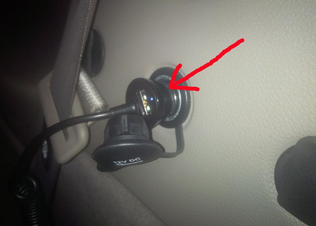

I put my theory through some tests last night and my 'theory' just doesn't stand up to my results. love the Scientific Method.
I do not think I have an issue with Remote Start per se, the Power Outlet #2 (storage bin) and Power Outlet #3 (rear hatch -pic below) ARE receiving power during Remote Start operation.
I think what I have here fits right in line with Jason's (at Vertical Visions) comments. he says sometimes the M7 circuit does not receive power during Start Up and he can't exactly explain why. and by 'sometimes' he means from vehicle to vehicle, not from one start to another.
my M7 circuit is getting power during Remote Start operation right along with my circuit for Power Outlet #3 (rear hatch -in pic). the issue seems to be the actual start up process.
when using Remote Start, the fuel pump will kick on and the engine will fire. but then it sputters and dies. so the M7 circuit gets power initially, it just seems to be cutting out during Start Up.
