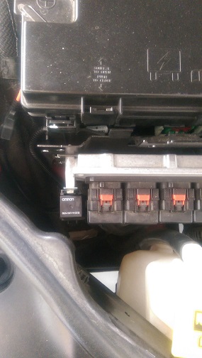

The fuel pump relay they will add for the R09 is usually placed in a dumb spot and pretty flimsy. I moved mine to a more secure location. They used a plastic push thingy that barely held it in place. I'll take pics soon to show where I moved it using existing hardware.

I'm with hellomoto_25. I didn't like the plastic clip they used to attach the relay. So I moved it less than 3 inches to where IT SHOULD have been attached. It took an 8mm socket and about 5 minutes of time. Attached a pic.

Great info on the relay. Thanks
