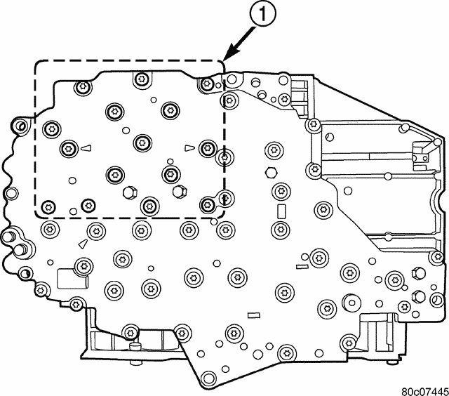

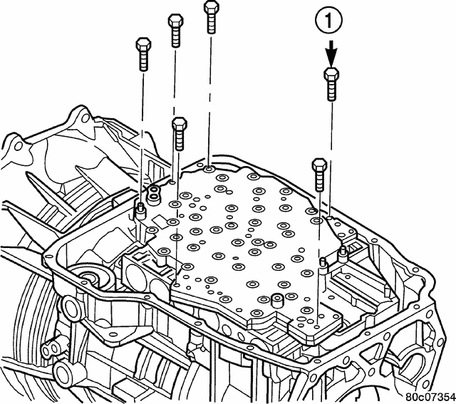

with the p0750 code which in Chrysler manual is P0750-LR SOLENOID CIRCUIT if it was in my shop I would be putting a solenoid pack in vehicle and both the filters to do this you have to remove the valve body which is only like 8 8mm bolts since you already have the pan off take valve body down then there's a lot of t25 bolts that hold the pack on attached are pictures of the bolts

Thanks Brian. That supports my thoughts.
I already have the valve body out and the solenoid pack seperated. I checked the solenoids with an ohm meter and they check out but I know that's no guarentee that they will actually function. A remanufactured solenoid pack is under $150 so I figure it's a reasonable gamble.

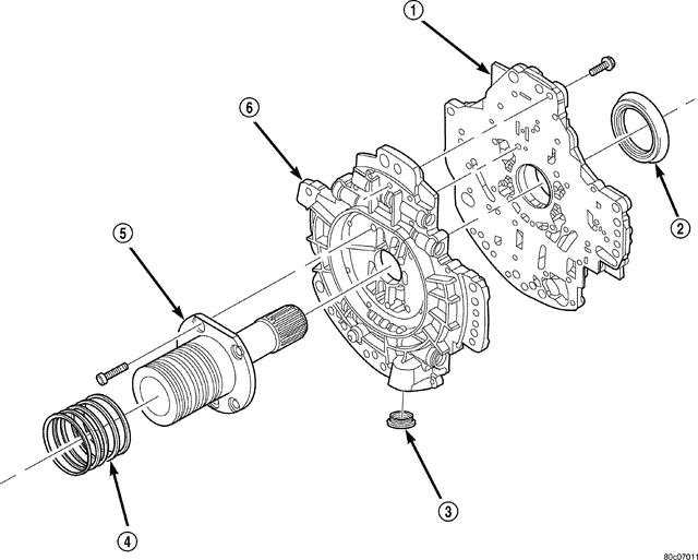

the only thing I am concerned with is the whine when you install the main filter make sure the seal that goes into the pump is securely in place its #3 in the picture if your new filter comes with one don't install it on the filter first install it in the pump first then put your filter in it hope it works out ok for you let me know if it fixes it
