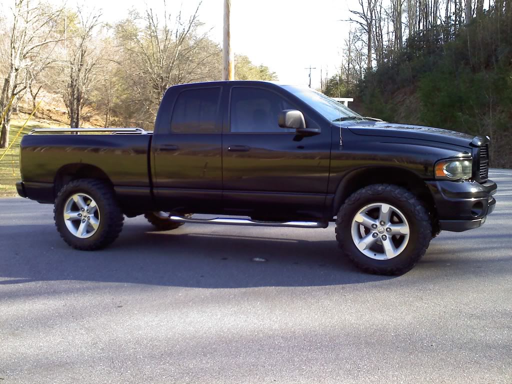

this thread was slipping away so here i will add to it
