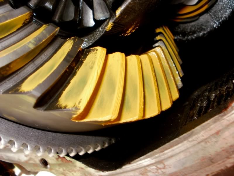

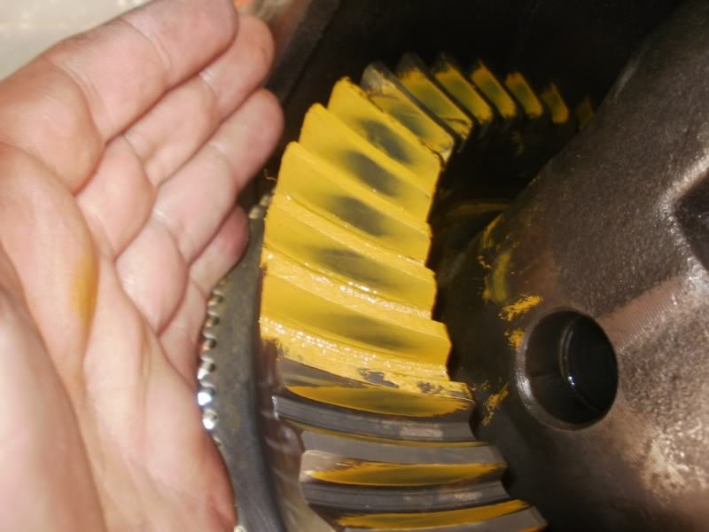

Here are test runs.
0.032 shim (stock)
Seems a bit on the shallow side.

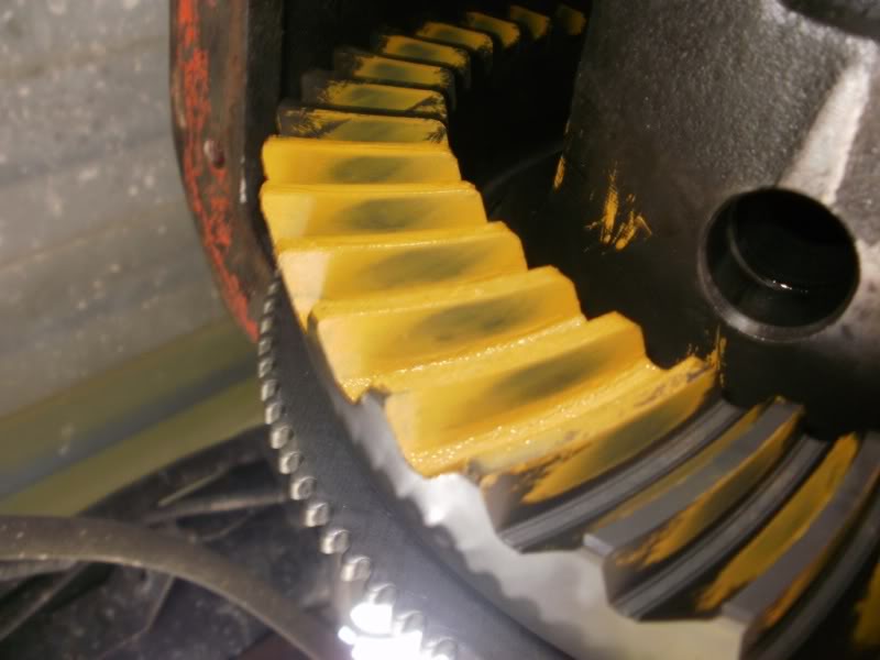

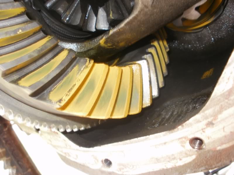

0.035 shim
This one seems a bit better.

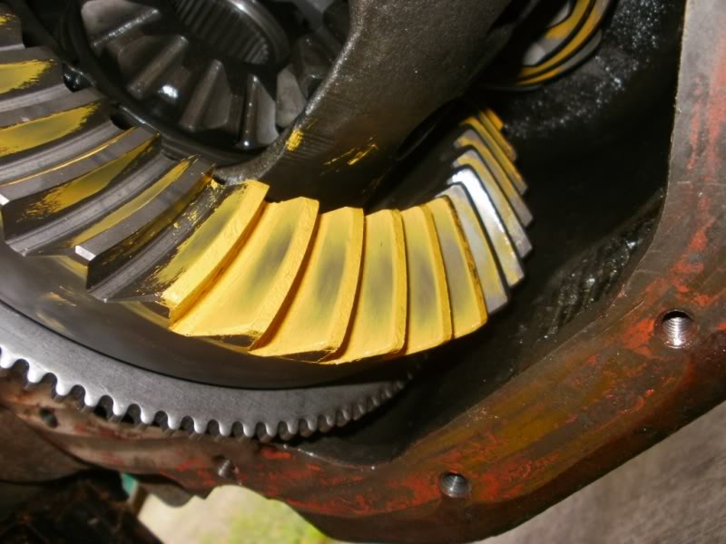

0.037 shim
A tad much on the flank side, I think.

I'll follow up with more pics of the progress, right now just trying to get the test pattern right. Seems to fit the bill going 0.035. The numbers on the head of the pinion stated 2.375 and I measured 2.378 with the stock shim of 0.032 ... going 0.035 makes the most sense to me. Just trying out several measurements before pressing. Test bearings, although a little bit of trial and error, make it much more easier to try new shim measurements. The test patterns are what tells you what you really have.
Old Dec 31, 2010 | 12:36 PM
  #28
chambers's Avatar
chambers
Posts: 1,605
From: VA
Yea 0.035 does look the best of those, but I've never set up gears I'm just going from the patterns shown in the manual and comparing them to yours. Keep us updated.

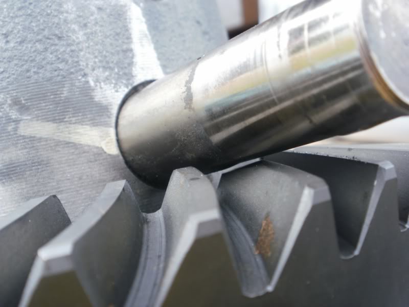

Here's what I had to do to get the shaft in
