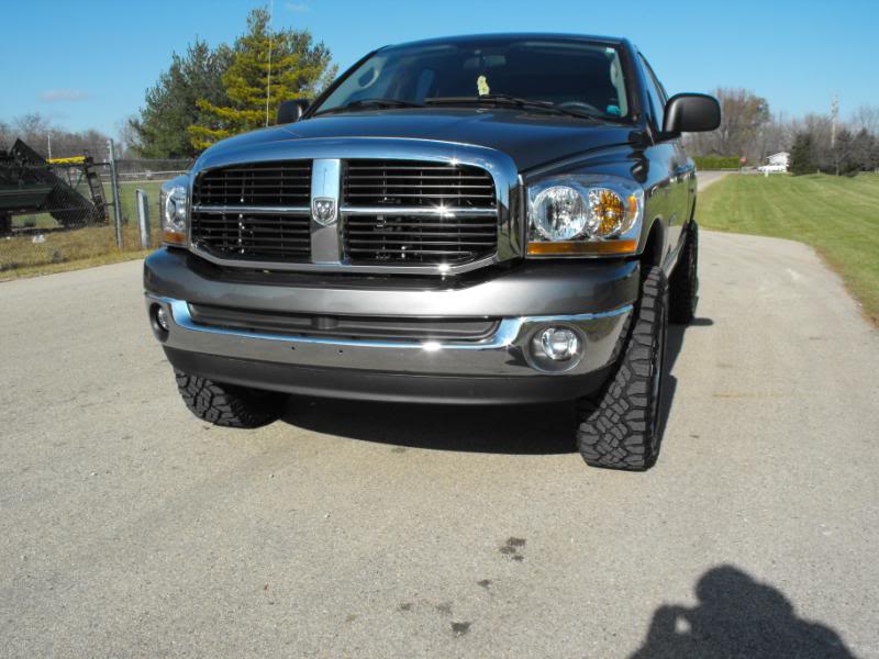

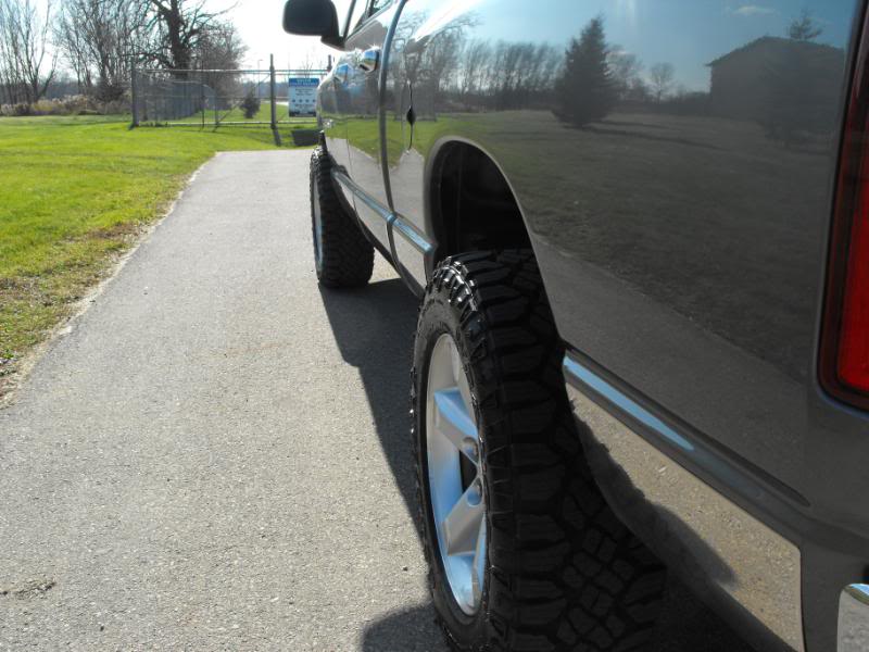

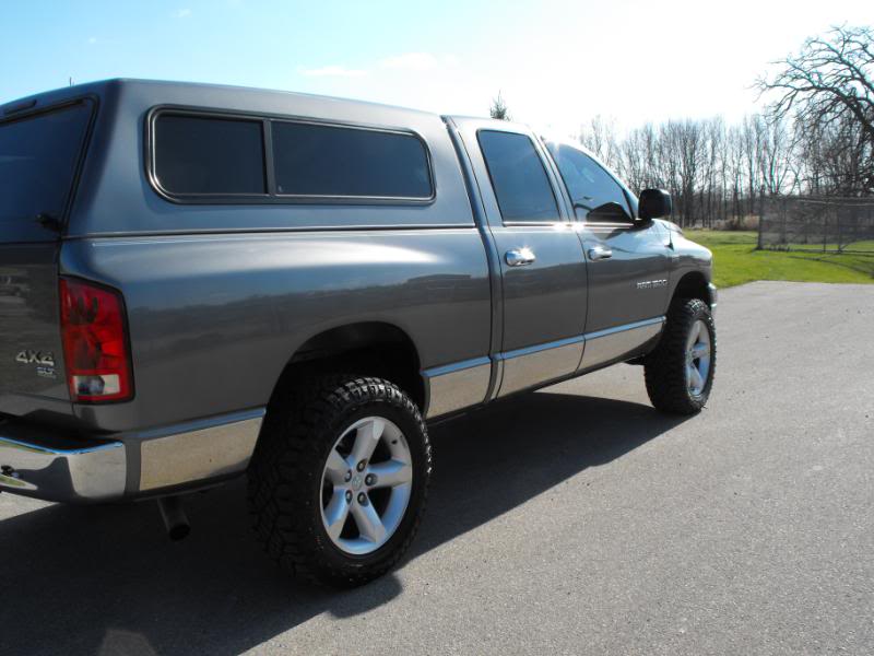

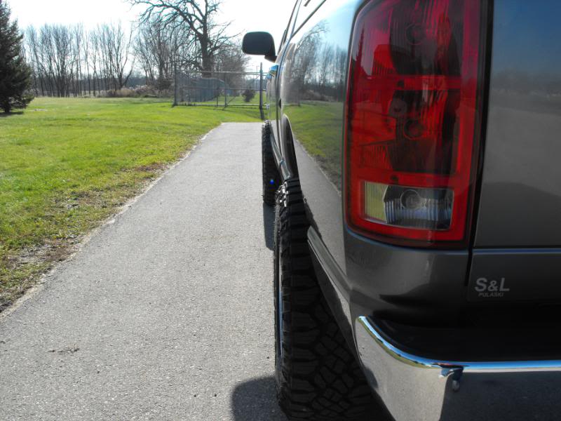

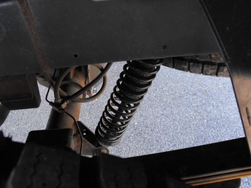

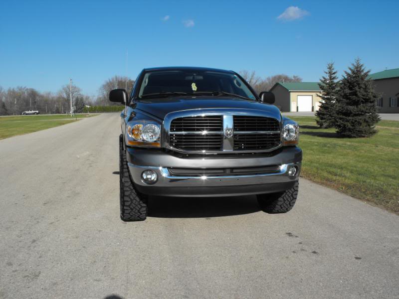

Here is my setup: 2" Bilstein 5100 Leveling strut, 1 1/2" lift Rear Monroe load level coilover, 33.5" tires w/ 1.5" spacers all-around
