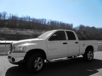

I have a 2" level with stock size tires and yes 275/60/20 is a 33" tire. I did quite a bit of research on the leveling kit to get and was told by many to go with the 2" over the 2 1/2" to avoid the added stress on the IS and CV axles. I love my level and knock on wood have had no issues with it.

Your setup actually looks perfect IMO, I was thinking about the 2.5" top guz kit which also raises the rear 1" and 2.5" front and you are saying that it makes a big impact on the front suspension compared to a 2"? Did you notice any NEGATIVES with the ride or steering wobble with the 2" spacer?(your current setup) Would 35" tires fill in better or would they rub with the 2"

I didn't notice any negatives with my kit. I had been told that the 2 1/2" kit was more stressful on your suspension that the 2" so I went with the 2". There were also a few posts of people that had gotten the 2 1/2" and were either wishing they had gotten the 2" or were actually going to take the 2 1/2" off and go to the 2".
I have also been told that 35" tires will fit fine with the 2" level as far as heigth but you cannot go any wider than 11 1/2" wide without rubbing issues. I was just told by dirtydog that if I wanted to go with the tires I want(305/50/20) that I would need to also get at least 1/4" spacers to go with them to avoid rubbing on the upper control arm. Hope this helps ya out.
