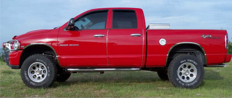

Hammer I think we've talked about body lifts before somewhere. Do me a fovor please, can you post a pic of your truck completely from the side? Not angled but actually looking at the side. I want to see how much room you have in the wheel well/ fender area

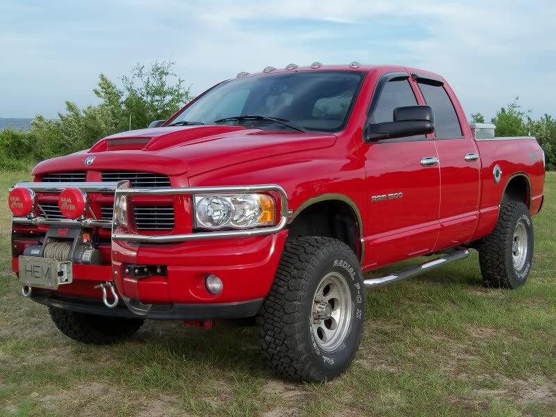

At roughly $400 for a PA 3" body lift I wouldn't call that expensive since the Rancho 4" suspension lift is around $2000 with shocks. I thought seriously about adding a 3" BL some time ago but since I won't put more than 35" tires on an IFS truck and the fact I use my bed a lot, coupled with the fact that because of the winch mounted to the frame a LOT of fabbing would have to be done, I decided to stay right at 4".
This is the same 4" of lift you have with 35"x12.5"X17" tires, although since I'm a torsion front and you're a coil front, the lifts are a bit different:

What I meant is I wouldn't like the bl on my truck cuz I'm not going bigger than 35's. With 7" lift 37's are a have to. Now that I've seen yours I'm happy with how it will look. Anyway while we are in the classroom, what type of differential should I go with? Limited slip or automatic locker? What's the difference between those and my stock diff?
