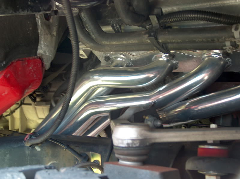

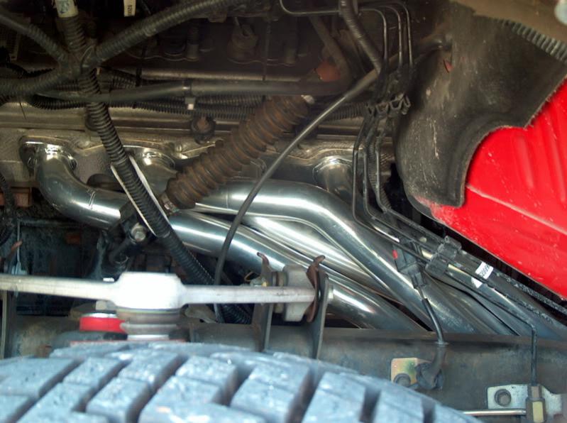

Almost ANY mod needs other mods to reach it's potential. With 4.56 gearing and my other mods, LTs torque curve is plenty low enough. I tow 7800# of tractor, rough cut mower on a 22' trailer with no problem.
For the record Long Tubes, cats retained, O2 sensors in place, pass emissions test:
