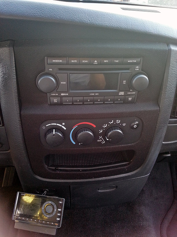

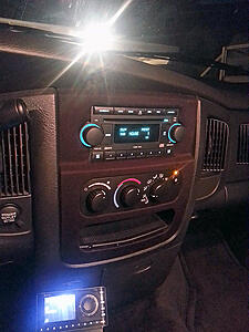

Step 1.) Remove old radio, insert new radio. Verify function. Hack up bezel to accommodate new radio. Cut plastic to fill voids, weld plastic in.

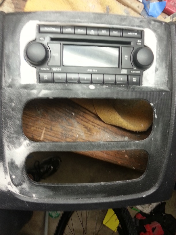

Step 2.) Begin filling with something shapeable. I started with a layer of JB weld to really secure that plastic insert I cut out to the existing bezel. Then I used some Bondo I had sitting around to finish the rest.
(In progress pic. Lots of sanding, filling, and sanding was to come.
Test fit radio..
It fits, yay!
Had to go to work, so I plastidiped it for the day. Looks fugly, I had the full intention of wrapping this and I knew the fabric would cover a million and one sins.

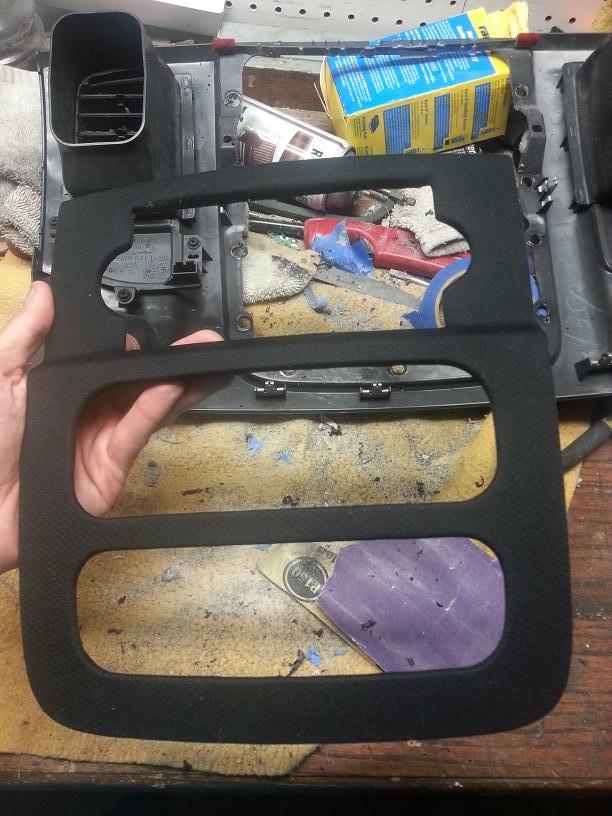

Successfully wrapped. I'm getting better at this.

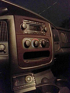

Finally, reinstalled. I'll take some pics during the day after I clean my glue residue up.
I think it looks bitchin, and this radio sounds way better than the old factory one I had. The bass was so dirty it was causing my door speakers to crackle.

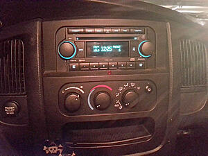

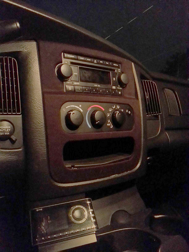

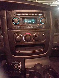

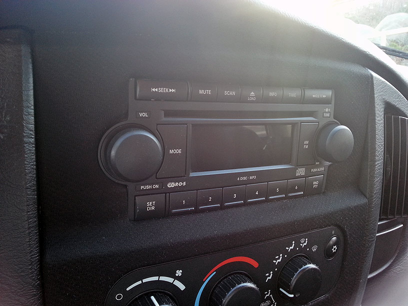

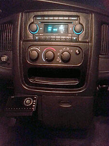

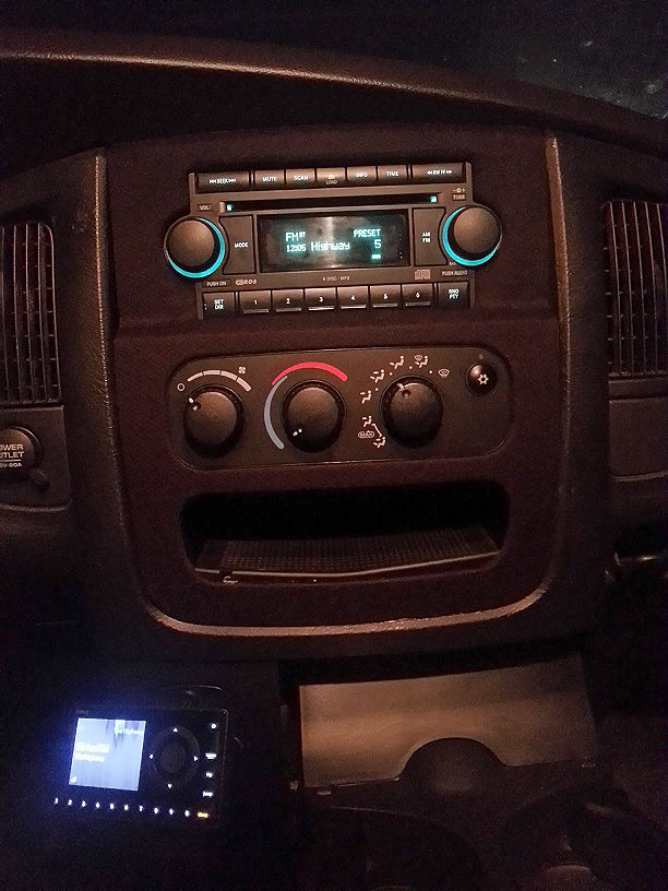

And finally, those day pics I said I'd get. I also cleaned up the excess glue. It's still a little fuzzy tho. I think I need a lint roller.
I'm super happy with the result.

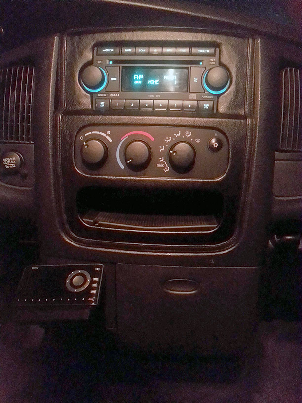

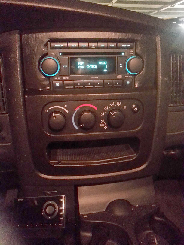

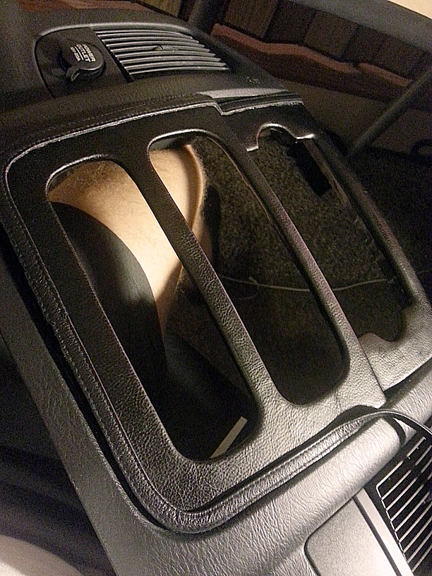

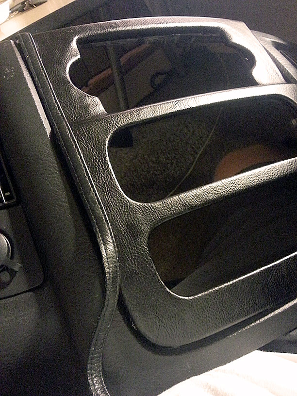

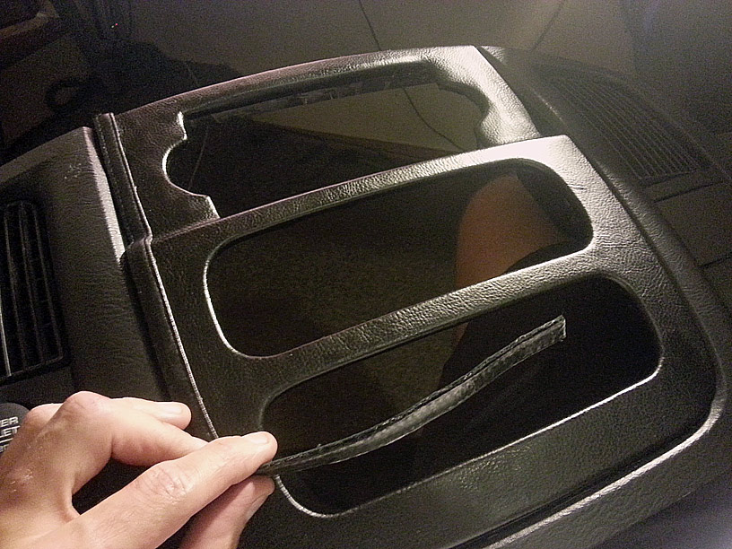

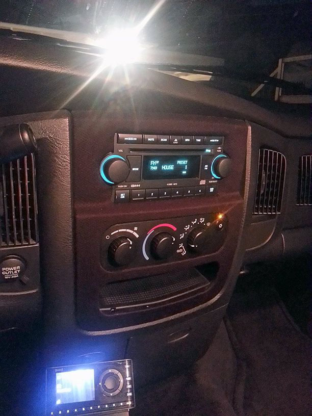

Ok guys... Sorry to keep bumping this. But this is a final update. I liked the original wrap, but it wasn't enough. It looked good, but this truck has leather accents.
So.. I got a little carried away.
I re-wrapped it in leather!
