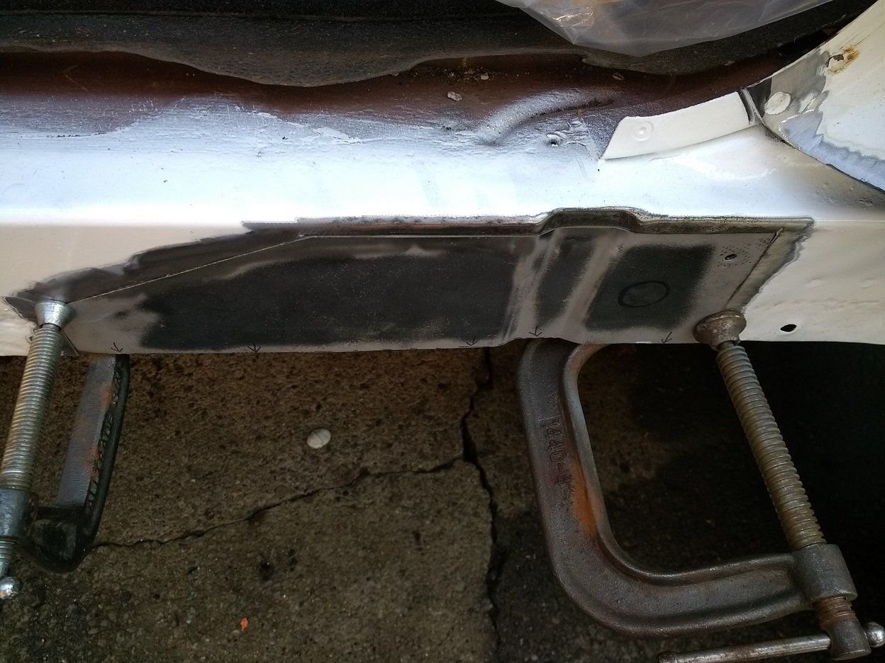

Not sure how the 3rd gen is put together, but the back of the rocker was part of the outer floor on the 2nd gen.
I just cut out the old and made a patch, floor/rocker back was 16 gauge steel - so I had to drop by the steel supply and grab a cut off.
You can check out what I did on this thread for the 2nd gen, might give you some ideas...
https://dodgeforum.com/forum/2nd-gen...placement.html

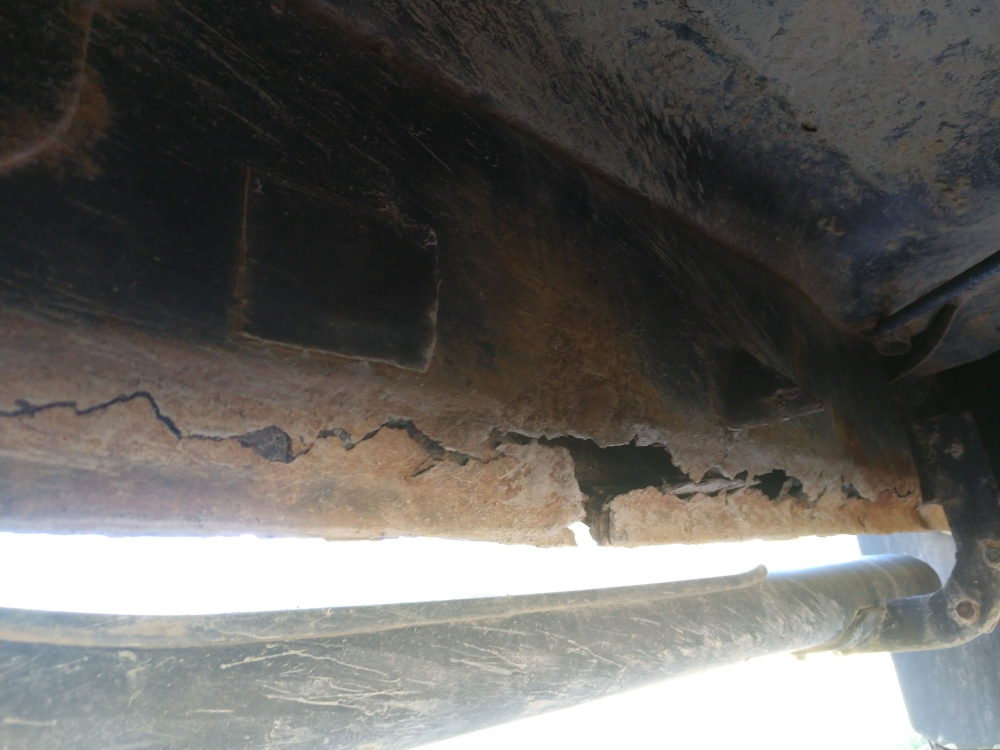

Driver rear cab corner, and rocker. I'll do both sides as well. I'll take the box off, it needs one of those also. Already had the wheel wells fixed, rust came back. Plus the floor of the bed is rotting.
This is the driver side, passenger side isn't much better.
this is the panel I can't find.

Nope, from what I gather there are three pieces. Outer, middle, inner. I can only find the outer, and middle. Inner is unavailable even from Mopar it's discontinued. I would have thought Lmc would have it, but they only have the outer.

By the picture, the inner is flat with a bend at the bottom. Shouldn't be too bad to fabricate, I'd get some strap steel and a use a vice to crimp it to look factory. I'd also cut it open first and see how far up it goes, because these areas usually rust from the inside out.
